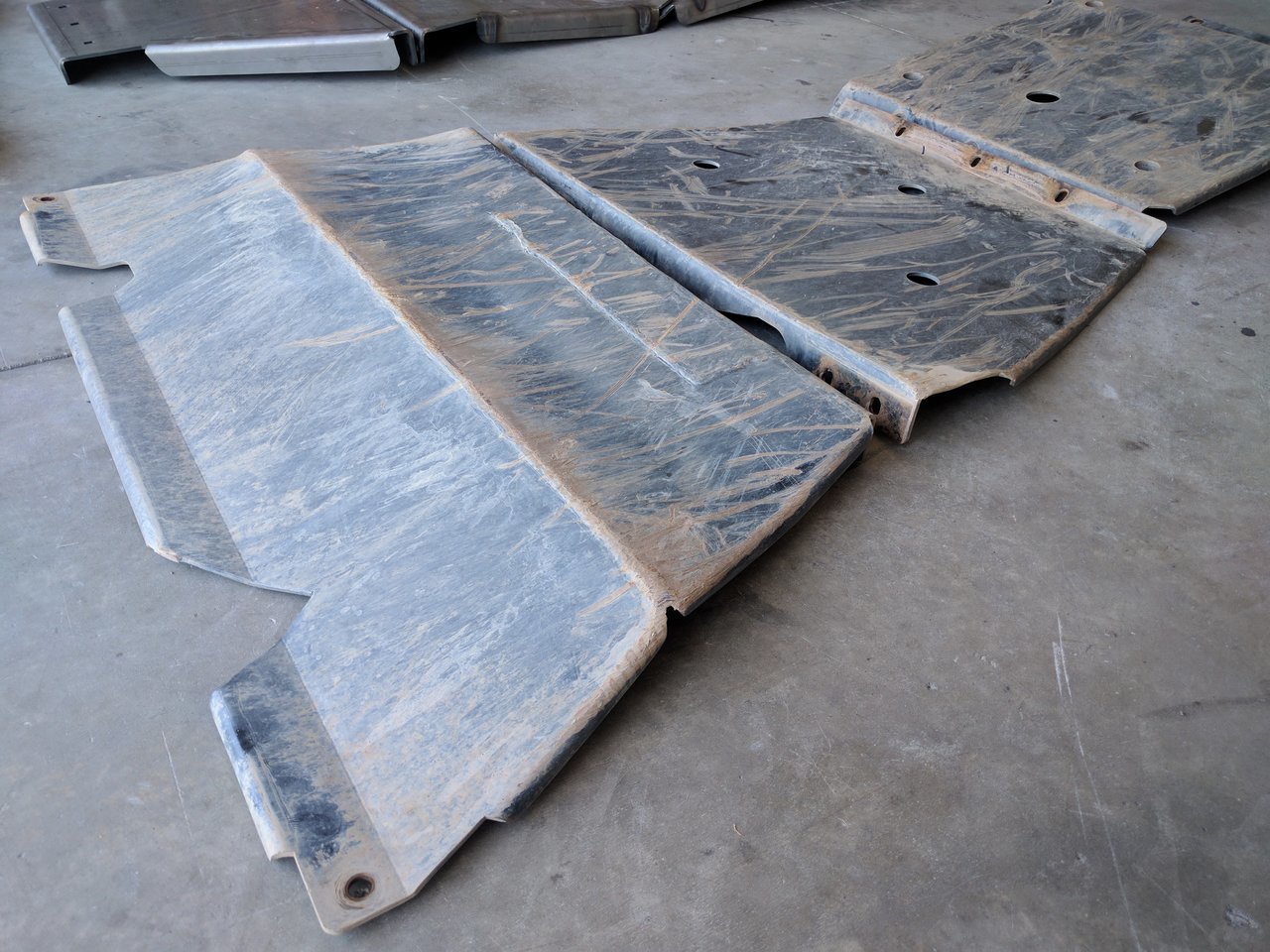

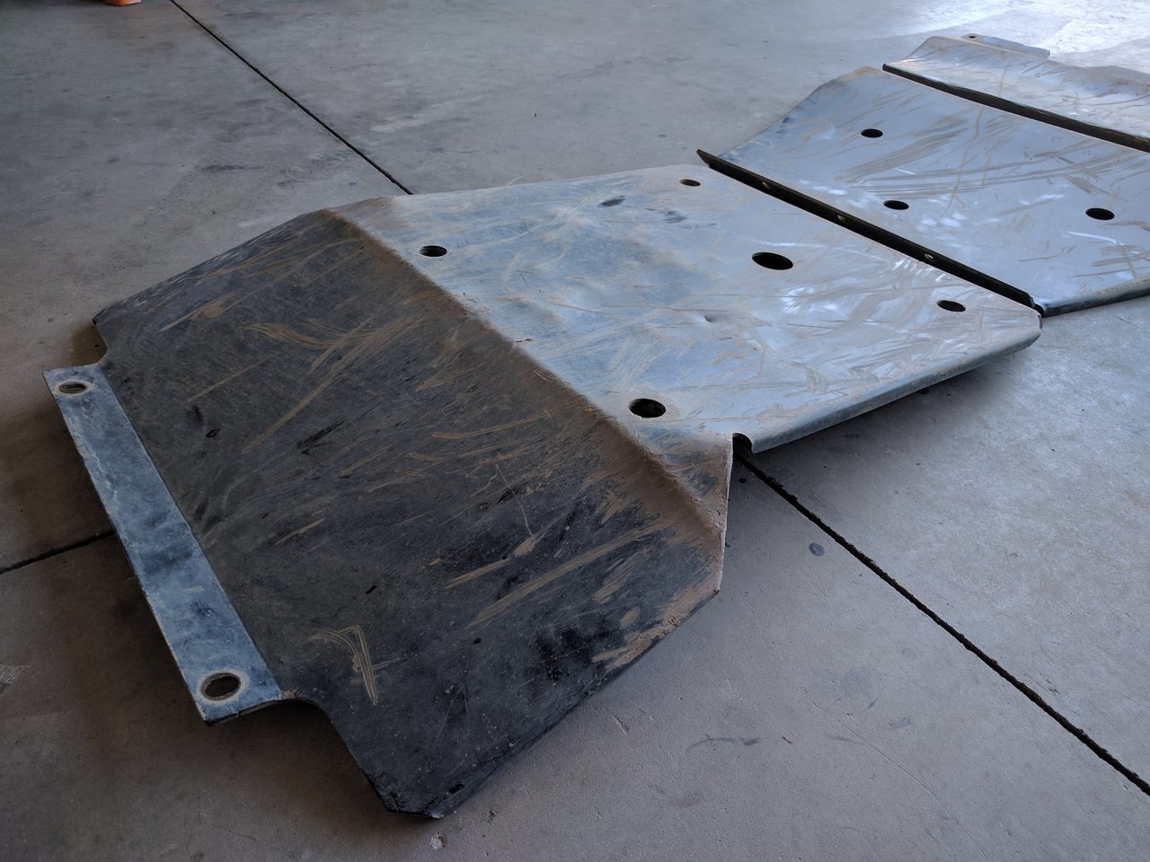

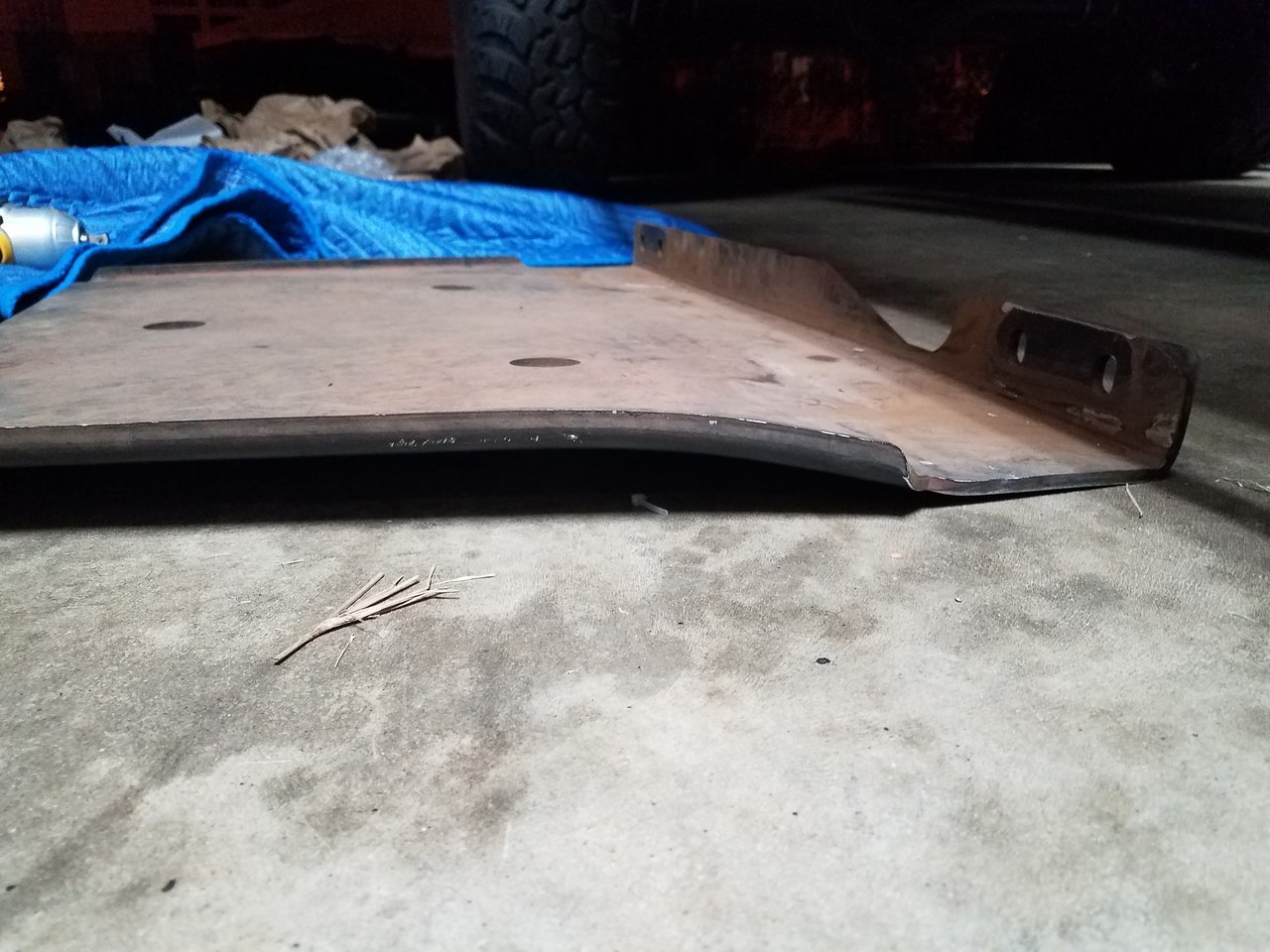

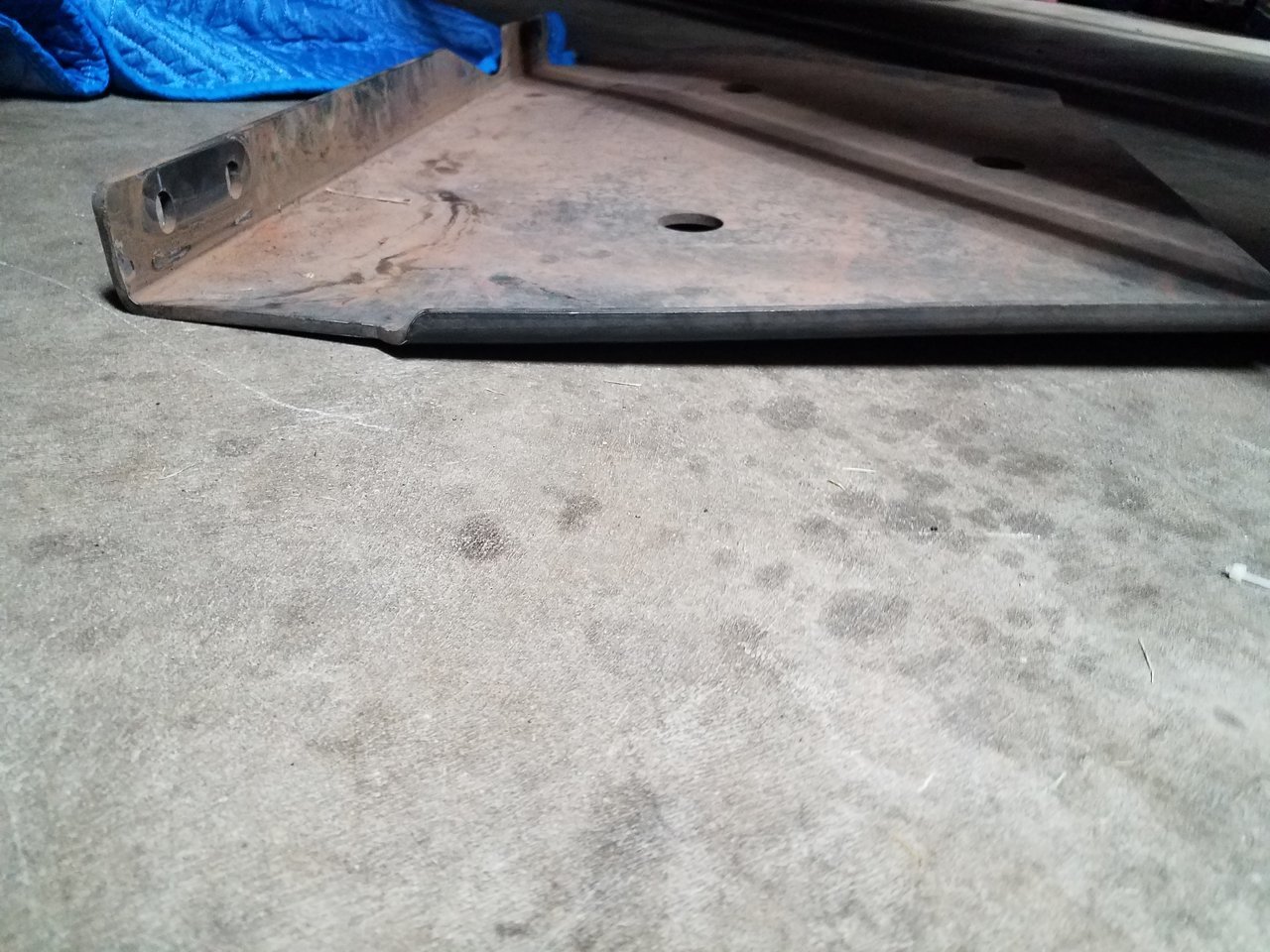

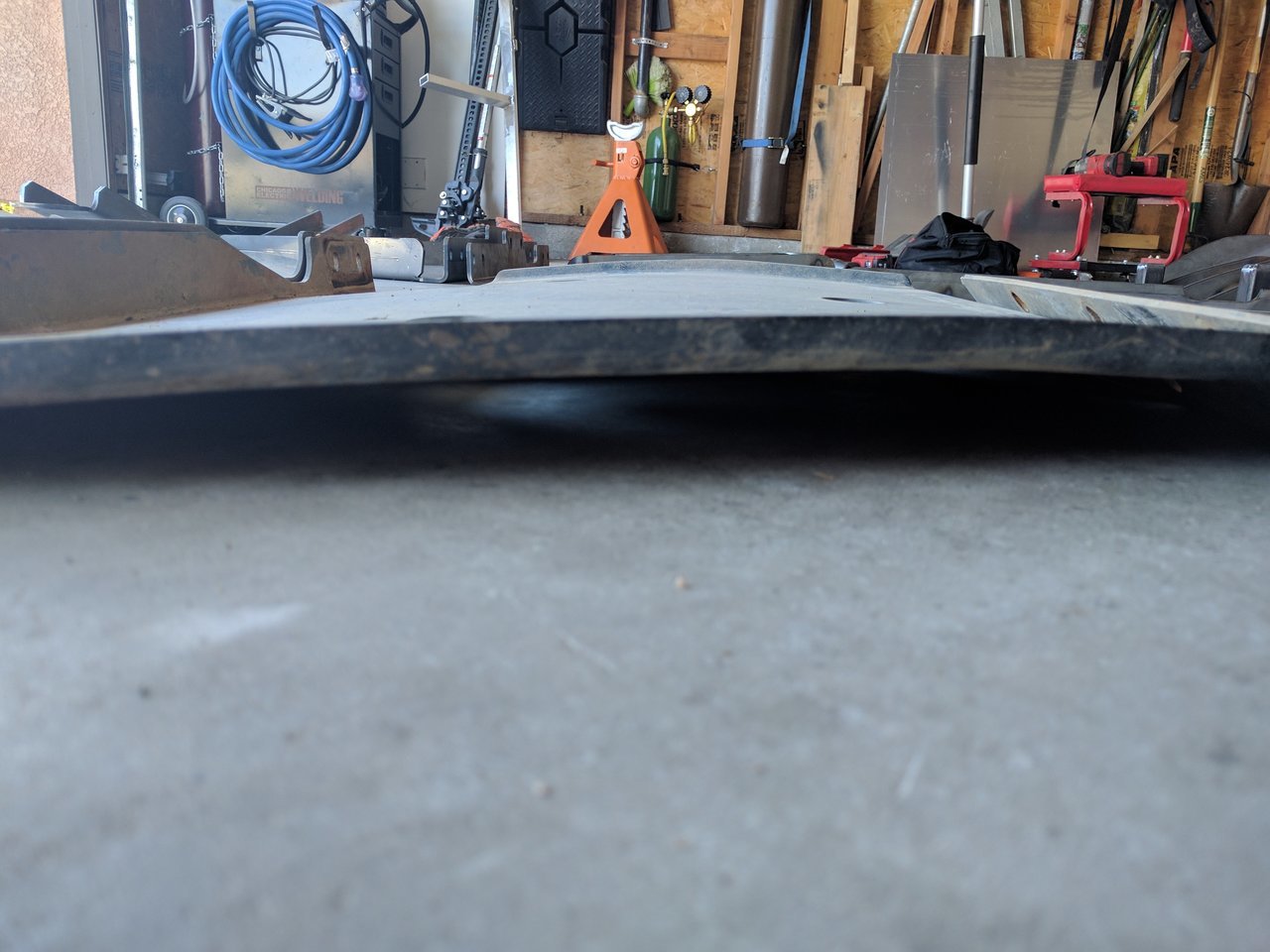

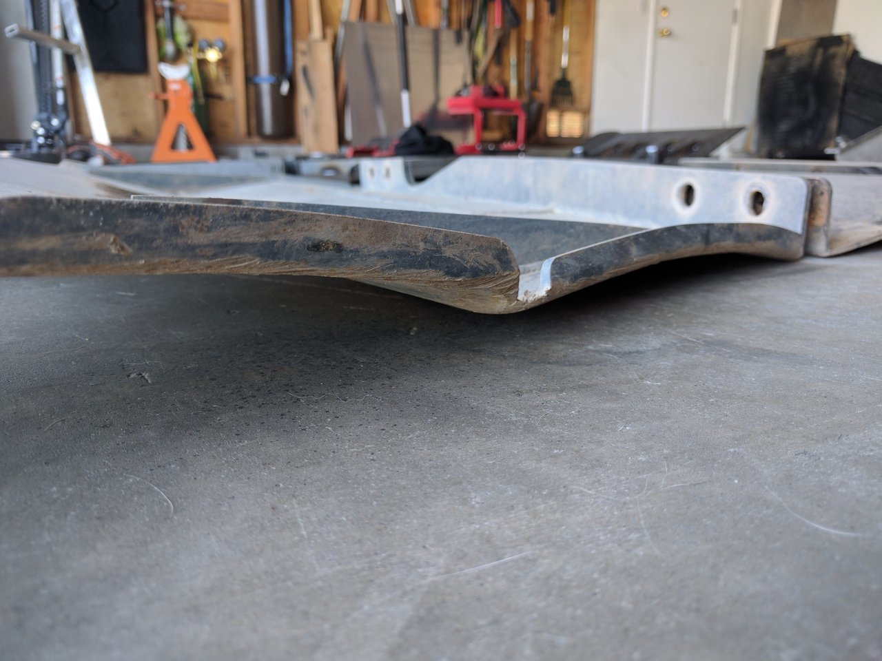

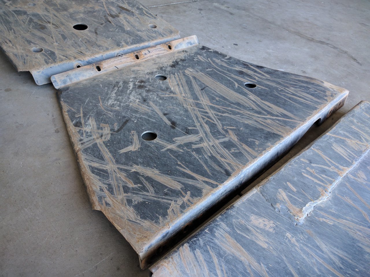

    I swapped my 3/16" skids to 1/4". Those 3/16" just aren't capable of handling anything harder than the occasional rutted out/rocky sections on fire roads.

    MIne's even worse because aluminum. :anonymous:

    @tetten Mine are nowhere even close to being mangled like yours. I mean mine is worse than 3/16 steel because they're aluminum. At the time I bought them, I thought it would be enough. My IFS skid is fine, it's just the mid skid that's getting out of shape because that's usually where all the weight of my truck goes when it gets high centered. I'm thinking about ordering just a steel mid skid to replace it. It worries me because my new y-pipe is only about 1/2" away from it after I bent it back into shape. Wouldn't take much to bend it and make it touch the pipe.
