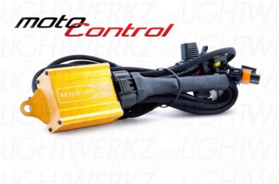

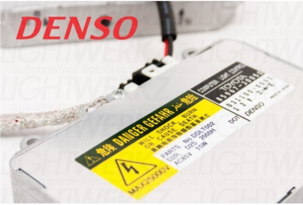

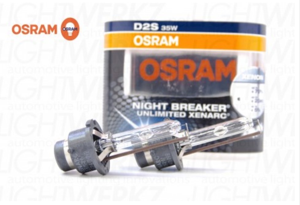

    After some intermittent non-firing ballasts, I figured to just upgrade to OEM HID headlight stuff. Even though TRS has a good warranty on all their stuff, it's such a hassle to remove and replace and go through the whole warranty procedure.

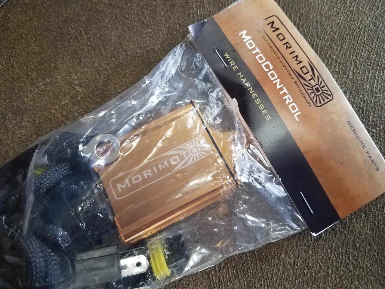

    Got some waterproofed Denso Toyota ballasts, Osram Nightbreaker oem bulbs, and a new harness (because why not everything else will be new)

    What did you get? Those Osram Nightbreaker 66240 bulbs were the brightest bulb in a shootout on Hidplanet. A little brighter than the Osram CBI bulbs I had. The new Nightbreakers are 4300k and the CBI's are 5500k. So not as white, but brighter.

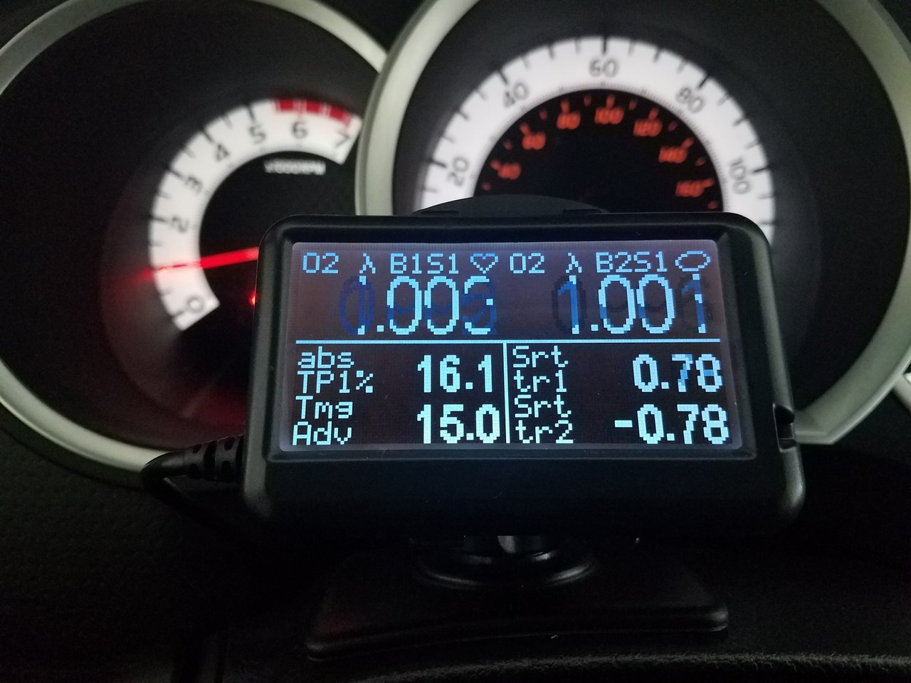

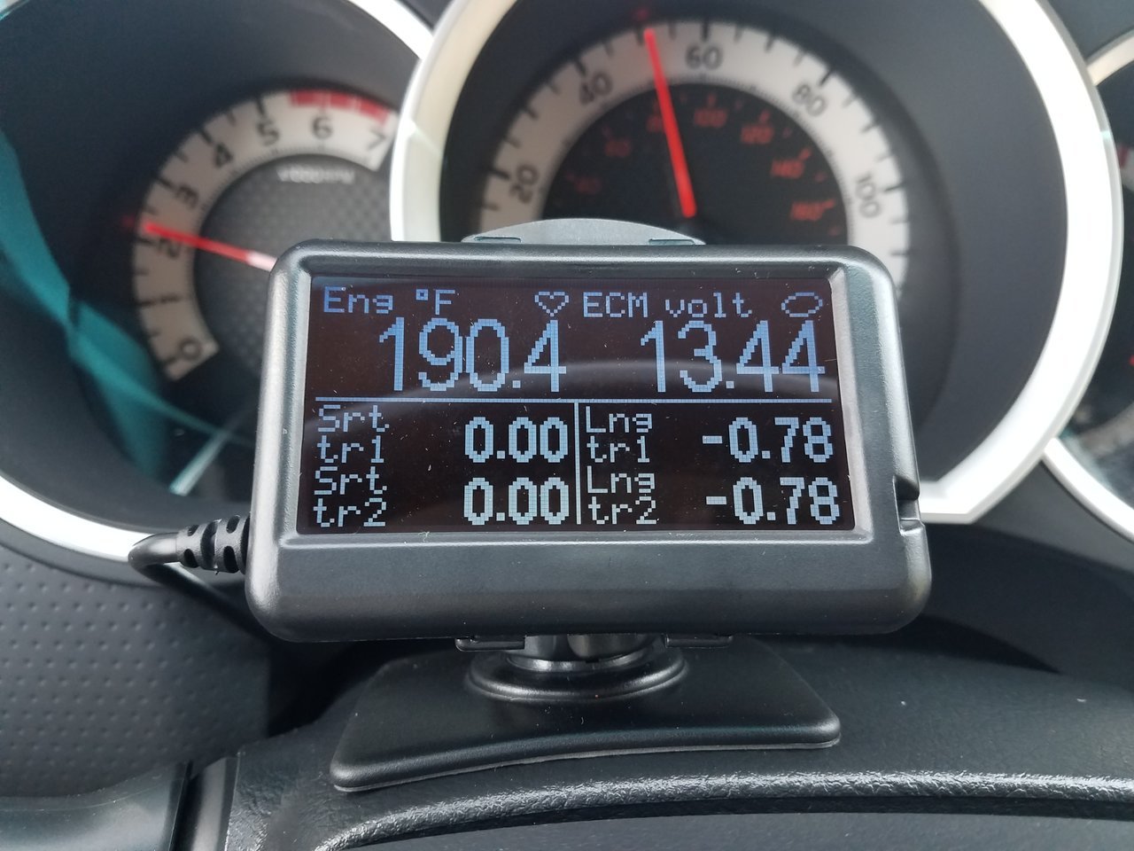

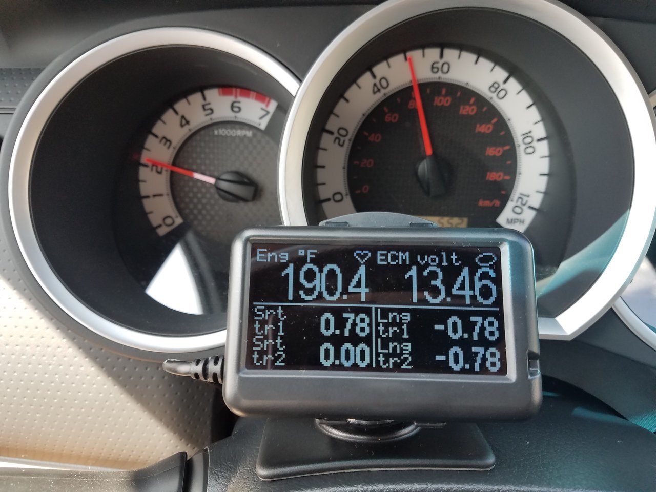

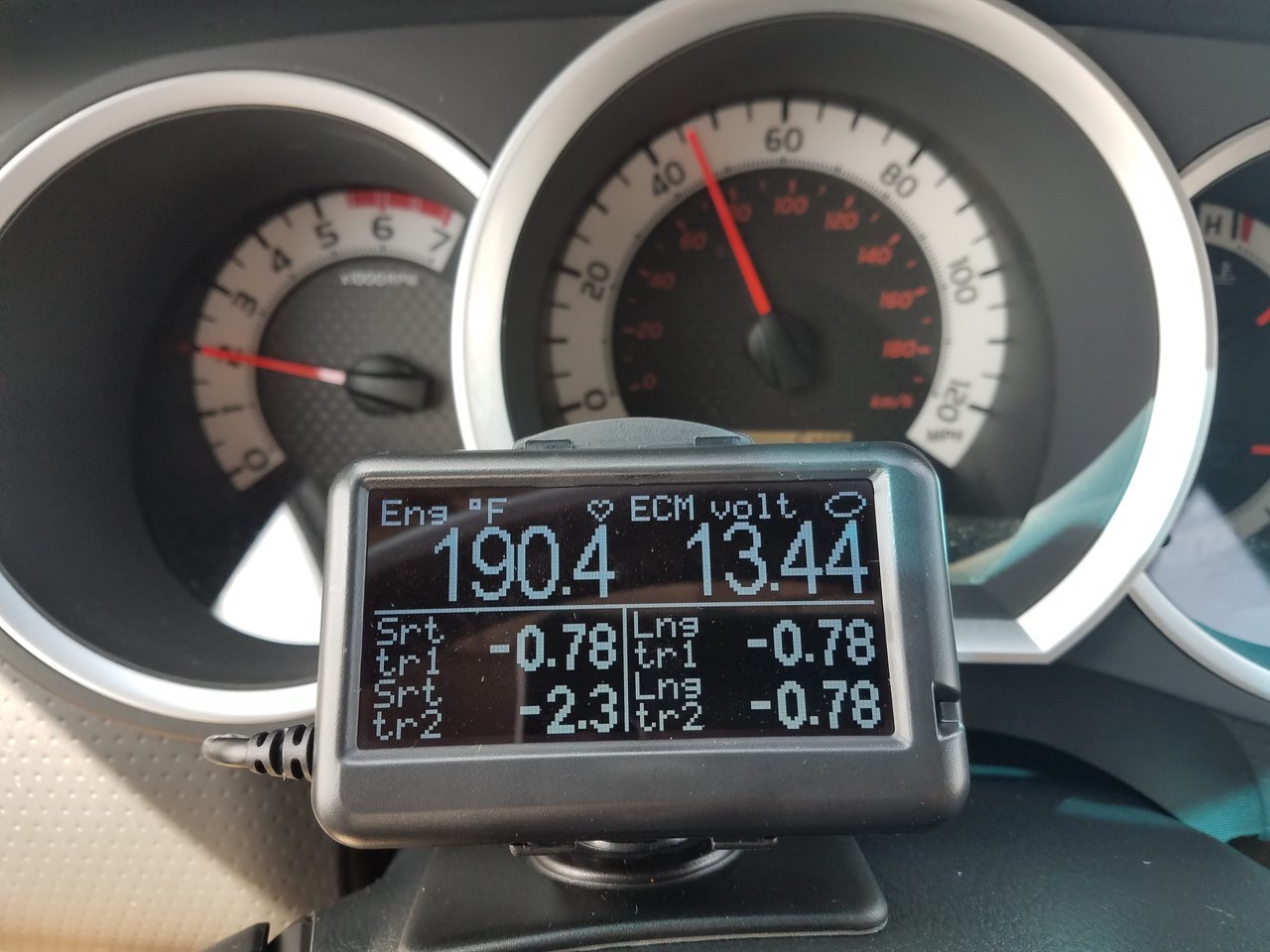

    I purchased an Ultragauge to monitor my fuel trims since I have added a Volant intake, manifold spacer, URD Y-pipe, and TRD cat back exhaust. These bolt-ons with no tuning had me wondering. I also had an Ecoblock MAF spacer that I un-installed until I could verify what it was doing as far as manipulating the air/fuel.
    Without the Ecoblock, long term fuel trims were about -9% to -11% and short term ft at about 3 to 6%. This would indicate a rich condition.
    I installed to Ecoblock maf spacer and ltft dropped to almost perfect at -.78% and stft to about -2 to 2% (hovering around 0%) Zero trim means that the air/fuel ratio is good and the computer doesn't need to compensate and trim the fuel, and better drivability.
    So, it just so happens that with the combo of mods I currently have, the Ecoblock "tuned" the truck air/fuel to a way better range than without. These fuel trims were monitored at cruising speed and during acceleration, from about 1500 to 3600 RPMS.
    Couple shots of the UG while cruising and accelerating. I noticed that under heavy acceleration, the stft would indicate slightly richer at -2.3% which is fine with me, still good and better than indicating a lean condition.
    @Torspd Please correct me if I explained anything wrong.

    I had a chance to monitor the AF ratio while in open loop. The truck switches to open loop under wide open throttle and is no longer using the 02 sensors to hold the AF mixture. I did a few wot runs in 4th and 5th gear to make sure that the AF ratio is still safe in open loop with the Ecoblock maf spacer installed.
    The Ultra gauge reads the wideband o2 sensors and outputs lambda, 1= stoic, (14.7)
    <1, rich
    >1, lean
    You get the AF ratio by 14.7xLambda
    The AF ratio was pretty spot on, at about 12.5 from 3000 rpms and richens out to 11.95 close to redline. I did some digging and you would want about 12.1 at WOT for a NA 1grfe.
    So, the Ecoblock spacer will stay installed.
    I put the lambda outputs at the top of this page on the UG to monitor these runs.

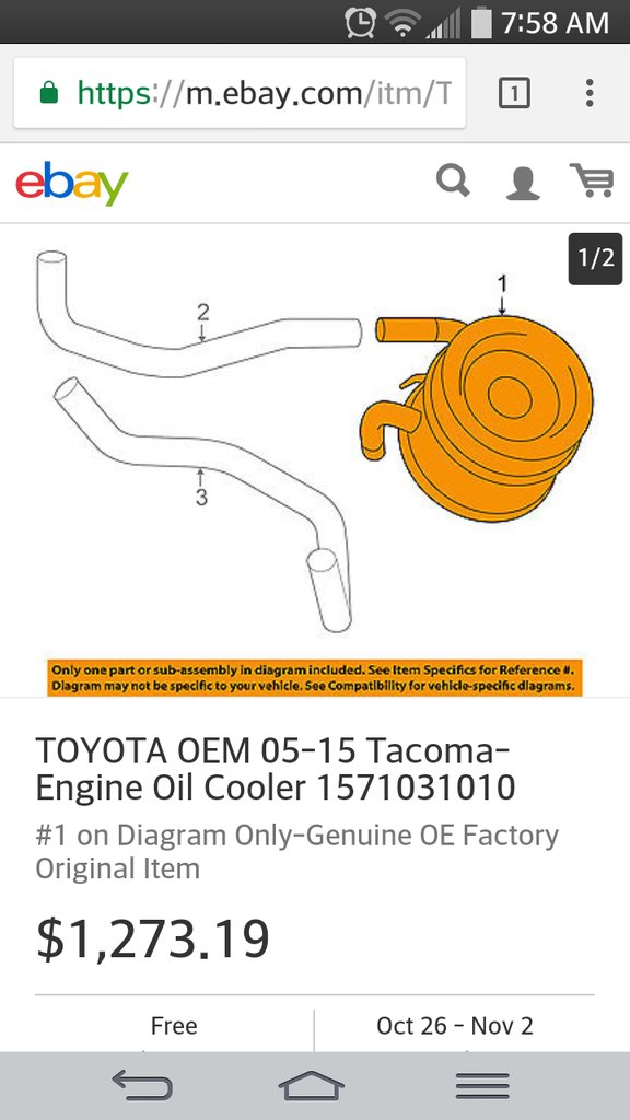

    Coolant will cool down with the radiator. Engine oil has no cooler....gonna add one? :D

    No, that engine oil temp is normal. Just nobody knows what theirs is. We do have an oil cooler.

    Only tow package trucks have it.

    Damn that's expensive. For that price you would think it would be way better!

    Right! At least have cooling fins

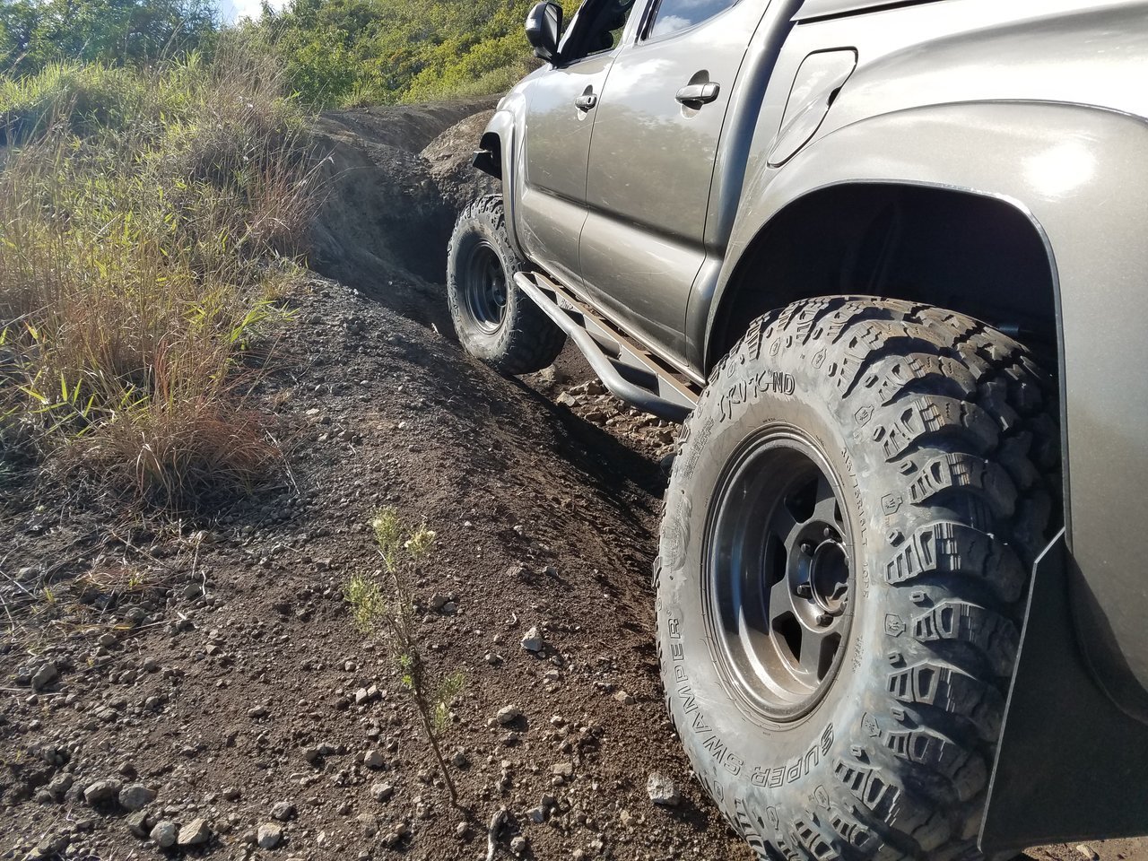

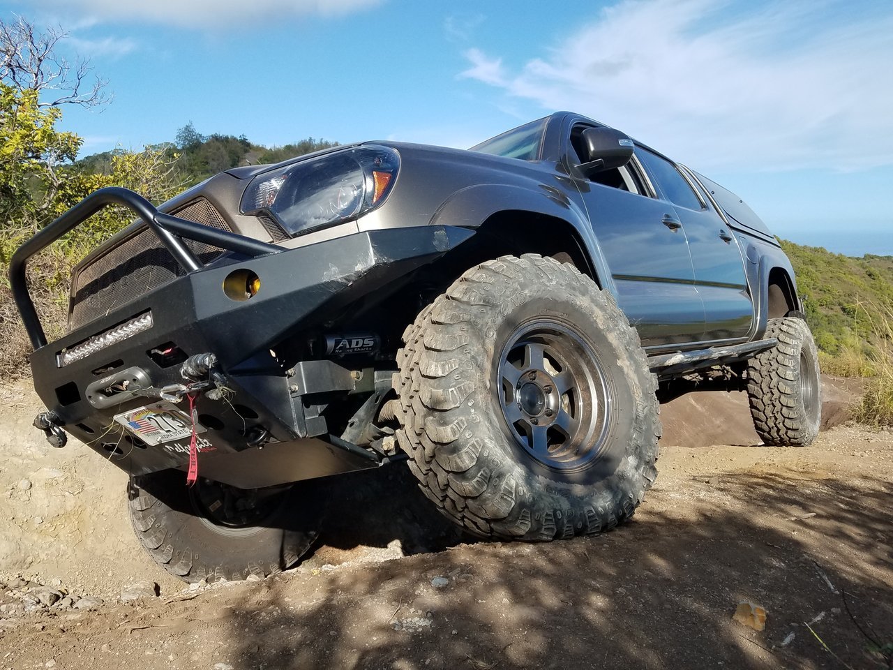

    Photo dump from the last quick run:
