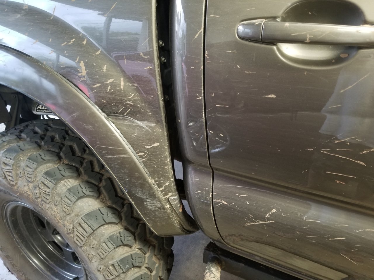

  7. May 27, 2018 at 11:32 PM

  8. May 27, 2018 at 11:37 PM

    Minor. Did you guys go down slip and slide?

    No, just donkey. The dents are from a wrong trail we took that was going to jeep eater.
