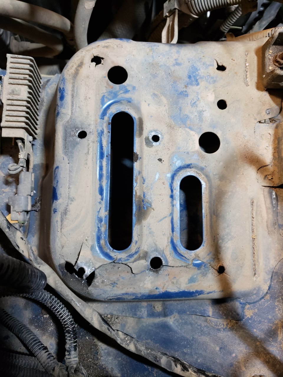

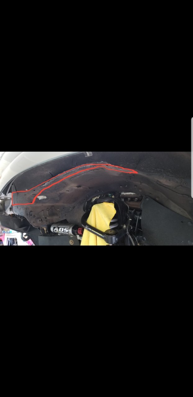

    Did you have to limit your front travel at the bump stops for 37s? I rub in 3 or 4 places along the top of the fender well during full compression with 35s, so I don't see how I can fit 37s without tubbing or a body lift.
    Been wanting 37s for my next tires for a while (especially with a dclb) but can't afford to regear yet, so i continue to plan ahead haha

    I relocated my battery to my bed and cut my windshield washer resi down so I could tub the top of the fenders. I had to cut out about an inch of the top and almost 2" toward the front top of the fenders.

    Something like this. You will need to tub the tops and firewall portions of the fenders with 37's.

    That's great! Thanks so much for the picture. More or less what I expected, and where I rub with 35s. I am actually in the process of relocating my batteries to behind the rear seat currently, so they will be out of the way when the time comes. My batteries were moving excessively. Pulled them out to find this, along with a couple big cracks in the fender well too

    good catch. looks like that puppy was about to fall off in a couple of months.

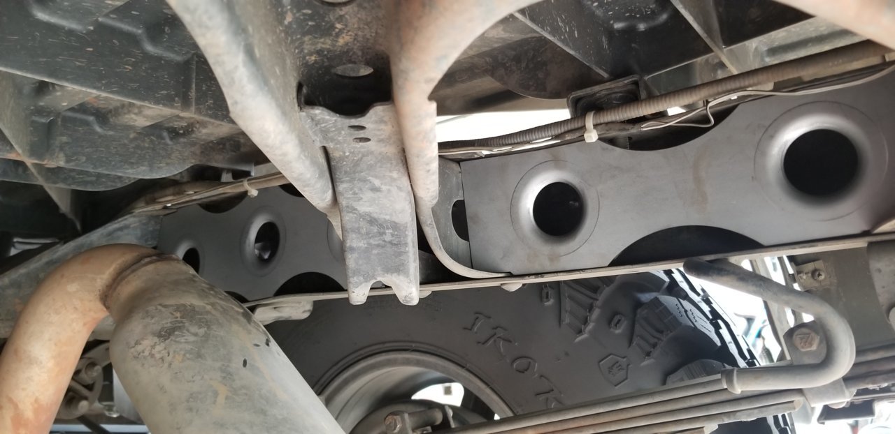

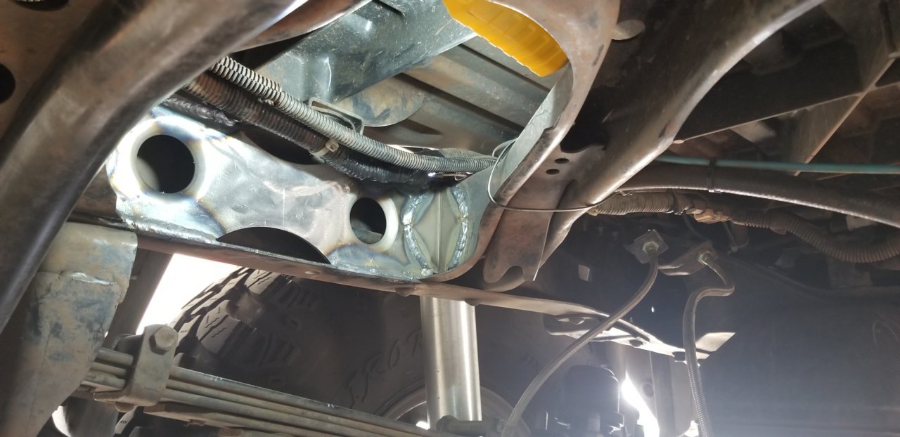

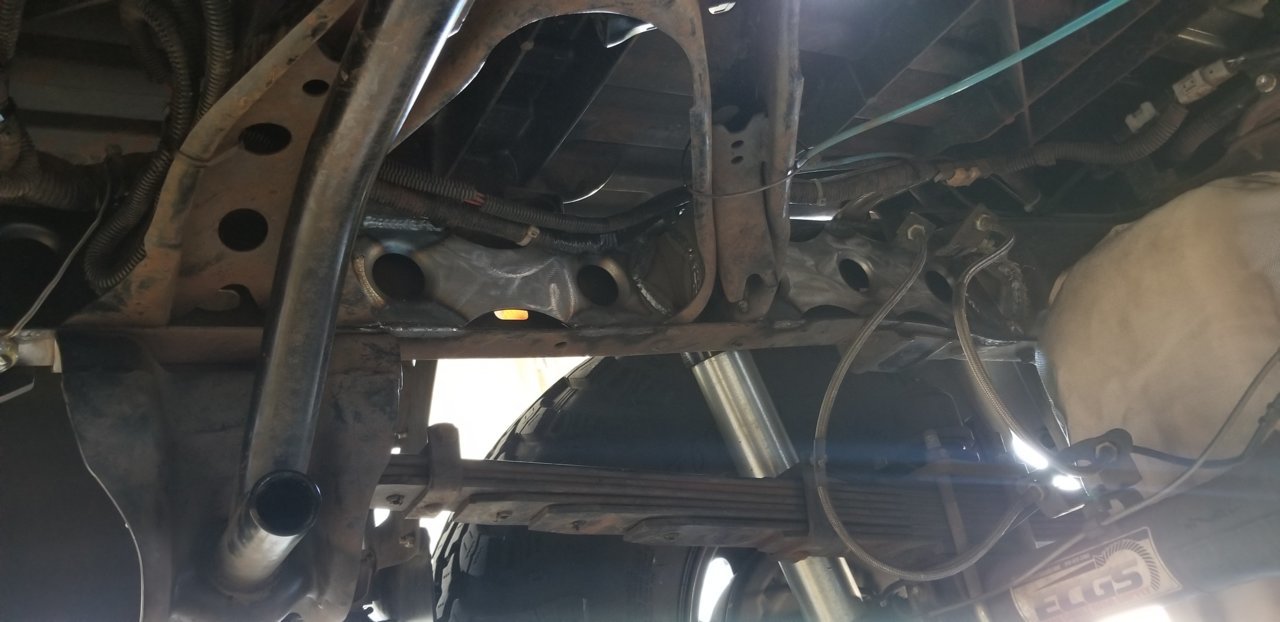

    Got the rear "C" frame boxed in.
