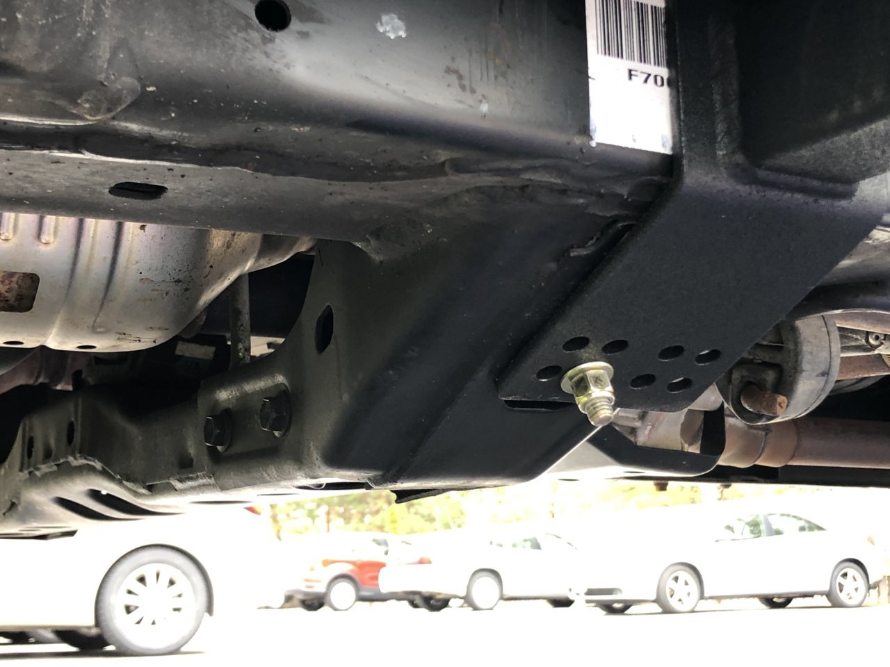

    2015 Black Tacoma TRD Off Road
    Added my @Mobtown Offroad bolt on sliders. These things are beefy AF. Install took maybe 4 hours. Seemed easy enough and it really was. Could have taken an hour total if some of the bolts weren’t so hard to get too. I will add a few more pics later.
    *edit fixed!

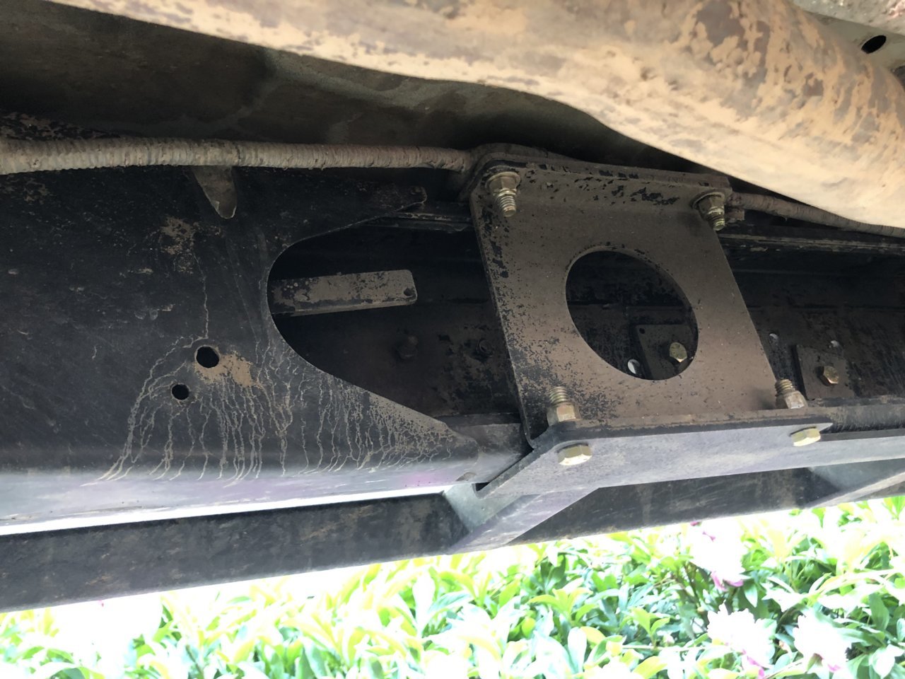

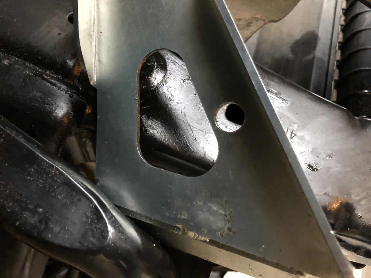

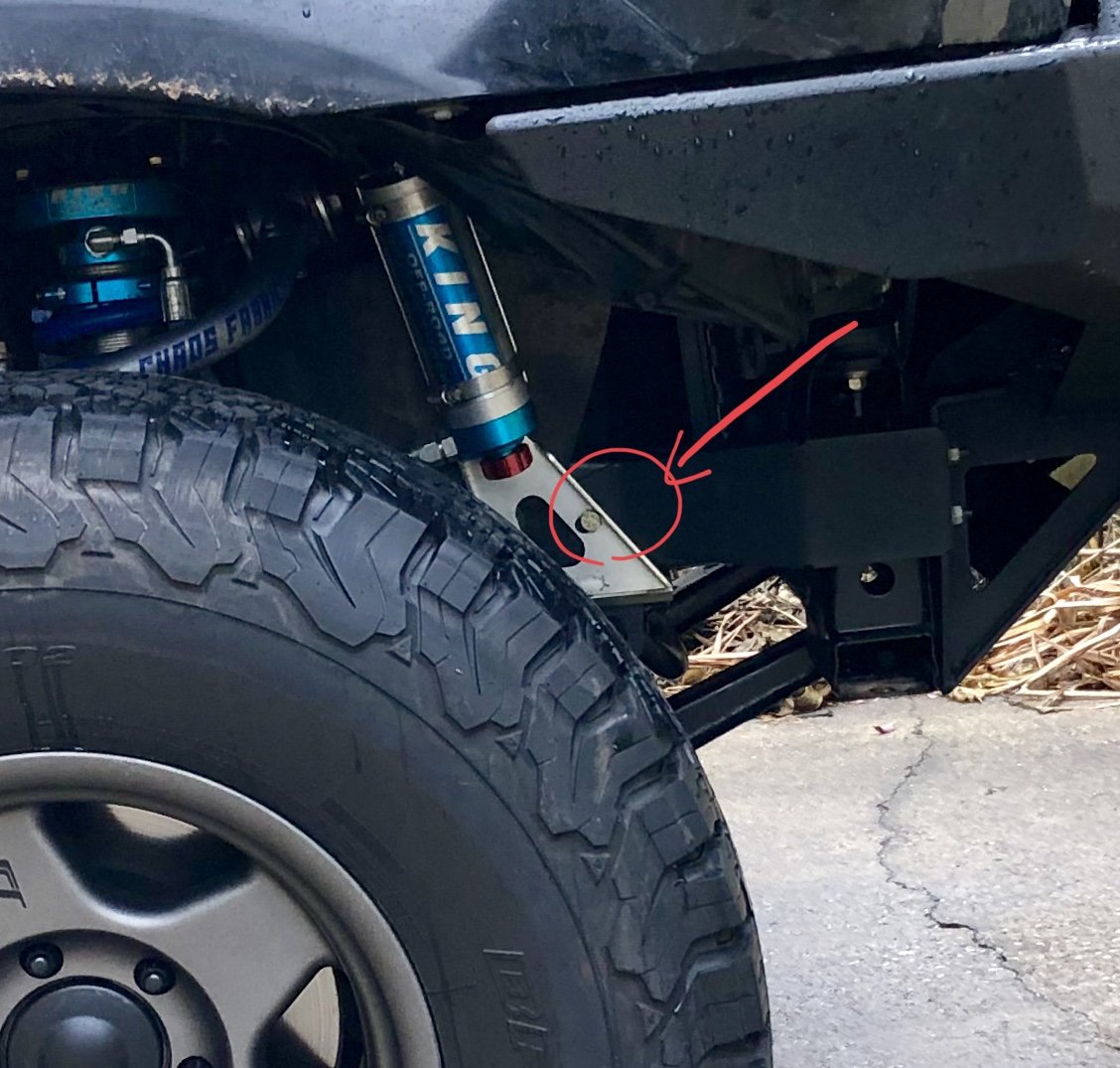

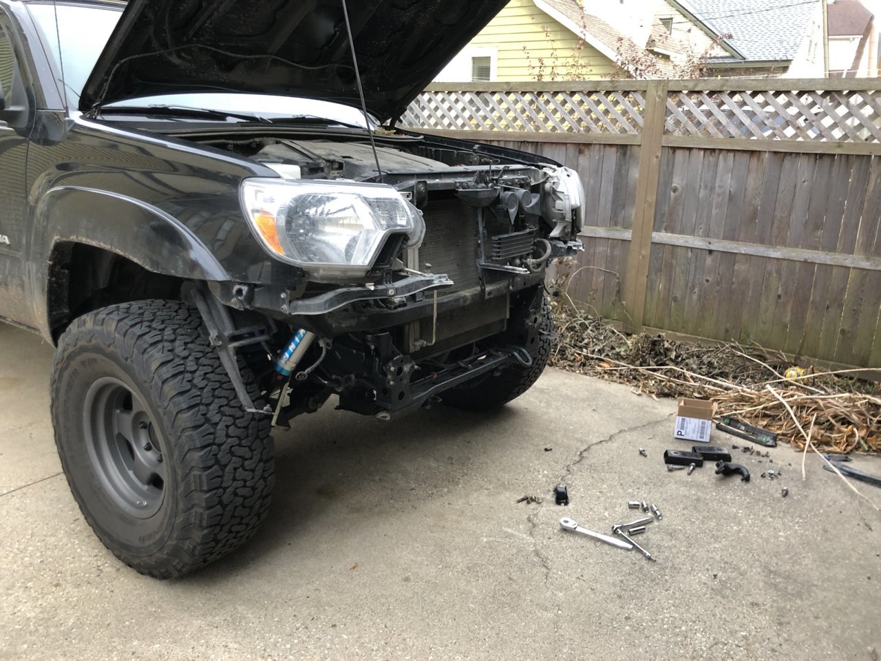

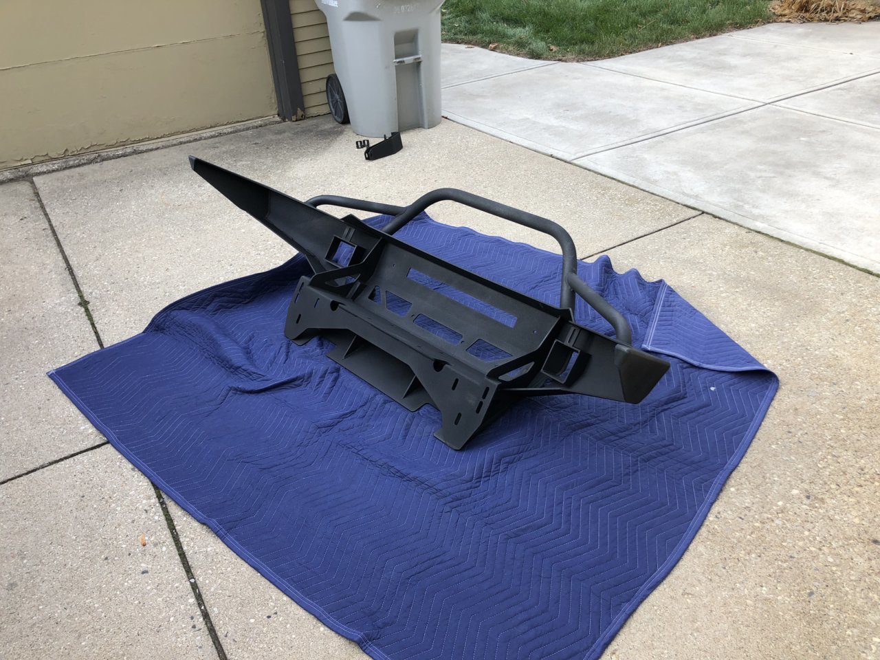

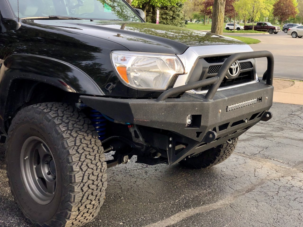

    @At The Helm steel custom height single hoop steel plate front bumper installed a few months ago. This thing looks amazing. Install was super easy. Took longer to take the old bumper off I think.
    Morgan’s bumper has these really awesome frame tie ins that need to be modified if you are running reservoir coil overs. Like my awesome King Coilovers :cool:. So I just drilled out a hole for the mounting bolt with a step bit. Easy as pie.

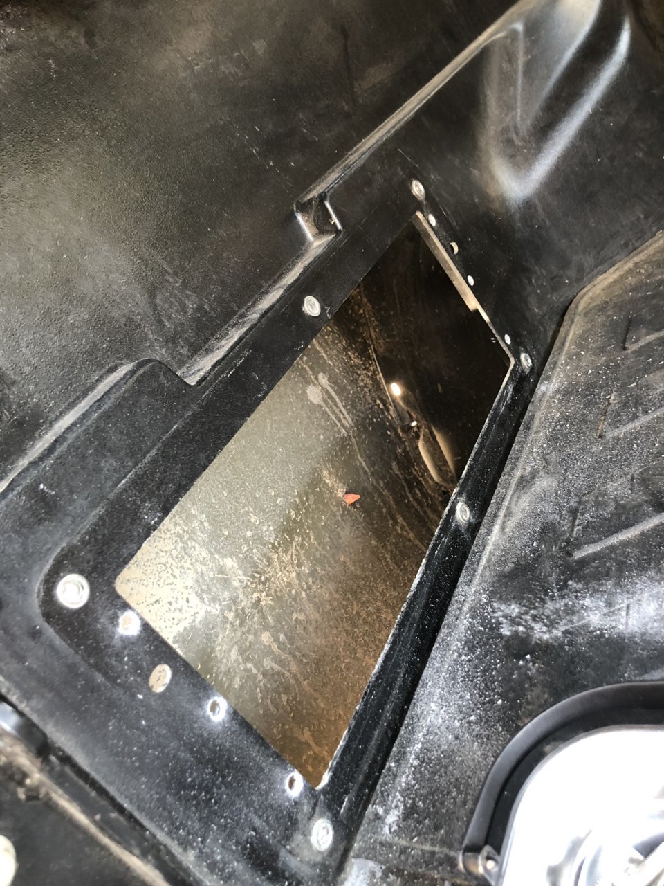

    Added this little Mictuning USB A, USB C, voltmeter to the factor lighter plug location. I’ll be damned if you don’t have to remove 2/3 of the friggin dash including the center console just to install it. Should have taken pics with her all torn apart. Also had to enlarge the hole slightly to fit it in. This thing charges fast!

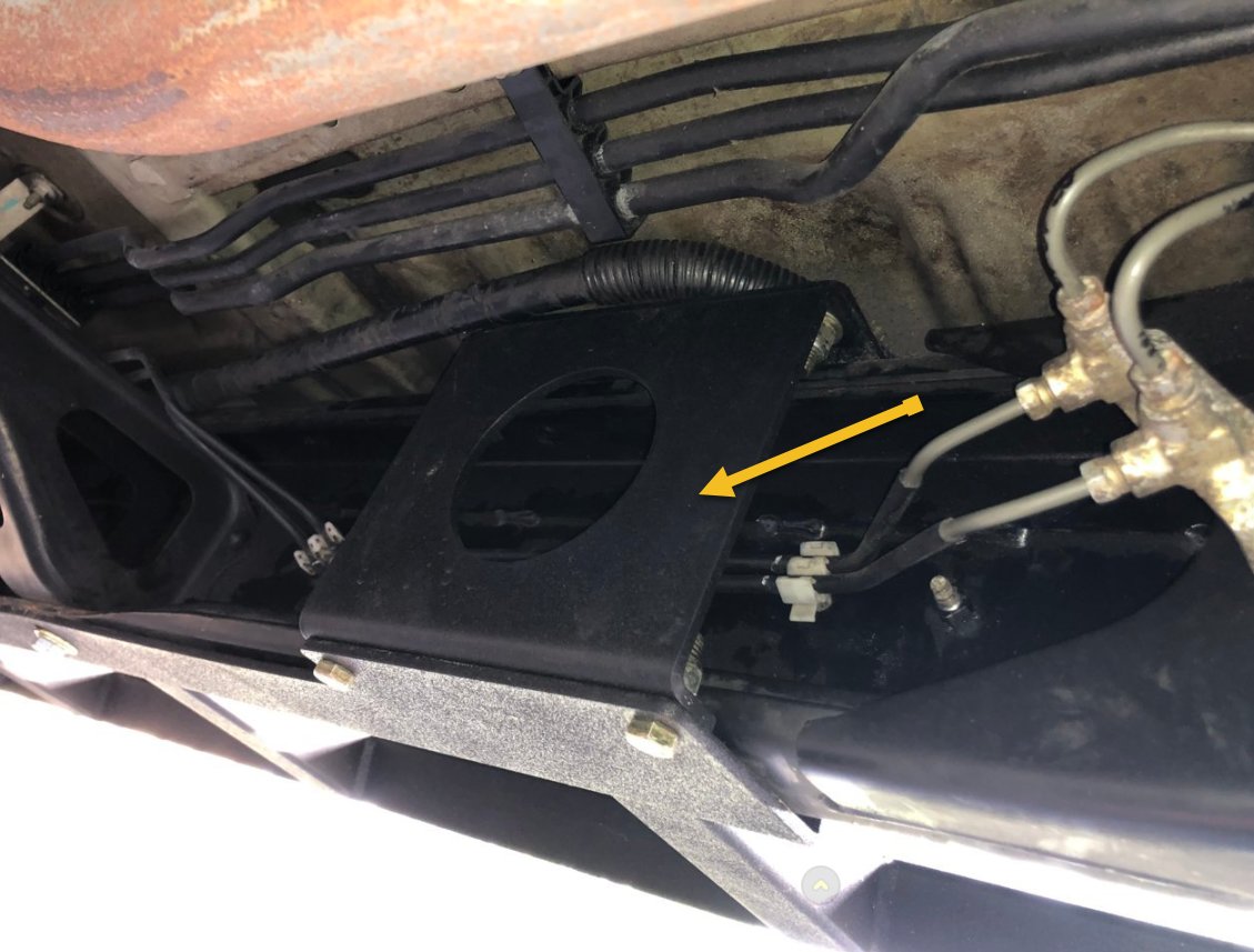

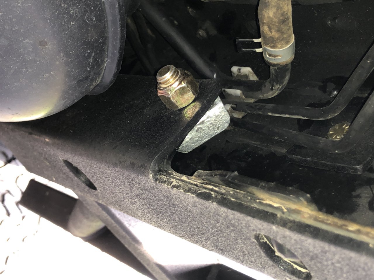

  8. May 21, 2019 at 9:49 AM
    #28
    jowybyo
    jowybyo Well-Known Member
    Nov 19, 2013
    #116863
    6,092
    Joe
    Baltimore, MD
    '14 MGM DCSB Postrunner 4wd Conversion, Debadged
    Nice work. One thing. You have this part backward.
    It's probably not a big deal, but it's intended to go with the tall flat face against the frame.

  9. May 21, 2019 at 10:02 AM
    #29
    deekyn
    deekyn [OP] Well-Known Member
    Dec 23, 2015
    #172953
    1,762
    Dustin
    Yellowstone
    Dammit! That’s what I get for trying to follow the instructions on my phone :facepalm:

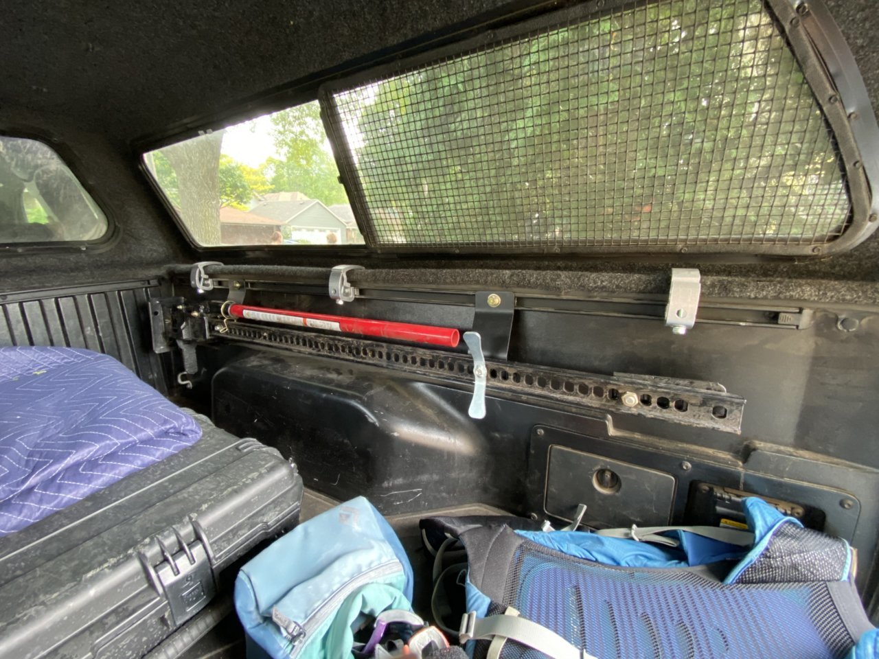

    Figured I’d have the shovel and hi lift mounted most of the summer but I want to at least deter people from stealing the hi lift. Of course if someone wants to steal them it wouldn’t be too hard. The front runner mount suggests a TSA type wire lock. The idea of that thing banging around then freezing up because they aren’t weather sealed felt like a hassle.
    A pair of m10 security bolts from Amazon seems like the answer.
    https://www.amazon.com/gp/aw/d/B01N7FH5SF?psc=1&ref=ppx_pop_mob_b_asin_title
    *** moved my Hi-lift to the bed with an RCI bed rail mount.

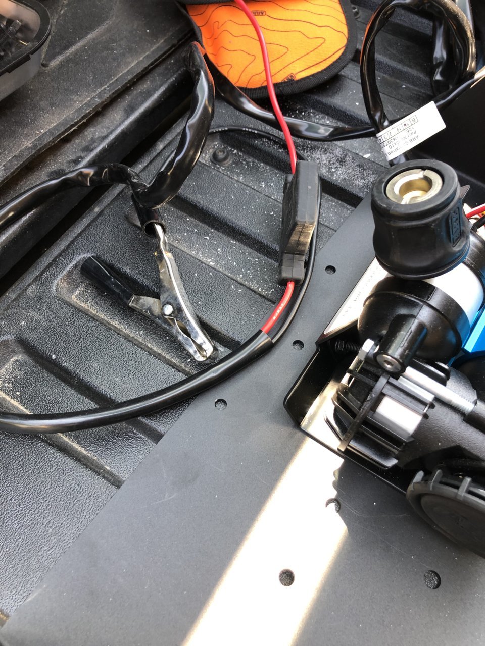

    ARB (CKMP12) portable single compressor, mounted in an Expedition Essentials bedside compressor mount, hardwired
    Wife bought me an ARB (CKMP12) 12V High Performance Portable Air Compressor for our June Moab trip. But I always wanted it mounted in the bed cubby. So this weekend I did it. Ordered an Expedition Essentials bedside compressor mount and mounted it up this weekend.
    this was the portable compressor. So I drilled out the rivets holding the compressor to its toolbox. Then drilled hole into the bedside compressor mount to mount the compressor. Mounted it it sideways to fit the hose in the box as well after some trial and error.
    Then I cut the battery terminal clips from the wiring and sliced some 10 ga AWG wire to it and ring terminals to the end, keeping ARB’s inline 40amp fuse and leaving the switch mounted to the compressor. I wrapped the two wires in 3/8” split wire loom and ran it from the bedside cubby, along the frame following other OEM wiring, into the engine bay.
    So now the compressor is mounted in the cubby with its switch and the hose, and hard wired to the battery.
