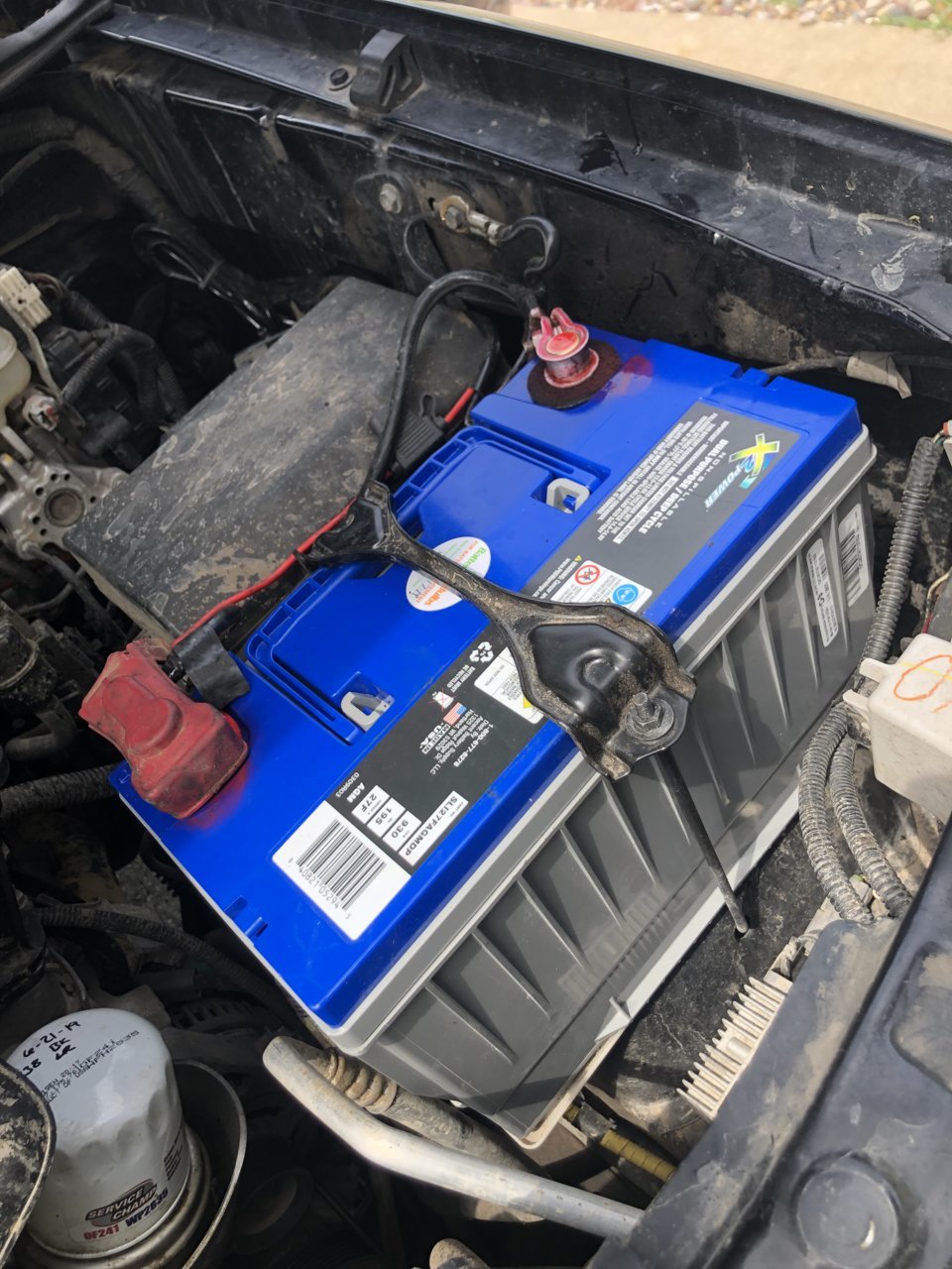

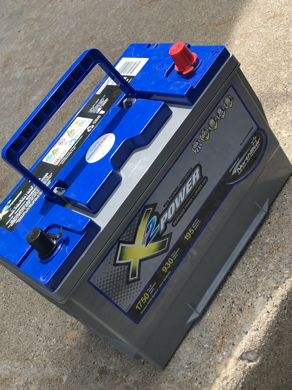

    X2POWER Premium AGM group 27f battery
    Battery gave out at 2 years (~105k) miles. Seems a little early to me. But I’m well out of any type of mileage warranty. So I wanted a new better battery. Preferably a deep cycle/ starter battery. Actually I wanted a daily battery kit. But that is for a mother time. So I ordered this X2POWER battery.
    Fit in the stock location with a little bending of the battery hold down bar.
    But what I realized after I installed the battery is that, because it’s an AGM battery, it actually needs to float charge 13.5-13.8V and cycle service 14.4 - 14.8V. In the paper work it says a lower charging voltage will greatly shorten the battery life. As such I have a voltage booster on order. I may look into an upgraded alternator or something later. But for now the $100 voltage booster will have to do.

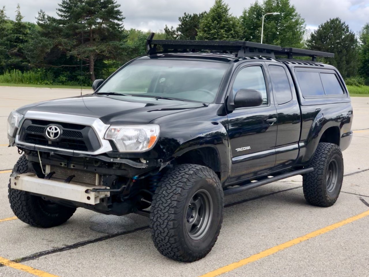

    Flare-less fenders
    Wheeling in Moab with my ~3” King/ Allpro Expo lift and 295/75r16 BFG KO2s I realized that all my trimming of the wheel well liner, fender and fender flare wasn’t enough. So I trimmed a little ore fender in Moab and took off my front flares for the rest of that trip. I really got to liking the Flareless look and began to research options and found this...
    https://www.tacomaworld.com/threads...the-fenders-after-removing-the-flares.304366/
    So that’s what I decided to do!
    But as I found out that manufacture tolerances mean that with DIY mods like this, what may work for a few people may not work for you.
    As it stands I pulled out the OEM flares, cut them with a dremel, sanded them. Then primed, painted, and clear coated them.
    They look great, but only fit loosely in the square holes. They need a rubber washer.

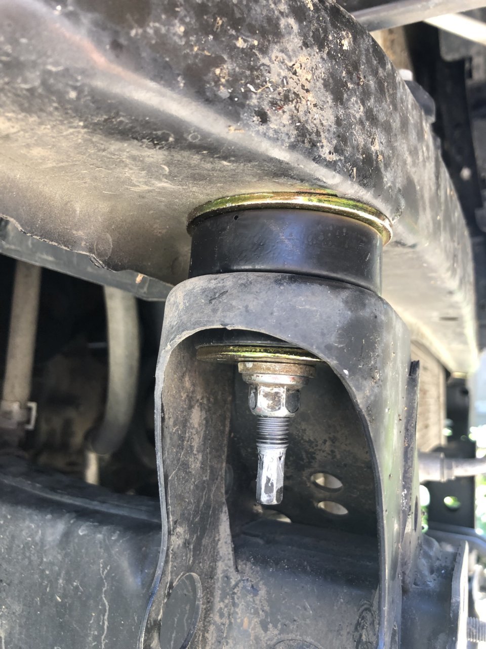

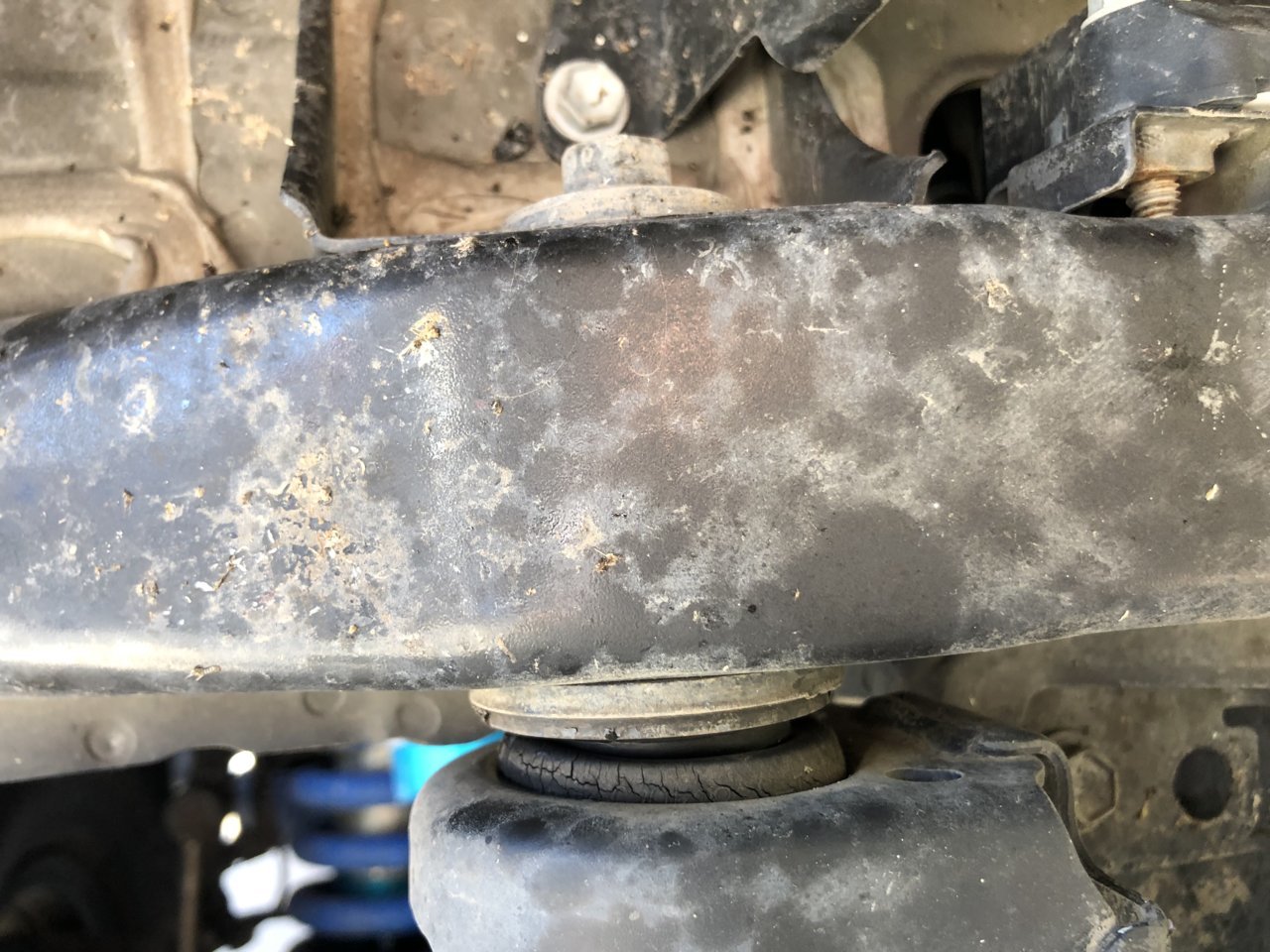

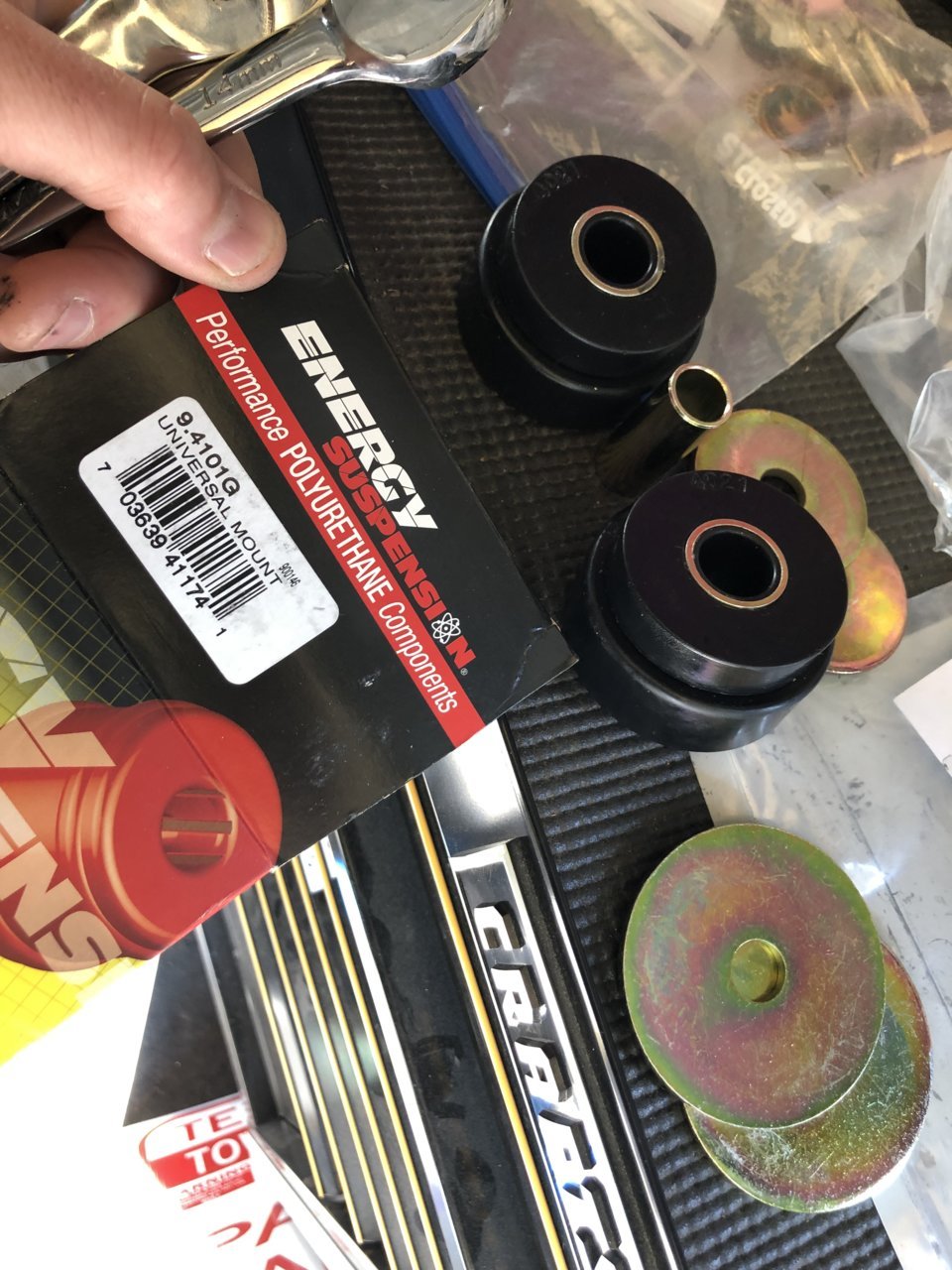

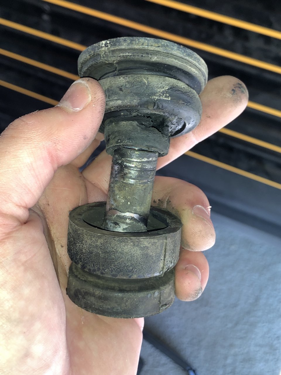

    Energy Suspension Radiator Support Polyurathane Bushings
    Since my bumper is off for painting I decide to replace my radiator support mount bushings. They definitely needed it.
    $28 Energy Suspension 9.4101G UNIVERSAL MOUNT
    https://www.amazon.com/gp/aw/d/B000CN9BZ0?psc=1&ref=ppx_pop_mob_b_asin_title
    https://www.tacomaworld.com/threads/polyurethane-radiator-support-mounts-cab-also.361346/
    One was super super easy. The other... something was warped (frame? Radiator support? Who the hell knows... ) Had to use a pry bar to get the damn bolt in :frusty:.
    None of my truck projects recently have gone as smoothly as they could have.
    ChadsPride and TrailYeti like this.

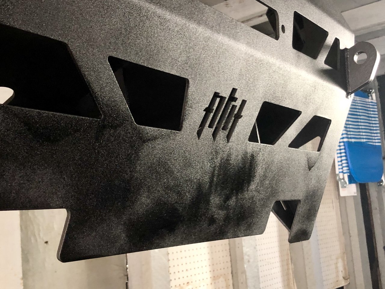

    At the Helm plate bumper sandblasting and spray painting
    (She looks so much better now! :yes:)
    After staring at the rust and the oxidation on my obviously shittly (locally) powder coated bumper had gotten in one single salt laden Wisconsin winter, I couldn’t take it any more. :frusty:
    Had the bumper sandblasted and was able to slap two coats of primer on the bumper same day. The truck lived without the bumper for like three weeks though cause I couldn’t get it just right. And it took a little time to figure out getting into all the nooks and crannies in the bumper.
    Turns out spray painting perfect even coats on the bumper was nearly impossible. So I had some wet sanding and recoating days to fix it.
    But in the end it turned out awesome!
    Used Rustoluem self etching primer. Rustoleum professional grade truck bed liner spray can, and a top coat of Krylon Colormaster matte black spray paint.

    Why did you mount the thick bushing on top rather than the smaller one? is that what it calls out...?

    No difference in ride or noise. Though my oems were both torn. The only difference is that the steel bumper sits a little lower/ slightly bigger gap between it and the body. But that’s ok. When I was wheeling on Moab, I did see that the bumper (before the bushing swap) got damn close to the body when the truck was parked sort of flexed out. Now it won’t.

    I have the bushings but still need to do the replacement. What method did you use to lift the frame away from the support mount? Thanks!

    It’s easiest when you have your bumpers off to swap them. Just loosen the nuts that hold the bushing. Place a 2x4 on your floor jack and lift right next to the bushing. One of my came out super easy like that. The other one... something was bent and I had to use a pry bar while jacking to get it out. If both go easy, it’s like a 10 minute job.

    Did you have to loosen the other cab mounts? Mine are "squished" and I'd rather fix it myself than make 2, 120mi round trips to a dealer for a warranty repair...

    I didn’t have to loosen anything else. Just did them one at a time. One swapped super easy, the other, I had to use a pry bar to convince the bolt to come out and go back in. Maybe something was bent along the line somewhere due to the failed bushings?
