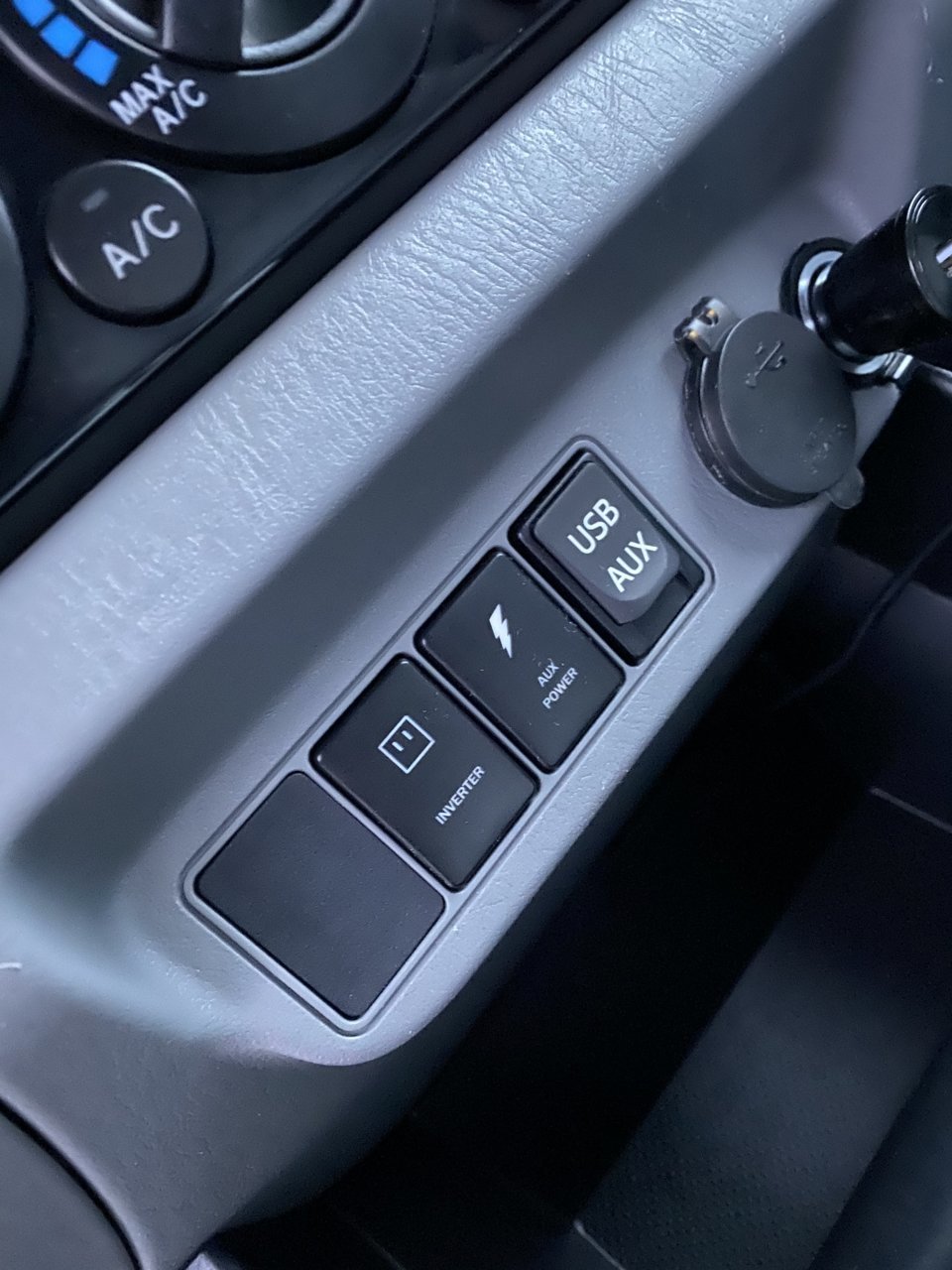

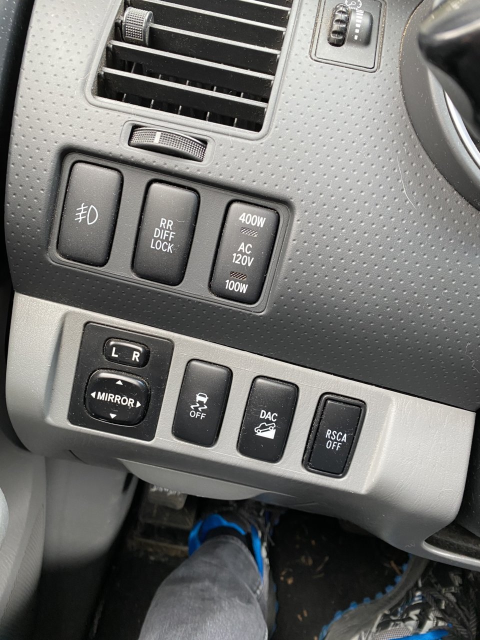

    Finally hooked up my SPOD that had been sitting around my house for months.Installing it in the engine bay way pretty straight forward on the mounting plate from PowerTrays.
    Here’s the SPOD:
    Mounting it was easy... but funny story. I disconnected the negative terminal of the battery like a good boy. Then when I was cleaning up wires from my old fog and light bar and disconnecting the mounting bolt that you attach the support arm of the PowerTray, I dropped my wrench with extension. It hit both terminals of the battery and arced. I wasn’t holding it thank god. Sparks flew and it ate a chunck out of my wrench. I found out later, because the positive terminal was still hooked up... when it arced it caused some sort of surge and a check engine code related to the accelerator. After a day of stress ensued waiting for the dealership to tell me I needed a new ECU or something... nothing. The code cleared on its own. Everything works fine now and the dealership did not charge me at all to look at my truck. Makes me want to figure out a rubber cap for the negative terminal when I work in the engine bay in the future...
    Anyways...
    A few months ago, I had installed a new rubber grommet in the firewall to put the SPOD wiring through.
    https://www.tacomaworld.com/threads/wires-through-the-firewall-the-right-way.531829/
    While I was installing the SPOD, I also wanted to get my switches sorted out and my 2WD Lo module installed. Super easy to install, just remove the glove box, plug and play.
    Wiring the switches was a little more work. The SPOD wiring doesn’t match the AironBoard switches I use exactly (I hate the spod rocker switches, and wanted the truck to look more stock.
    I always wondered why the inverter and fog light buttons were left of the steering wheel while the ATRAC button was in the center console. Why one traction button all by itself? Drove me nuts. So I moved my Rear Locker Button and removed the fog light and inverter switches. This gave me space to move the ATRAC button to an AironBoard “traction” switch and add the 2WD LO switch
    Went from this:
    To this:
    The switches are all lit when the dash lights are on. The ATRAC and 2wd LO are up and running. As for accessories,
    at the moment I only have Baja Designs fogs and Cali Raised 20” light bar actually wired up. I plan to hard wire the cigarette lighters to the SPOD and have them be able to be always hot with a switch. I also will am planning to add lights on my rear bumper and lights on the roof rack. I was intending to just have the inverter be on an AironBoard switch but I don’t know if it’s possible, so for now it’s disconnected.
    this project took two full days and lots of planning and learning. Electrical work makes me nervous, and I wanted it all to be clean. So there are tidy wire bundles in looms and zip ties and so on so that’s it’s clean and organized under the dash and center console.

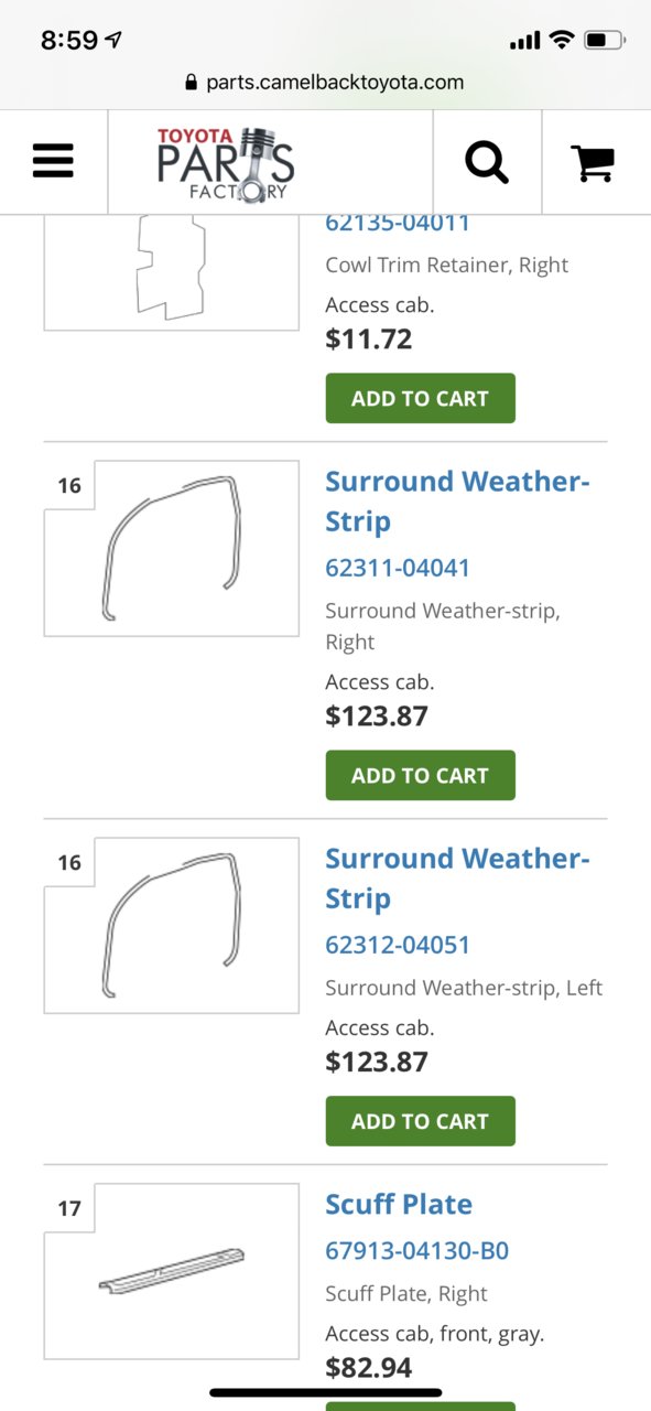

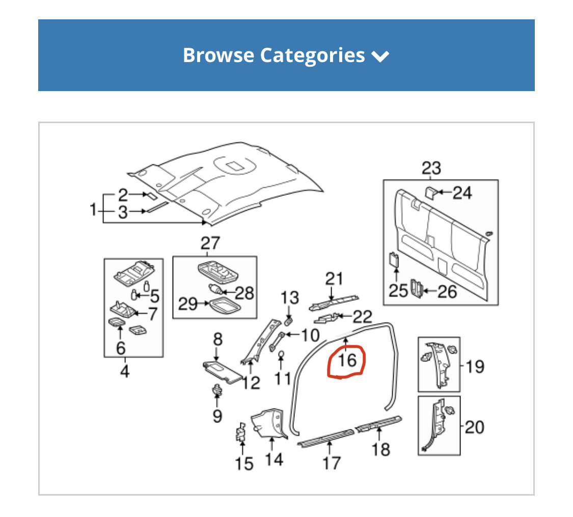

    I was one of those with a weather stripping TSB if under 20k miles (I wasn’t). I had the howling wind kazoo noise over 65mph on windy days. As bad was the “clicking” noise right by my head, from the rubber sticking together and unsticking. Sticking unsticking. That shit was relentless. Tried flexible tubing. Tried dielectric Grease. Tried silicon spray. Finally just replaced it today.
    Fucking A what a difference.

    Yeah. They have a paint mark that you line up with a bump on the surround. Just press it in a little bit at a time. Easy. All you have to take off is the bottom little plastic sills and the quarter panel. No tools. Maybe 20 minutes for one side. 10 for the other once you got it figured out. Worth the $250 for sure. I didn’t realize how loud that had all gotten. It’s like a dream riding in my truck right now

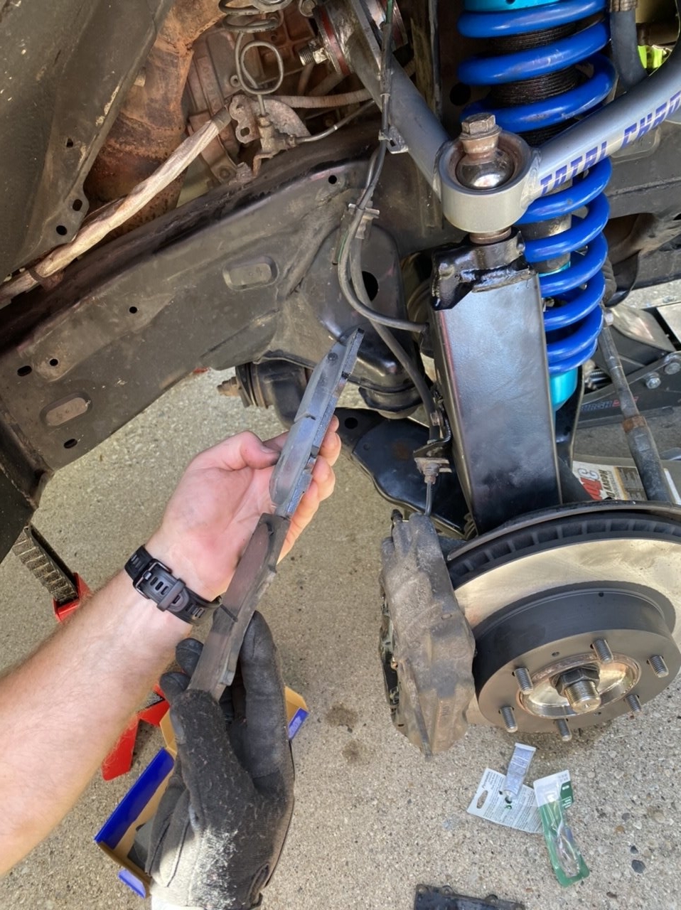

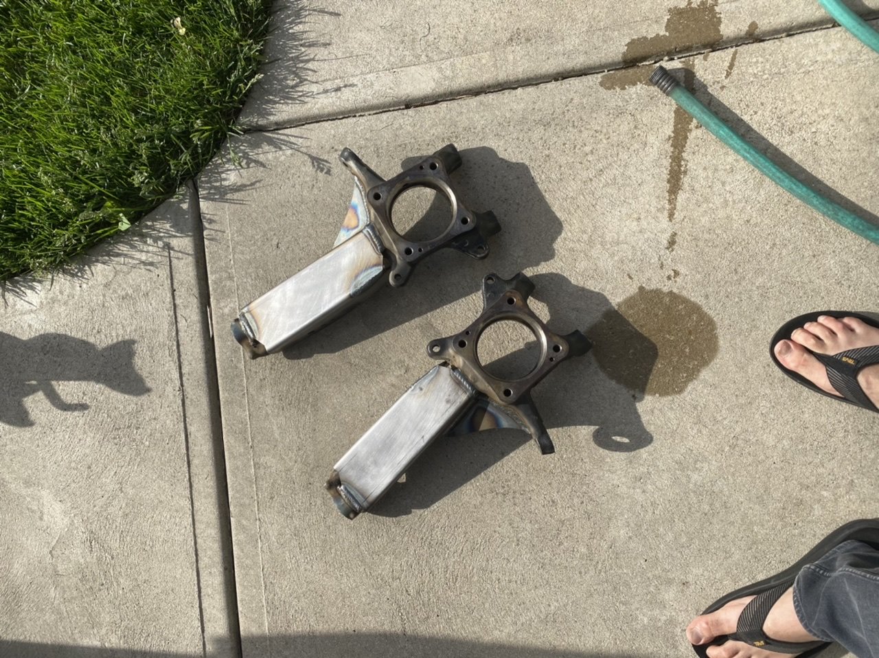

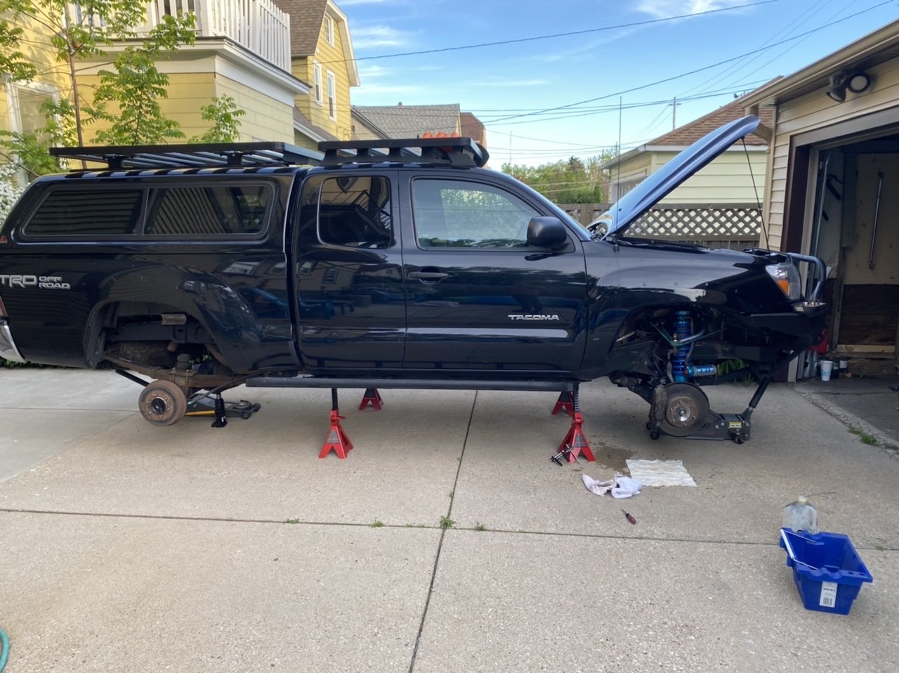

    TC gusseted spindles and resinstall rebuilt shocks and coilovers
    Man what a learning experience... read that as a “it was huge fucking hassle“.
    This started because I was tired of the taco lean and my front end finally settled with the weight of the steel bumper and my tires were rubbing again on the pinch weld, so I needed the coilovers adjusted up. But with 700lb springs and corroded bodies, doing it myself was impossible. I found a local shop that would rebuild/recharge them and adjust them at the same time. So it seemed like an opportune time to put on TC gusseted spindles on (because why not?) put new rotors and break pads up front. I had also hoped to swap my carrier bearing, all the u-joints, and my rear brake pads.
    Turns out that was all too ambitious. In the end, I got the spindles installed, front rotors and break pads (NAPA, which I hate), and the rear shocks and front coilovers uninstalled/rebuilt reinstalled.
    Did you know the spindle is nearly impossible to remove with the coilovers out? So I had to put the fucking coilovers back in to remove the spindle. That was a hassle.
    Did you know that you have to force the tie rod end into the knuckle with a pry bar to Hold it tight to screw the castle nut in? I didn’t and drove like a 1000 miles with sloppy steering because I’m a dumbass.
    Did you know that of you have one brake calipers off the truck and the other on, and step on the brake it forces the piston out of the uninstalled caliper and spills brake fluid all over your driveway and forces you to spend an hour forcing it back in and seating the little rubber boot, and another half hour bleeding the brakes?
    In the process, I figured out that my TC upper control uniballs are shot and need replaced, and at least one spherical bearing in my coilovers/shocks is shot. And all the others are rusted.
    I had a road trip immediately after this so a loaded truck (kayaks camping gear, etc) on sloppy steering (Until it got sorted out at a firestone in Chesapeake Virgins) and my truck has been squeaking like a fucking banshee ever since.
    The project took days, was much more involved and harder than I thought. And now a bunch of it has to be taken apart again to fix the squeaks. Sigh.

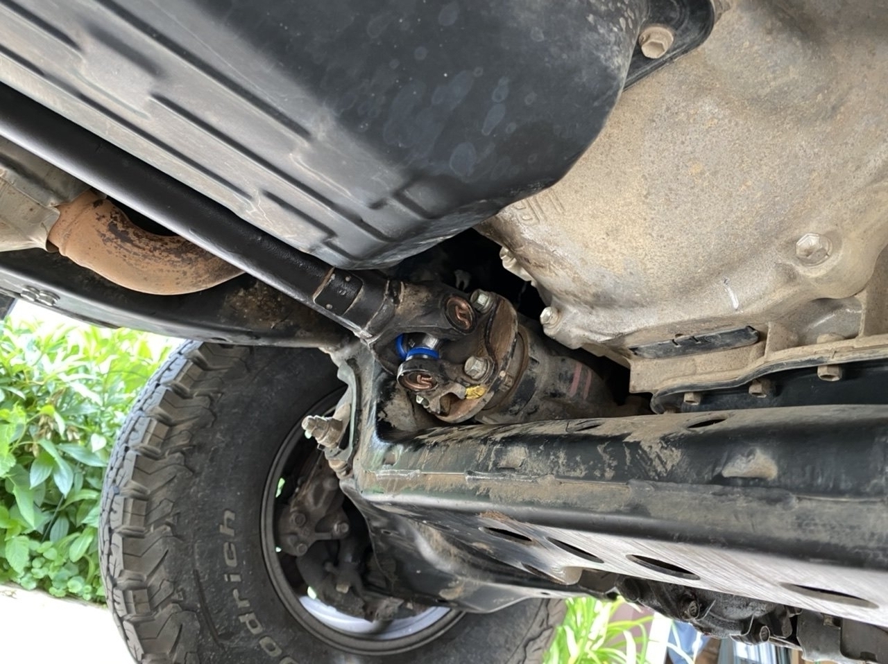

    U joint and carrier bearing replacement
    Part #s
    Front Spicer 5-153x
    Rear spicer 5-1330-1x
    Carrier bearing 5002007

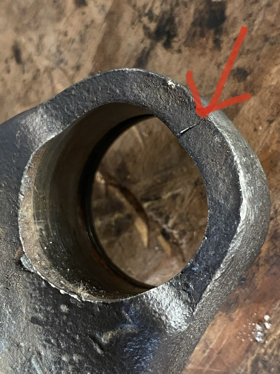

    After two Wisconsin winter of road salt eating my truck alive this summer is the summer of aggressive maintenance.
    After 130k miles, I decided it was time to replace all five ujoints and the carrier bearing in my drive shafts. Easy right? Maybe not so much.
    This to was a bit of a debacle, thanks to everything being seized with rust and me not having an impact wrench. The rust meant hammering more to few the drive line and working much much harder to press out ujoints. The lack of impact wrench meant that I had a damn hard time removing the drive shafts followed by me breaking the slip yoke trying to hammer it into the drive line a little more. :facepalm::annoyed::angrygirl:
    Toyota Doesn’t sell the slip yoke separately. They want to sell me the entire drift shaft assembly for far too much money...
    northerndrivetrain.com has exactly the part I need for $42. That and a drive line rebalancing will be far cheaper than the dealership option. Still, feel like a dumbass though
    So for now the truck is sans a rear drive shaft and un-driveable while I wait for the new slip yoke.
    But, I did replace 4 of the 5 U joints. And the carrier bearing.
    The front drive shaft was easy.
    The rear was a hassle because of the carrier bearing. The bolts on the driveline are tightened to about 1000000ft/lbs so without an impact I really struggled. (I ordered one tonight)
    tools that really help:
    - for god’s sake have an impact wrench with 14mm socket on a swivel adapter (or extension might work?) for the cranked down bolts
    - u joint / ball press. I tried my 6” vice and a hammer and two sockets. Not as easy as the new harbor freight u joint press I now own.
    - 24mm socket for the yoke nut plus pry bar to hold the drive shaft while you loosen it
    - 2 jaw puller to pull the slip yoke, I could not get my three jaw puller to get it out, nor a hammer like one video suggested
    - 3 jaw puller to pull the bearing
    - breaker bar
    - 14mm wrench and pipe for leverage
    - 17mm wrench
    - small socket for zerks (8mm?)
    - needle nose
    - small punch to set the clips
    - BFH (Don’t use it the way I did)
    - paint marker for drive line marking
    - center punch to scratch the yoke ridge and driveline spline to line them back up later
    - angle finder?
    - jack stands to catch the drive line
    - grease
    - beer. That was important.
    - other things I forgot?

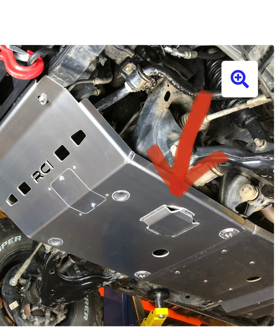

    Added RCI steel full skids! Now to take her out and scratch them up!

    Sparky
    SE Wi
    06 4x4 dc trd ofrd
    3" lift? A.R.E cap 285/70/17 moto metal 955 17x9
    What's the rock catcher on the skid for?

    Rock catcher? I did notice I forgot to take the stock tow point loop thing off, which I will. Otherwise there aren’t really any rock catchers on the skids. Plus I had my exhaust rerouted and have the smoother belly skid plate option because of it. These skids seem pretty smooth to me. Since I’m not a fabricator I live with the options on the market...
    Were you talking about the little bump under the front diff? It’s smoother than it looks in my pic.

    Yea that was it, it looked like it an add on bent piece only welded on two sides in the pic you showed first.

    Yeah it’s hard to take pictures of a black truck or a black underside of a truck on a bright day. It’s a bump, but a smooth one. Anyways, it’s better than the beat to shit stock skid plates that’s for damn sure. I did notice my LCAs and transmission cross member are a little beat up... hopefully these will help.
