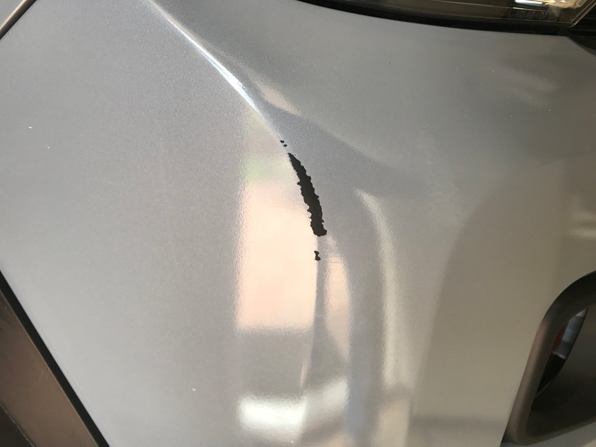

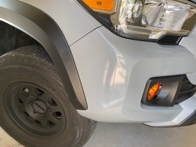

    Touch up paint will cover the very noticeable scratches, but if you use the simple bottle/brush type it probably won't match 100%. It might be less obvious, but get close and you'll still see the patch. The spray touch up "can" work but it's not a 10 minute project and takes some skills.
    Here's a before and after touch up I did on my Cement OR. No one notices it, but if you look very closely it's pretty obvious.scratchopm.jpg IMG_2518.jpg

    I used this company https://www.automotivetouchup.com/touch-up-paint/toyota/
    I got the prep solvent, primer, base coat and clearcoat. I could have just use alcohol instead of the solvent, but it was cheap. The hand glaze would be useful I think.
