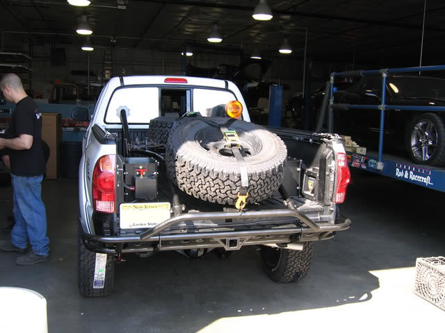

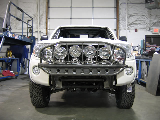

  16. Apr 23, 2008 at 7:15 AM
    #16
    mjp2
    mjp2 Living vicariously through myself Moderator
    Feb 16, 2007
    #924
    21,980
    Milton Juevo Portimous II
    NJ
    Current: '21 Bronco Badlands. Previous: '06 TRD Access Cab, v6, 6-speed
    The late-generation 6-lug Tacomas have a 6x5.5 bolt pattern.
    You can kinda see the distance between the inside of the tire and the upper control arm in this shot. Note that I'm not running the stock UCAs, so you'll probably lose an extra half-inch of clearance with the stock hardware.
    Stance from the front:
    Tire width from the rear:
    I know they're not the best shots for what you're looking for. I don't have any pictures specifically for wheel/tire offset, but I hope they help at least a little!
