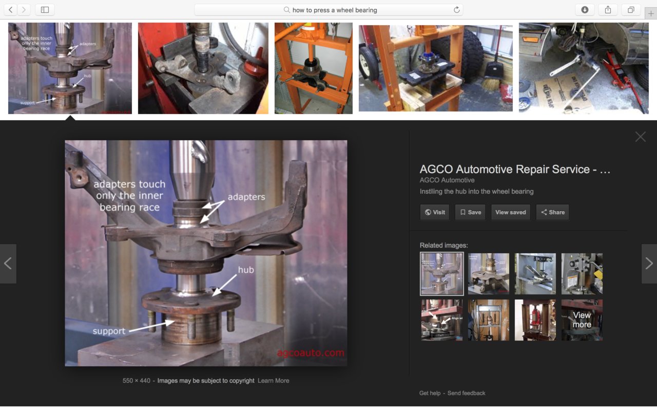

    OP got it right. When you press the hub/flange into the bearing you have to support the inner race. The two halves of the inner race will spread if you dont.

    Why do I get the strange feeling you would have said this no matter which way I had done it - by the inner or outer race?
    wut...?
    Why would I press it in via the outer race? That would put pressure on the outer race, which would press the (ball) bearings into the inner race, which would then cause the hub to slide in.
    Why wouldn't I press directly on the inner race to avoid crushing the balls?
    So what do you have to say about the noise going away when turning right?
    The way I understood it is when you turn right, you are loading up the left wheel bearing, and unloading the right one, which would make it quiet if it's bad, and vice versa when turning left.
    I used a drift supporting the inner race of the wheel bearing while I pressed it onto the hub. The hub was resting on scrap wood while I pressed it.

    Prob. because of the way I said i didn't know how you got the hub in. It came across badly, I just didn't know. Sorry. If you feel like you got it in right, that's fine. It's all a shop can do.
    Maybe we're just crossed up about which is inner and which is outer. I just know they cant be pushed in the middle. It does exactly what you said you didn't do.

    This is exactly why you buy pre assembled hubs.
    Never press from the inner race..
