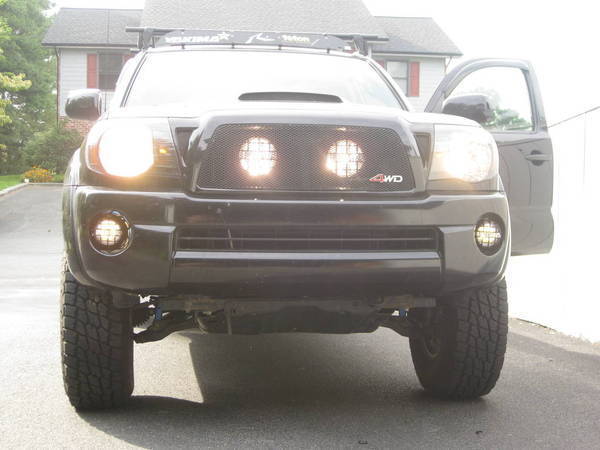

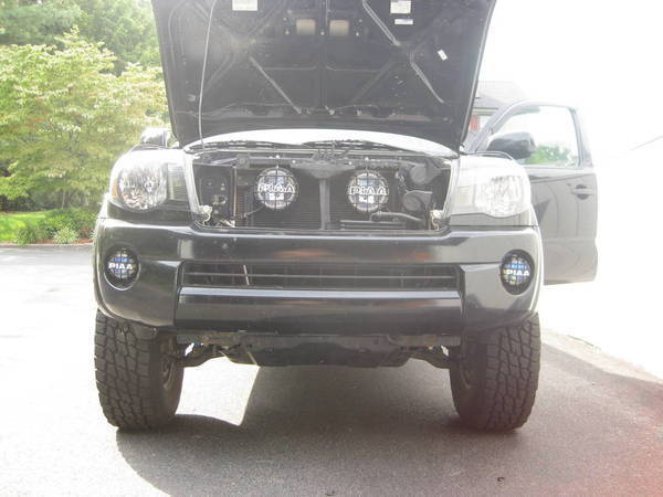

    A few bolts are different.
    Big props to bcgrednek3006 for the idea and guidance with the fog light retrofit.
    before (old pic)
    After

  16. Aug 1, 2009 at 6:05 PM
    #16
    MUDFISH
    MUDFISH Well-Known Member
    Apr 1, 2009
    #15465
    535
    Syracuse
    12 Double Cab SR5
    I'll jump in this line... been looking for one at the right price...
    Looks nice BTW...

    yes I would like to sell it. The light bar itself is in good shape, I just repainted it about 2 months back. the brackets that mount it to the frame could use a new coat of paint there is a little surface rust. I was thinking I would let it go for $50 bucks + shipping from 37604
    its a real simple retrofit. all you need is a 3" 3/8 bolt some washers, loch washers and 3/8 nuts and peace it all together. as soon as you get the factory fog out of the hole you will see exactly how you will have to mount the piaa's in there. I was a little confused at first but when you pop the factory fog out the idea of how to do it will be obvious. Just use use multiple nuts and washers to lock and stabilize the light on the mounting tab.

    how hard was it to mount the 510s in the fog light hole?
