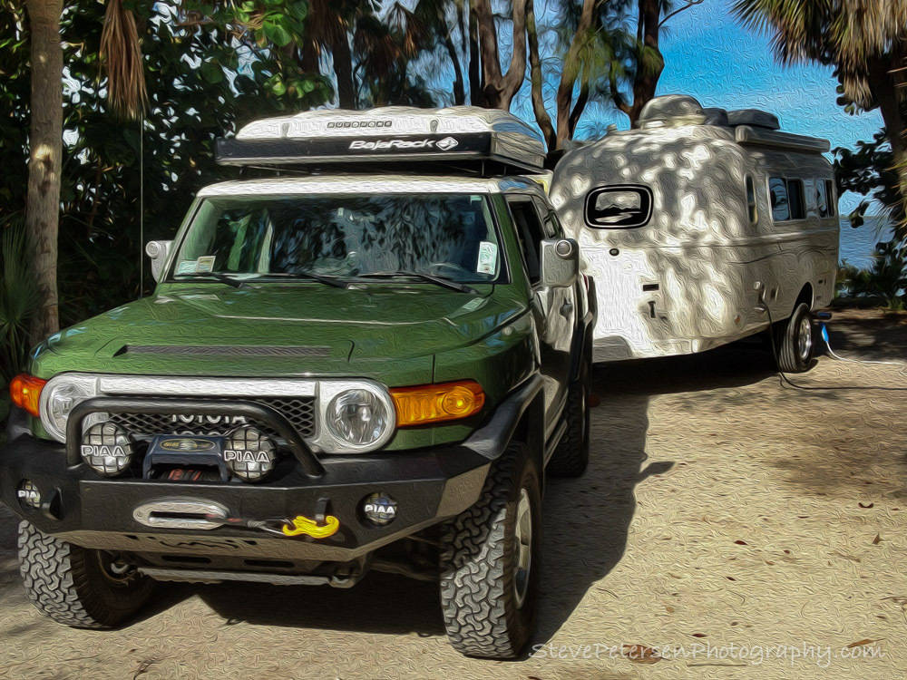

    Cypherian, I think you made the right choice in trailers. I bought an AS Bambi in Rhode Island and towed it home to Florida. I also took it out west for 6 weeks, traveling through the Rockies. I towed with a Toyota FJ Cruiser and had no problems other than a blow out going 75 mph. I was able to pull to the side of the road with no problems and only minor damage to the wheel well. By the way the trailer tires were brand new, maybe three months old. You can't safely go over 65mph with trailer tires. I did have a special hitch and mirrors. After more research, I found Oliver Technologies Travel Trailers. They are very similar to the one you are getting, fiberglass. They have an all aluminum frame, dual group 27 batteries, inverter, satellite TV, AC, three way fridge, double hull with insulation between, dual pane windows, adjustable tongue. It weighs 3800# fully loaded and I put 16 inch wheels on it with Michelin LT tires. So I have no worries about going 75 down the highway. It comes lifted with quad shocks.
    The AS was really, really cool, but was going to be a nightmare in maintenance. Outdated technology and poor build. It had the potential for leaks everywhere and wood floors and furniture.
    I am getting 1-3 more mpg with the Oliver and do not need any special hitch and do not need the tow mirrors. I have had this trailer all through the Rockies and the eastern mountains with no problems towing with the FJ Cruiser. The Taco should be even better, as it has a longer wheel base and can tow more weight.
    I have an Icon stage 4 lift with CDC on the front, 265/75/16 Goodyear Duratrac tires. My Oliver is 17 feet and heavier than yours because of the double hull. If you haven't already, check out the Fiberglass Forum. I have a friend that has been pulling his Oliver, just like mine, for four years with his 4 cylinder Taco. He has never had any problems and also pulls through the Rockies.
