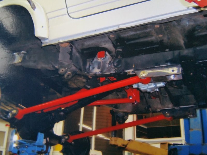

    I had a built Samurai also, just used regular wheel weights though:
    Samuryan[QUOTED] likes this.
