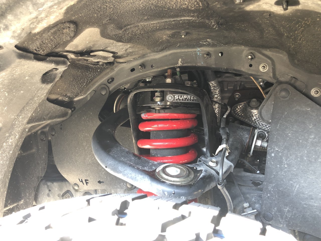

    Hope everyone had a good long weekend. I took advantage of discount tires' memorial day promo and put some 33" BFG T/A KO2 (https://www.discounttire.com/buy-tires/bfgoodrich-all-terrain-t-a-ko2-dt/p/37549) and figured now was a good time to show the before an after pics (sorry in advance for the second pic with the sun blowout) with the Supreme 2" spacer (https://supremesuspensions.com/coll...nsion-lift-kit-2wd-4wd?variant=21410364129360) and AAL (https://supremesuspensions.com/coll...eling-lift-kit-2wd-4wd?variant=21391318155344).
    For what it's worth I PM'd a lot of people who went with the Revtek route and got about an 80/20 ratio who said they were 100% happy with it compared to the few who said the ride was noticeably harder. After speaking with @Speed Freek I decided to go with top-hat spacers instead of the Revtek's preloaded spacers. I obviously can't speak on the Revetek set up, and most people who went that way seem happy with it, but I haven't noticed a difference in ride.
    With the tires, I definitely have noticed a drop off of ~2 MPG, I don't know the delta for sure as I haven't re-calibrated the truck's CPU for the larger tire diameter nor have I had them for too long.
    Hope this helps anybody on the fence, but the lift itself was noticeable and only enhanced by the larger tires.

    This sounds dead on correct to me. Top plate spacers move the entire shock assembly "down". This means if you bottom out your suspension, the shock will take the brunt of the force and will eventually destroy the shock. The spring/pre-load spacer you are using is how adjustable shocks work and won't put any extra stress on the shock (maybe just the spring). I didn't know this was available and now you have me thinking of doing this on my pro sometime in the future. Pretty cool! I guess worst case scenario, the spring breaks and you have to buy a new one... maybe go with a custom eibach spring that can handle the pre-load? Comes in red too! It will be interesting to see how this holds up over the next few years.
