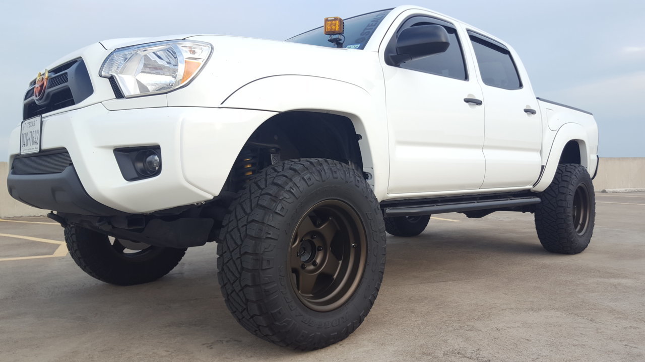

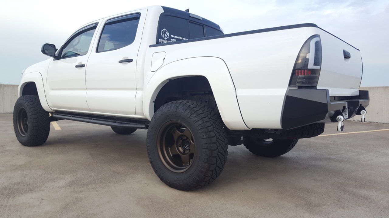

    When I first got in my truck after putting on the 285s it did feel a little sluggish.
    That went away within a couple days and it feels totally normal now.
    285/70/17 Nitto Ridge Grapplers on SCS F5s 17x9 3.5 backspace -38 offset
    Here is a really great thread for the Maxtrac spindles. Id suggest going with Dakar leaf packs and Bilstein B110 extended rear shocks.
    https://www.tacomaworld.com/threads/maxtrac-spindle-lift-for-2nd-gen-prerunners.203889/
    Happy lifting and holler if you've got any other questions!
