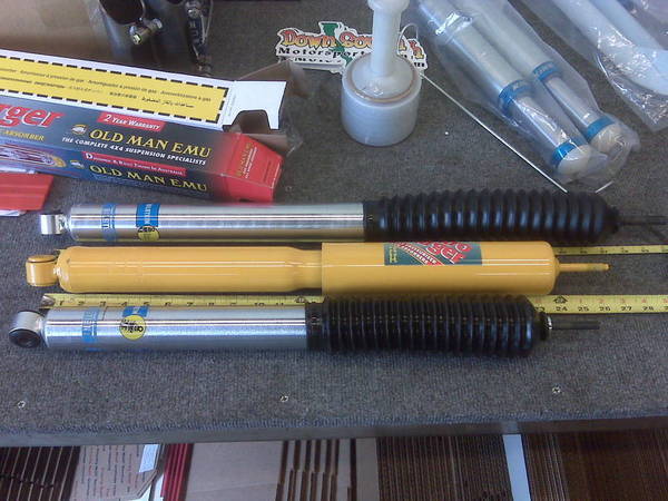

    I have been trying to figure this one out too but I guess they are kinda in between sizes on the 5100. Doesn't the same problem exist with longer ones only opposite, meaning bottoming out?
    I'm thinking of just getting some OME182's and just forget the whole confusion.

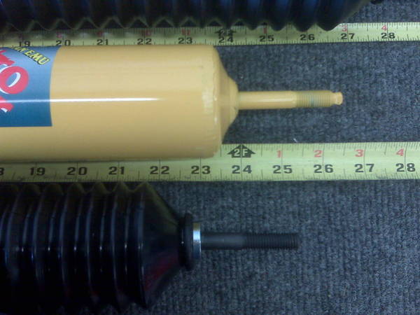

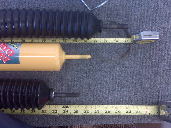

    Hey Steve,
    That guy I was telling you about, who installed the B110 with TSB + AAL...he called and said they bottomed out.
    I set the regular 5100, the longer 5100 and the OME N182 shocks all out on our shipping table, with a tape measure. The OME is about 1" longer than the standard 5100s.
    The part numbers for the shocks I compared are:
    Top BE5-B110-T5
    Middle OME N182
    Bottom BE5-C476-H1
    Sorry for the crappy picture quality, they're from my BlackBerry.
