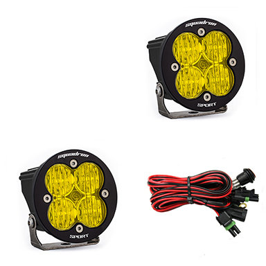

    Sorry to be a pain but why did u get square lights vs the circle ones?

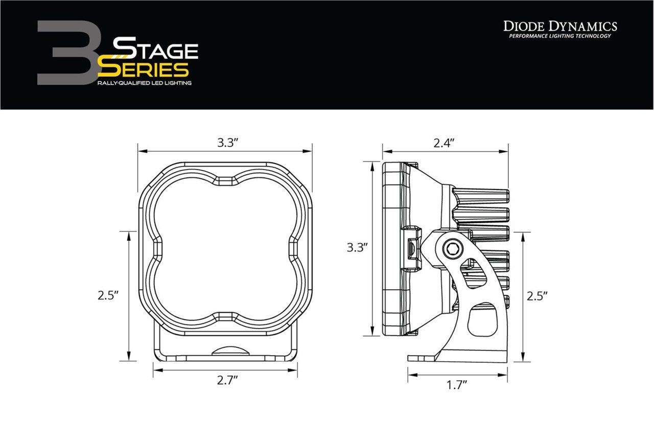

    Also as far as square ones go, how close to matching what you posted should it be? Totally new to this and dont wanna buy $200 lights that dont fit. This one is kinda close:stage_series_3_led_pod_dimensional_drawing_3.jpg

    DD ss3 work in there. I have them installed now, I previously had Baja that weren't SAE compliant. The hole is meant for 4inch wide fogs. Assuming the fogs are mounted dead center. I also know the PiAA work as well. Rigid 360s dont.
    Plenty of used Baja Designs floating around if you don't care about SAE or you can jump on a DD sell. I will say whether you go pro or regular for the DD, they are amazing. I have the pro.

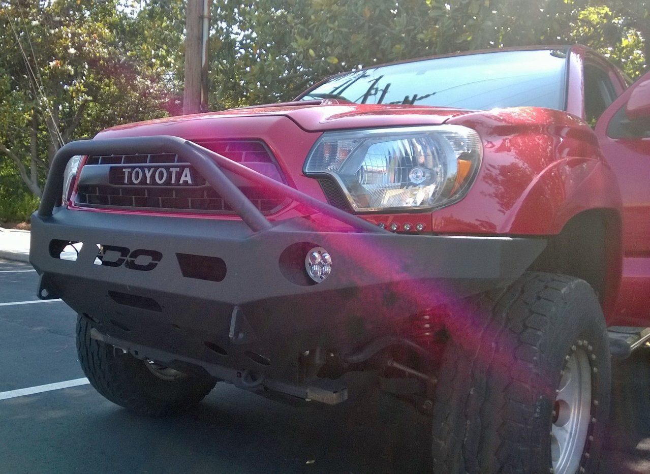

    Round vs square is as simple as changing out the faceplate, I have round in the front because it filled in the opening better. I changed the sports to a flush mount because C4 cut out the openings (at the time) only for the Baja flush mount.

    i would assume, the round bezel is bigger, so i figure it would work, i have the silver bezel in the photo sitting in my garage if they don't let me know if you need them (I moved the sports to my rear bumper and got pro's for the front)

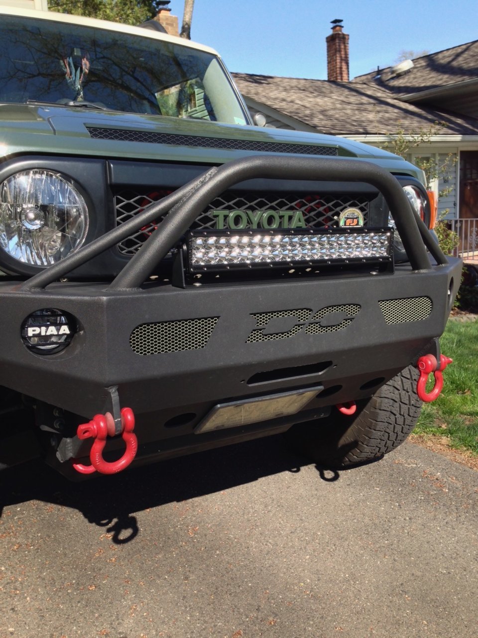

    I had PIAA's on my FJ. They fit perfectly.
