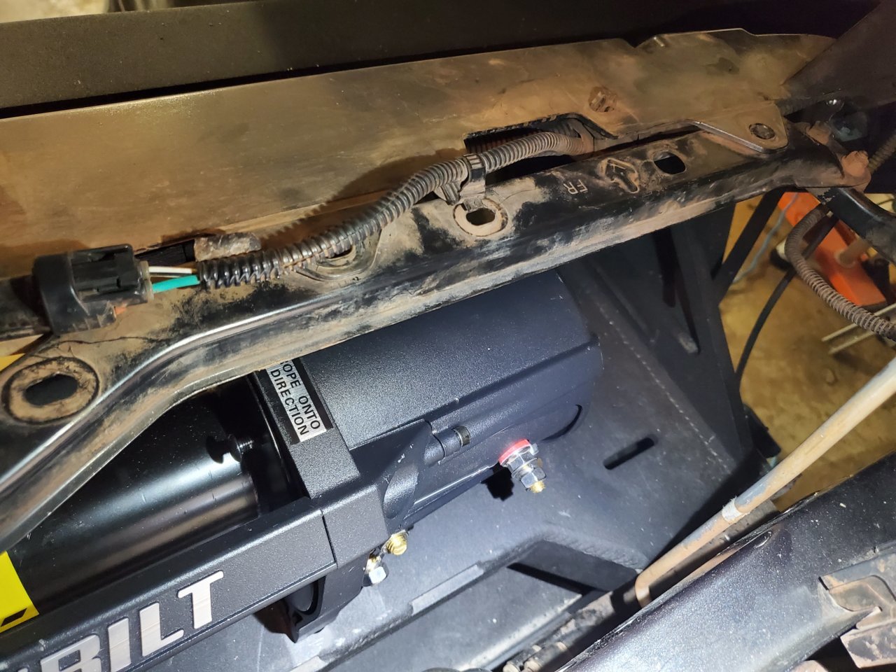

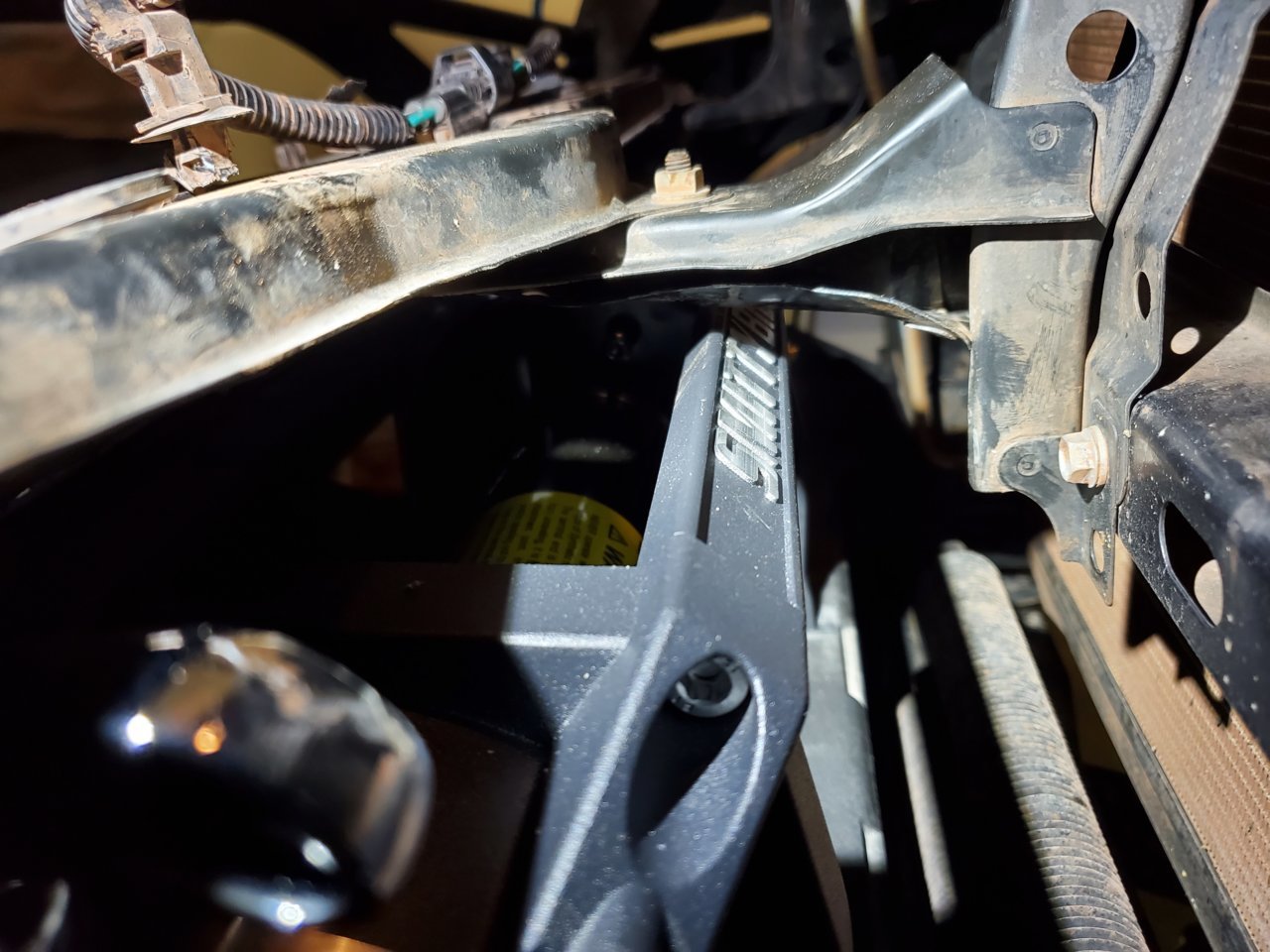

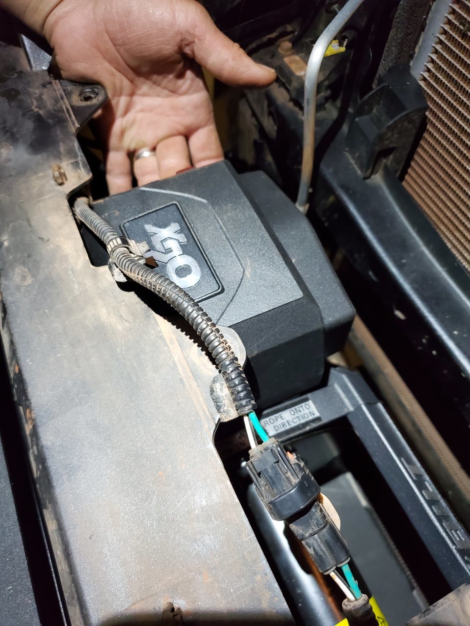

    @JDEMELLO Do you guys have have instructions for installing the winch? The Smittybilt X2O 10k isn't fitting. When everything is on, the winch contacts the truck, even after trying to hammer some of the metal away.

    I just had my installer in here and The box needs mounted next to the winch, not on top of it, we have a bracket that mounts the solenoid to the inside of the bumper. The part where it's hitting should be trimmed, we have to trim that for all winches. Please let me know if you have anymore questions. You can also e-mail me for faster response jason@demello-offroad.com
