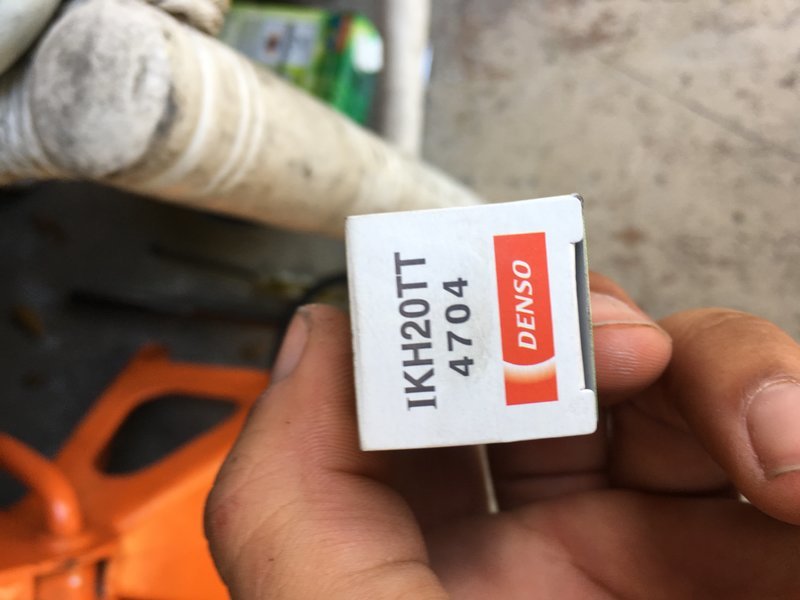

Den so iridium tt plugs?

    Regular Denso K20HR-U11 is all you need. No benefit to running the iridiums.[FONT=&quot][/FONT]

    Well I have them already .no issues with them ?

    if you have the V6 stick to the standard style denso or ngk plugs.... no need for the fancy high prices plugs.

    NGK plugs....the end
    I run them in everything I own with a spark plug.....will never switch to anything else

    Just changed mine at 33k. I went std. Densos for all 6 based on something's I read. Glad I did. NGKs were all much harder to get out and gaps were in .046 range. Densos came out easy and gaps were .042.

    I'm not sure about running the iridiums in the 1GR, but my old '87 MR2 with the 4AGE ran worse on iridium plugs and better with standard copper.

    +1 for standard coppers - either NGK or Denso (or both)
    I swapped mine out this time last year with some Denso iridiums - absolutely no benefit. Iridiums are only needed for use with the Supercharger.
    Coppers are cheap enough, change them @ 30k or earlier.

    I've read that some people have problems running iridiums in the 1GR. Others don't. Copper seems to be the safer bet and are known to be OEM. As for Denso vs NGK, the NGKs I pulled all wore a lot more (larger gap) than the Densos. Therefore I stuck with Densos all around.

    Been running E3's for almost 2 years, no problems. Haven't looked at them, supposed to last 100 K miles, got like 40 on them. Maybe I should take a look at them.

    I decided to run these since i had them, getting worse mpg that the worn out coppers... I was getting 20mpg now only 17mpg. Going back to the coppers

    I've been running the NGK iridiums LFR6AIX-11 for the past 80K miles. MPG has always been the same - 16-18 mpg depending on load and speed. It's the OEM plug on wife's Lexus which is running on 2nd set with 180K. The only reason I got them was for longevity (not having to replace plugs every 30K); truck runs smoothly and responds well. Running Iridiums on my other Toyota's with no issues.

    I bought irridium plugs. No issues 2k miles later. I used to have issues starting but since replacement of factory plugs at 35k miles I have no issues. It coukd just be a coincidence though.
    Me personally I like only replacing my plugs every 100k miles like the rest of the world. I also don't irrationally freak out I'm doing something different than the holy Toyota engeneers recommend :goingcrazy:

    I've had the Iridium plugs in for 30k miles with no problems. Even wit 33s and hundreds of pounds of extra weight, I still get about 18mpg in the summer.
