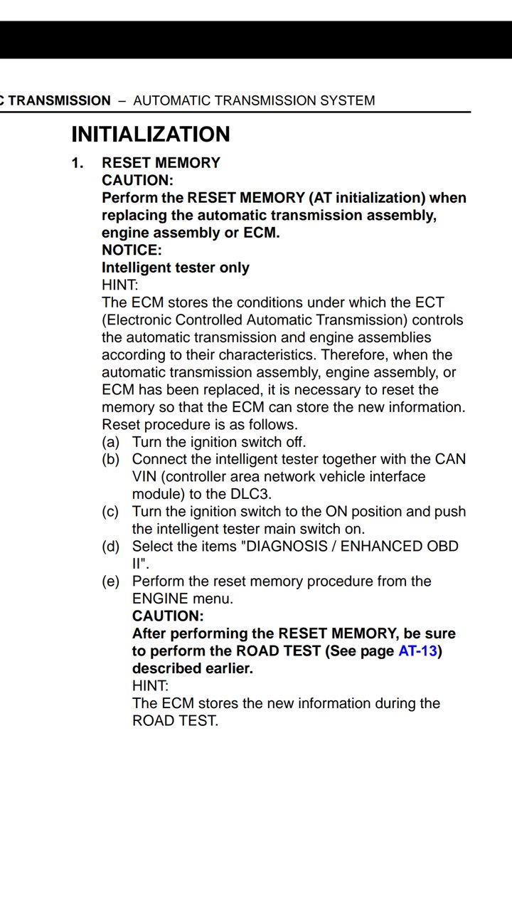

    Have you had much time to tinker with this? Interested in your opinion. I'll need to reset the ect learning of my transmission when I replace it and apparently this is the only way to do it. That's a lot of coin to drop for a one-time use.

    Reading through the procedure on how to initialize the transmission, it states it is with the intelligent tester only. Doesn't seem like it's possible with techstream. I have a mini vci cable, but not the techstream software.
    The write up I was reading may be an older version, and newer versions of techstream can possibly do what I need.

    Actually it seems like the newer versions of techstream supercede this device from what I've been reading and do pretty much everything this handheld does via laptop software and obdII.

    DEFINATELY NOT ONE TIME USE! All my friends with Toyota's use it when they have problems too. The user interface is terrible and it is quite difficult to use but *I beleive* it does some functions nothing else can. Also, all the Toyota service documents refers to it if you've seen those pdfs before. They are around on the internet and you can also get a TIS subscription.
