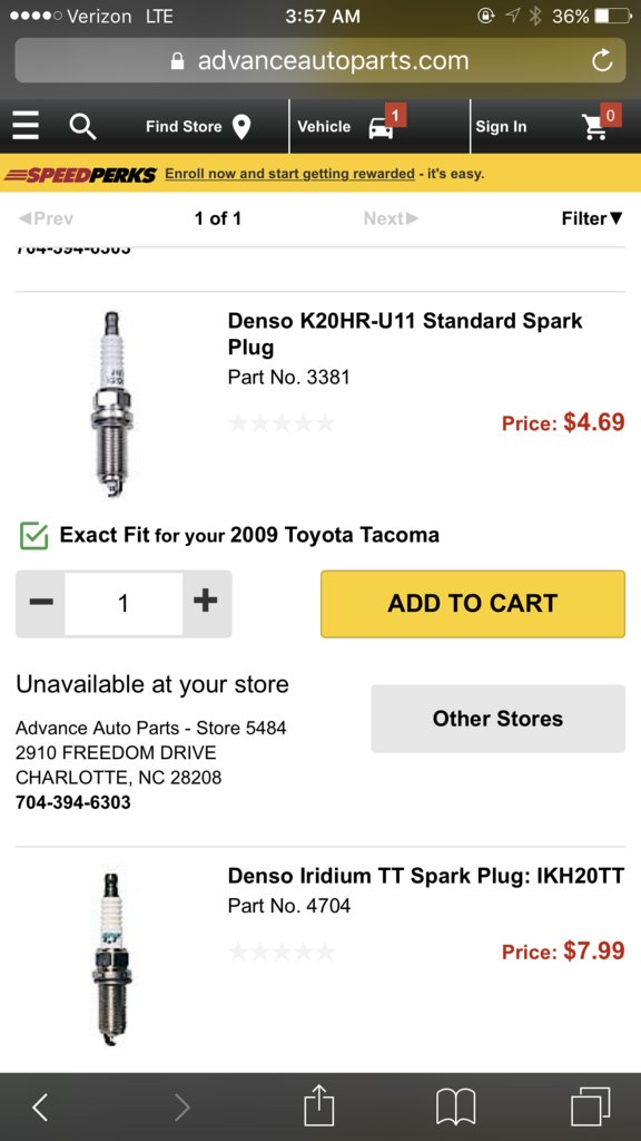

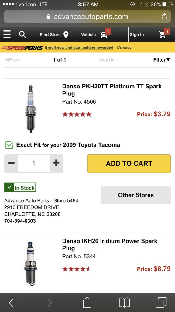

    Alright guys it's time to change the spark plugs in my v6 double cab and just wanted to ask a quick question. I have read that Denso does the best for the 4.0 v6 and I was just wondering which out of these is the best to get? Gonna pick them up Friday morning and knock it out Saturday or Sunday. Please don't post any links to other threads, just please give a straight forward answer and we will go about our days. If you have a better suggestion then Denso, go ahead and throw that out there. Thanks guys!

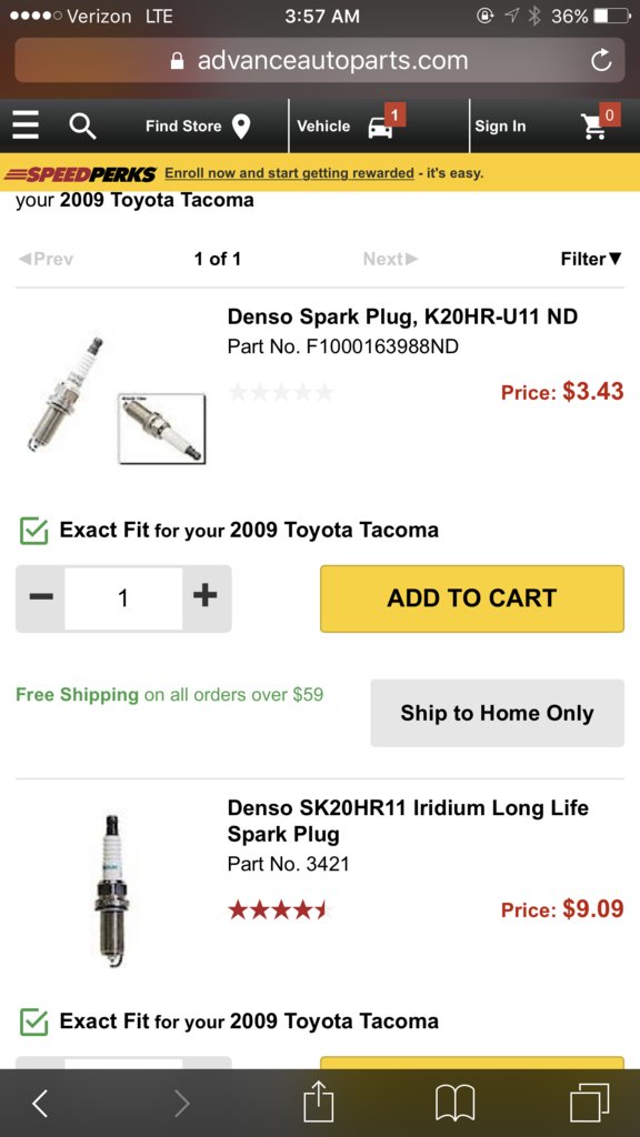

    Do the SK20HR11's if you want long life - 100K+ miles. Personally, I think any plug will do; just get what the manufacturer recommends. The Denso long life's have platinum tip electrodes which will reduce electrode erosion. When I took out my NGK Iridiums with 80K, I had gaps ranging from .050 to .060. I cleaned and regappd them and they are running well with 90K, but platinum tips would have prevented the large gaps due to erosion.

    How much do these run per plug price wise? And I've read to gap between .040-.043. Am I correct? And where would be the best suggestion on more of an exact number

    Each manufacturer gives gap recommendation in their selection guide. Go to NGK's website.
    http://www.partcat.com/ngk
    I have the Denso Long Lifes sitting on my bench ready to install when my NGK's hit 100K. I have no qualms putting Iridiums in my V6. Most complaints can be dismissed as anecdotal. The manufacturers would not list their plugs for a given engine if they hadn't tested them.

    #K20HR-U11 (Toyota part #90919-01235)
