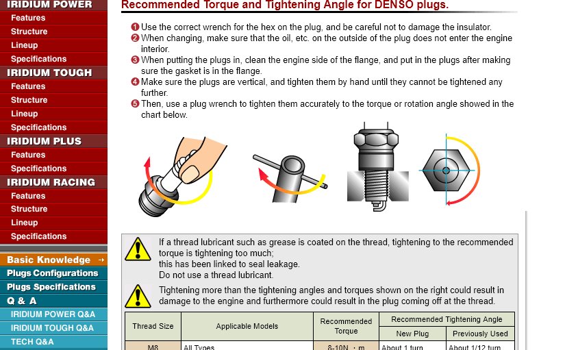

    anti-seize is a thread lubricant, Denso says DO NOT USE A THREAD LUBRICANT
    it is on their BASIC KNOWLEDGE PAGE
    http://www.globaldenso.com/en/products/aftermarket/plug/basic_knowledge/installation/index.html
    but what do I know, I only follow instructions by manufacturers. maybe I could be like one of you experts and make up shit about how to maintain my vehicle.
    ya know, I do get it. Some people find jammed park plugs and mashed up threads. But in all my years, on all my motos (racing, commuting, power generation, haulage, toys) not once, ever, have I had a problem with installing or removing spark plugs for any reason whatsoever. They go in they come out fine, can't explain that.

    It says "recommended". I looked for but didn't find if using anti-seize, or any other thread lube, voids the warranty. I have a box of Denso Iridiums on my work bench; I'll pull out the warranty sheet tonight and review it carefully.
    As many of us that use anti-seize will attest; it does not affect or interfere with performance of the plug. However, I see that many DIY mechanics don't adjust the torque setting to compensate for the increase bolt tension that will occur when using a thread lubricate. The damage will not always be immediately apparent. Every time you install that plug and over-tighten it, you stress the threads and seat. The engineering sheets are pretty clear on this.
    Like @Tex-Tac, I've always applied a little anti-seize on threads and torque to oem specs, and have never had any issues. Now that I know a little more about using lubes and how that affects bolt tension, I know that I've been doing it wrong all along. Doesn't take much effort to do it correctly.

    I was wrong all those years using anti seize, in that link I posted says not to use anti seize on the NGK threads or shinny silver type threads because it already has anti seize type junk applied from factory.

    Your link does say that, but the NGK web site does not. It's OK to put anti-seize on NGK plugs, but if you do, you have to make the torque setting adjustment. Without additional anti-seize, you torque the NGKs to OEM specs.
    https://www.ngksparkplugs.com/about-ngk/spark-plug-101/5-things-you-should-know-about-spark-plugs
