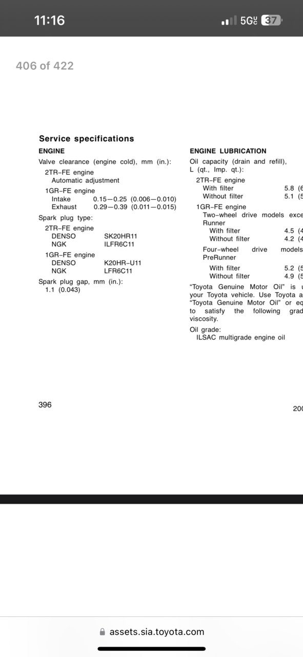

    IMG_1862.jpg I’m due for the Spark Plug Maintenance. have a 2006 V6 DCLB
    Owner’s Manuel recommends:
    IGR-FE (V6): K20HR-U11 (Denso Copper Made)
    What is confusing is I have seen owners using SK20HR11 (Denso Iridium Made) on there V6 Models where our Manuel’s recommended it for 2TR-FE (4 Cylinder)
    I’m thinking to just go what the recommendations is for my vehicle at this time unless someone can confirm the Iridium for the 4 cylinder engine is better?
    Thanks again

    Stick with the K20HR-U11
    The 1GR isn’t a waste spark ignition.
    The plugs last a long time. In my experience a lot longer than 30k.

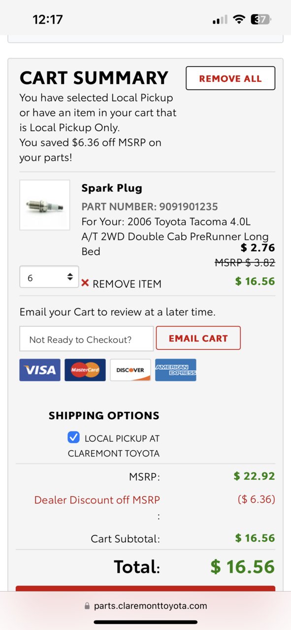

    Thank you for the feedback. My local Toyota Dealership has the K20HR-U11 for a very reasonable price. I’ll purchase them right now. :bananadance:
    ** BTW I didn’t know that if you select “pickup at your local Dealership” you always get the Discounted Price.

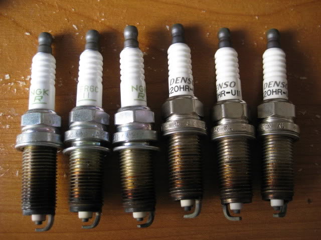

    Is there no love for NGK? At 30,000 miles, the stock plugs were replaced... [​IMG]
    At around 90,000 miles (60,000 miles later), Jason replaced the plugs again (all NGK).
    Now at nearly 135,000 miles (45,000 miles later), a small oil leak has appeared from the passenger side valve cover gasket. An optimal time to replace the plugs when Jason replaces the cover gaskets!
    Any wisdom on best plugs for the 4.0 V6. I am happy to stay with NGK.

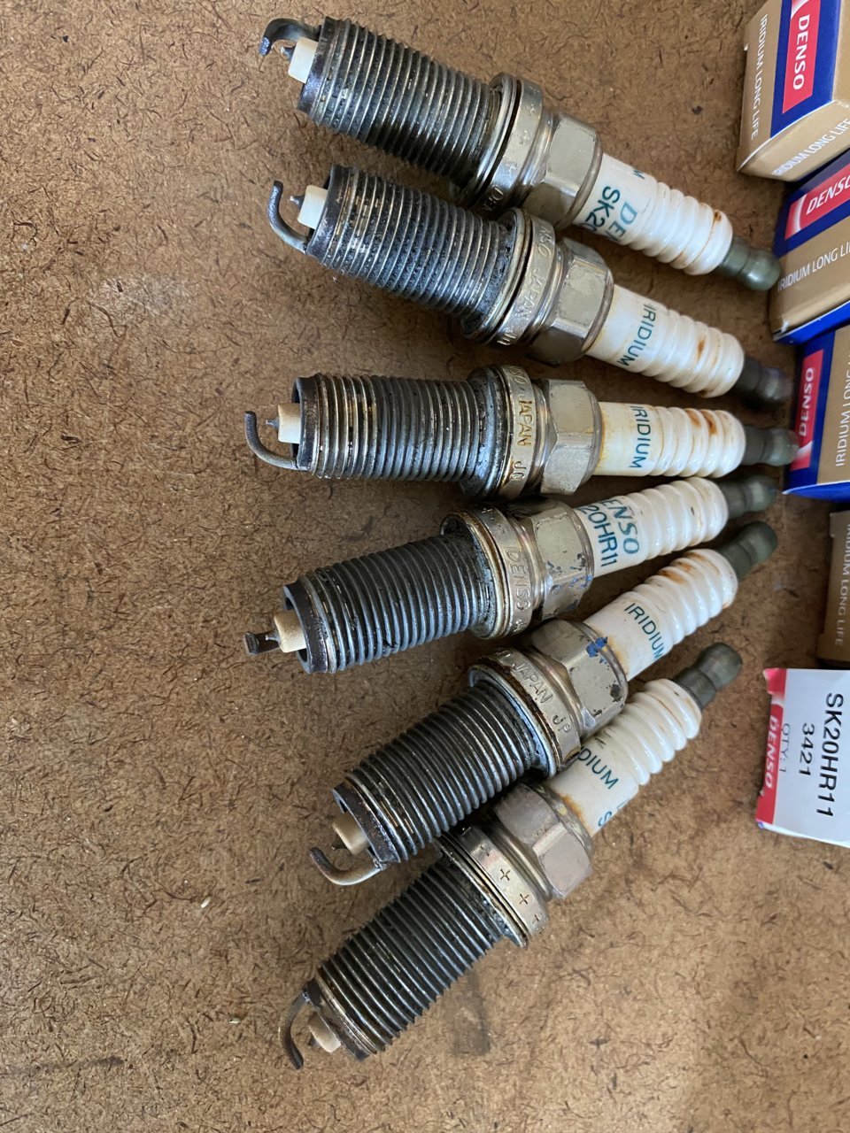

    76
    The plugs from my father’s ‘09 at (don’t judge!) 171,000 kms.
