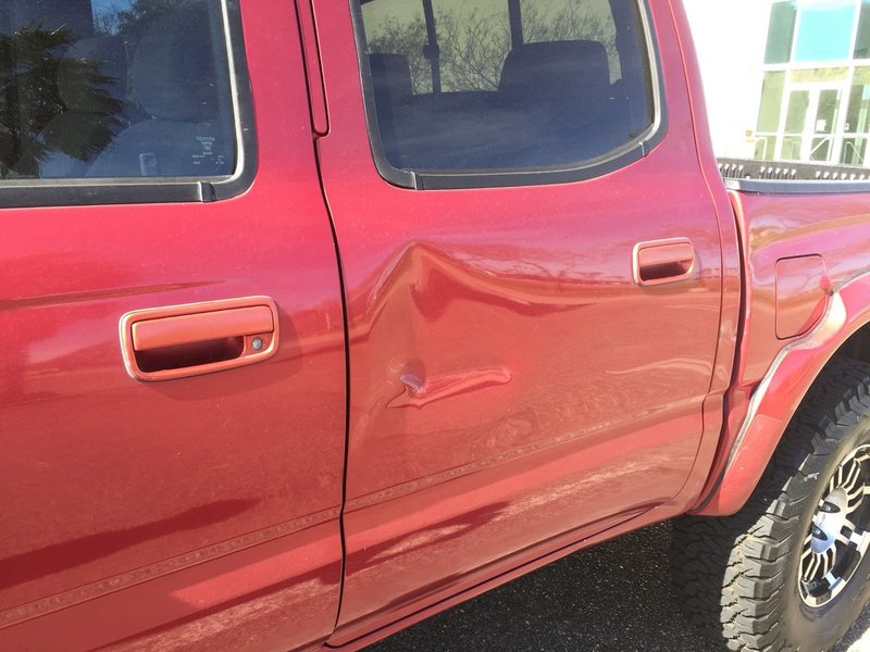

    Hey guys,
    I got a nasty dent in my double cab Tacoma on the rear driver side door about 3 years ago and I was wonder on how to get it fixed with out any damage to the door and not too pricey. Any suggestions ?

    PDR Paintless Dent Removal

    ^^^^^^This.
    Got any pics of the damage OP? I had PDR done on my hood a while back and it looked as good as new, but no sharp creases or cracked paint.

    Here's the damage.
    And I've heard about that but is it pricey? And any suggestions on any shops near CC or SA, TX ?

    Body work isn't inexpensive, dents are cheapest left alone.
    I'd see if a PDR guy can handle it, if they can't they'll tell you they can't. Price quote up front anyway so you'll know if it's in your budget.

    I don't see any reason that dent can't be pulled out.

    Could probably be straightened from the backside with a board and hammer, but it won't be perfect.

    Take door panel off, push the dent out. I did my last one with my right foot :) It's not going to be perfect, but it will be better.

    that can be fixed nearly perfect since it is a door and not edge creased
    then sanded, bondo/filler any small imperfections, paint. no one would know

    So would a good plan to be to try to push it out from the inside then try PDR?

    I'd start by removing door internal guts
    and then suction cup it from the outside while pushing from the inside
    any follow-up hammering needs to be done from inside

    with a dent like that, its not going to be fixable without body filler and repainting so its best to leave it alone and just wait until you find a good deal on a used door from the salvage yard.
    you can check here to see whats available out there: http://www.car-part.com/index.htm

    Just don't go nuts. If you go to far it's not going to look great and the more the metal is worked the more it stretches. With that dent being in a big simple area it's a fairly easy fix compared to it being lower where there are lots of body lines.
    A PDR place is only going to charge you $100 to do the job for you (educated guess but don't hold me to it :) )
    Or if you want to *try* a $10 fix with a basic DIY PDR in lieu of popping the panel from the inside here's how you do it. Get a hair dryer and a large can of compressed air. Heat the metal up with the dryer, then take the compressed air can, flip it upside down (wear gloves here) and spray the OMG cold all over the dent. It will shrink the metal and pop the dent. It's a basic method of PDR, might not work, probably won't hurt anything. YMMV and do at your own risk etc etc etc.
    Personally I think going the door replacement route is just plain silly. The door you have is no where in the realm of needing replaced. Even if you get a perfect door of the same color, it's probably not going to match. Every vehicle has a different life and the paint will fade differently. And besides, even if you end up with a totally pristine door, that matches perfectly, you have damage on the front door, and you have damage on the cab rear, you have damage on the bed. So you'll have 1 pristine panel surround by damage. Fix the dent, go on with life. To do the entire thing right, fix ALL the damage. I'm guessing you're looking at $600-800 to have a body shop fix and do a quick respray of the areas.

    The right PDR guy can knock that out. I'd get a quote before you start kicking panels.
