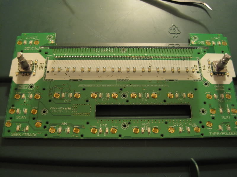

    Anyone in TX do this I'm in DFW and can't disassemble my daily driver? For those curious I opened my radio it has a total of 42 leds in it.

    dont forget the additional 10 behind the main screen on the 05-08 radios (05-08 have a total of 52, and 09+ have a total of 64) ;)

    I included the ones behind the screen I looked all over the entire board and there were only 42 the fourth time I counted them.

    hhmmm...ive done 3-4 radios and have used 52 each time for the 05-08s....so?!
    and here is a pic of a 09+

    ...and no airbag light!!
