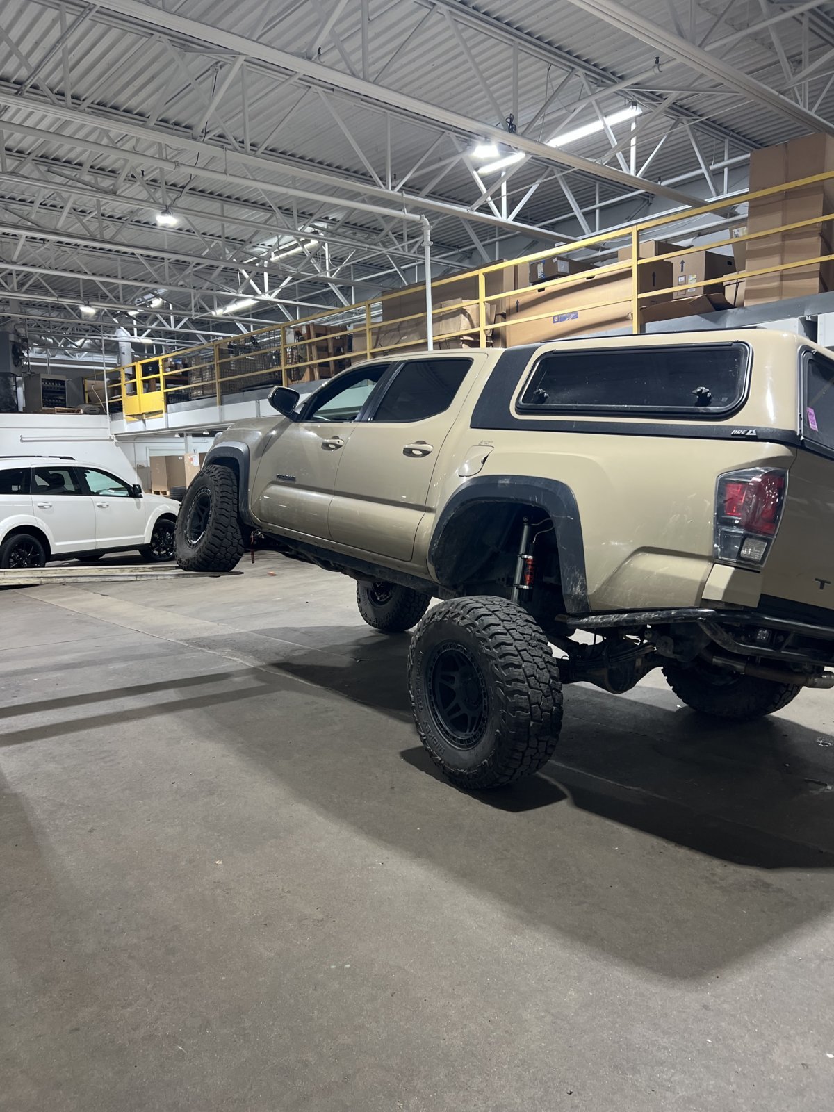

    I just ordered this kit late Monday. Got email from fedex that it shipped yesterday. Should see it next Monday as its coming all the way to Michigan. Going to set it up with the Fox 2.5 dsc coils up front and Fox 2.5 dsc 12" smooth in the rear with a shock relocate. Excited to see what sort of travel I can get out of this compared to my current Ironman Offroad kit.

    Kit was delivered Monday afternoon. Installing this weekend. Was boxed and packed very nice with all hardware labeled. Kit seems to be built pretty stout from a visual standpoint. Will report back once installed.

    kit went on last night and this morning. Few miles put on it so far and feels good. A few minor flaws with the kit.
    1. Lower control arm sleeves was a hair to small for the front bolt sleeve. Little love with a whizz wheel and good to go.
    2. Upper uniball bolt to connect to knuckle could be longer. The strut brace adds a bit of length and it’s tight. Just bought two longer bolts at Lowe’s.
    3. A coupe grease fittings were stripped but a new set and good to go.
    Honestly for the price I was willing to do some mods if needed. Everything fits snug and was easy to align. And the fox 2.5 dsc are so smooth. Anyone looking for budget long travel should consider this. New brake lines are on the way as well.

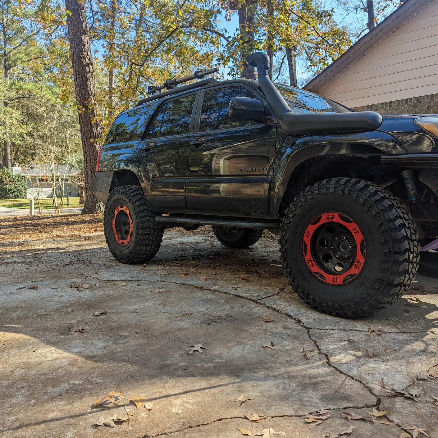

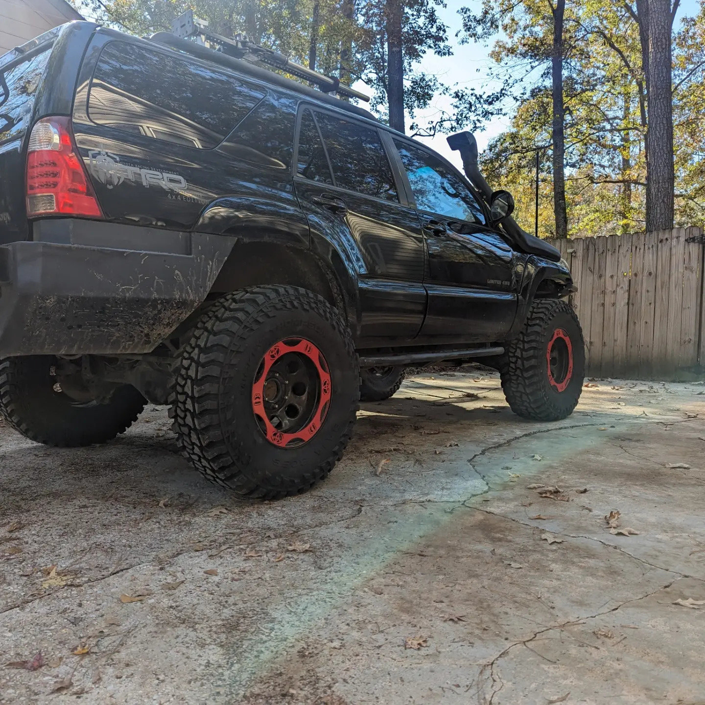

    1000001203.jpg Following this for sure . Definitely interested in this for my T4R sitting on 37s currently but I do swap back and forth to my 35s .
    Currently on the 37s black rims with red rock rings and 35s on the white level 8

    Along with the depo lt kit, I went with the bamf relocation kit and 2.0 smooth body resi’s. Still have 2 more inches of shaft travel but the parking brake cable needs to be modified. Now if I could only get my front cv shafts shipped off-road warehouse…
    edit:this is current on 295/70r17 but soon going to 35’s.
