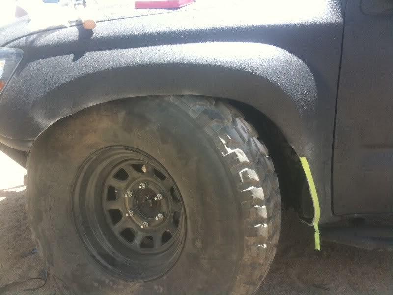

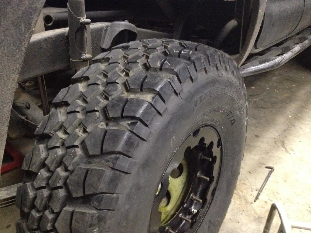

    Here is a pic of 37's fully stuffed at full turn with no rubbing. I could fit 37's on an x-runner. Yes, it helps to have LT to widen the stance, but it's not required. There are dudes running them with 3" of lift, but as you see here I am at full stuff. If I were to bolt them on to a stock tacoma I would get wheels with a large offset (deep dish) and fiberglass fenders. Trail worthy fab beadlocks have a 3.5" backspacing and would be ideal for your situation. You do have to massage your firewall with a sledgehammer and do some work with a sawzall. If you don't mind the carnage, do it. You will need (off the top of my head)
    1. 1/2" wheel spacers for the TWF wheels
    2. Longer wheel studs. Go with ARP's
    3. Sawzall/some way to cut metal
    4. BFH and a burning desire to smash shit
    5. 4.88 gears, might as well get an ARB too
    6. Tires. I got the BFG baja's this time around. 100% better than the goodyears.
    7. 'Glass fenders. Mine are glassworks brand.
    8. Balls. Most dudes will tell you it will never work and your axles will break and it's better to go with 265's and have warm milk and cookies with your mom. Fuck them, where there is a will there is a way.

    Hmm. Maybe. You would still have to cut the body mount, pinch weld, and beat on it, but maybe not as much. If you have uniball UCA's and good coilovers (like Icons, king, etc) the body lift will help get you a little more uptravel as the UCA bolt hits the inner fender at full stuff, but even that will self clearance if you jump it a couple times. I think fiberglass fenders will help more than anything. Go turn your wheel to full lock. Look at what it's going to rub on with 37's...see what I mean? A body lift won't help much, that cab corner needs a beatin' anyway. I'm a hillbilly, but if I wanted to do it "right" I would do something like this-
    http://www.trailslesstraveled.com/viewarticle.php?id=63
