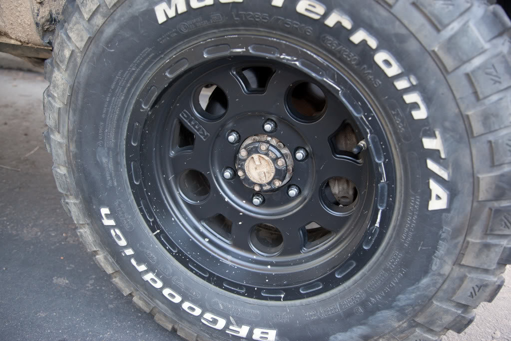

    Finally got the ability to use my 4 wheel drive again, and threw in Aisin manual locking hubs as a bonus. :)
    Cost WAY more than expected, which sucks, but at least I know everything is in working order now and James at The Truck Shop is super cool and he's letting me pay a little bit here and there so I'm not out of all my money at once. :eek:
    Basically I needed a new differential and CV axles...all the gears were completely chewed up.

    What does the locking hubs do?
  12. May 2, 2011 at 8:24 PM
    #292
    derekabraham
    derekabraham [OP] Living vicariously through everybody
    Jul 8, 2008
    #7822
    28,873
    TW'S Hippy Liberal
    Portland, OR
    2002 4x4 4Runner
    Stick on hood scoop from Autozone.
    Google that ish son!
    It means you can lock your hubs or leave them free so all your 4x4 components don't spin when you don't need them to. Saves a little bit on gas and saves wear and tear on your differential and CV axles. :)
