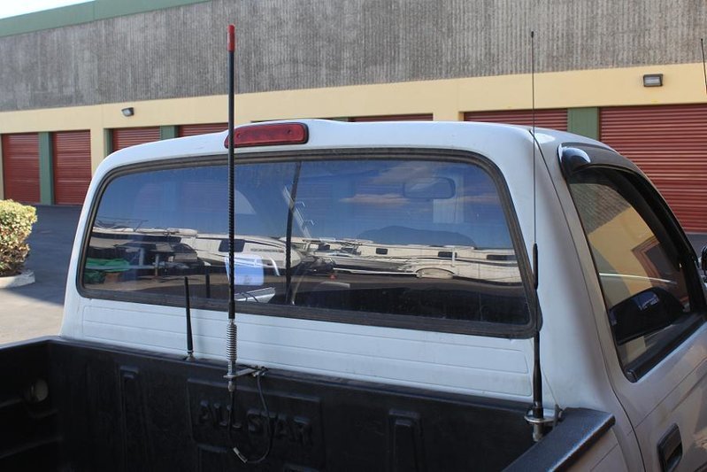

    Yaesu FT-1900R w/ 2m/70cm Comet SBB-224 antenna, Cobra 19 DX IV w/ 4ft Francis CB24 Hot Rod antenna, Uniden Bearcat BC355N 800Mhz mobile scanner (analog), an external BNC mount routed to inside the cab for a handheld fire/police scanner or HAM HT's, Rancho RS5000 front struts and rear shocks, 6in KC Daylighter (pencil beam), 15x7 Black Rock Wheels Series 942, 31x10.50R15 Firestone Destination AT, fog lights, COBRA antenna hood mount (this is used to mount the GoPro on to)
    Not that it matters too much, but what radio do you have?
    You can do a mag-mount style antenna, but I personally like "hard mount"... that's if you have a place to put a hard mount.
    The 2m Firestik I've never personally used so I don't know anything about it? Other than, I know that it exists and if it is for 2m then...
    BUT, if you have a dual band radio then your 2m antenna will/should work with it, as most radios are 2m capable, but again, if it is dual band, then the "2nd band", which is likely 70cm (420-450MHz) will not work with that antenna. Thus, like Anthony is suggesting and/or has, try to get a dual band antenna.

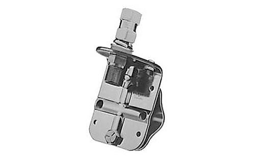

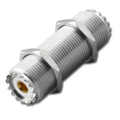

    "My" setup is slightly custom. I'm using a mount that was meant for CB and had to drill the hole slightly bigger to accommodate the SO-239 barrel connector.
    The SO-239 connector is slightly larger in diameter than the lug-hole for a CB antenna.
    My HAM antenna is the one directly behind passenger...
    So, with that said and shown, it is up to you on which route you want to take. I personally don't care for mag-mounts and only have one for quick setups for whatever reason. So far, I have personally seen 3x mag-mounts slide off and/or even fall off the roof/cab, but these were seriously blasting through the desert washes. For me, as you and many others already know, putting an antenna up on my own vehicle is no big deal... simply because... I don't mind doing hard-mount and have many places/options for me/myself, if you get what I am trying to say? Other people are always on the fence, most of the time, on how/where they want to put their antenna as well as how much money to throw at a radio system. Over the years, I easily have roughly 2k invested (possibly more) in radios/accessories/tools/misc. Just my Yaesu FT-8900R costed me, at the time, just over $400 alone... just the radio itself. My point being, it doesn't bother "me" much on the decision making...:boom::bananadead::facepalm::laughing::laugh::rofl::rofl::rofl:
    Finally, the antenna "I" use is a Comet SS-680SB PL-259 mount. (the one in the pic)
    https://www.hamradio.com/detail.cfm?pid=H0-010071

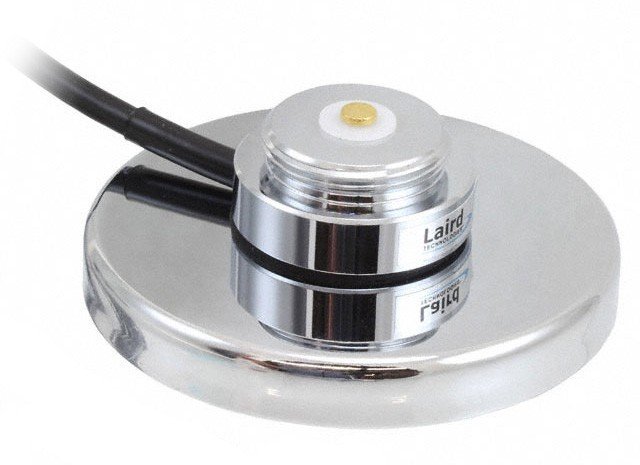

    Regarding mag-mounts, you can get that same antenna in an NMO style typically used with mag-mounts. At my previous place of work, I had so many damn mag-mount antennas for my radio test rack it was F'N RIDICULOUS!!! There were times that I had to come up with some fairly elaborate adapter setups just to get something up and running for some late minute testing!!! :eek::goingcrazy: Here my point being, these were the mag-mounts that I typically worked with and the magnets were pretty F'N strong. :muscleflexing:
    To work with the Laird magnetic mount above:
    https://www.hamradio.com/detail.cfm?pid=H0-010072
    Hope this helps and sorry if my post is LONG!!! :crapstorm: I've made a name for myself as "The Wall of Randy"!!! :laughing::laugh::rofl::rofl::rofl: Just trying to throw out as much info as I can and try to help out as much as I can... :oops::notsure::playball:
    Btw, mag-mounts are typically ordered as needed. That is, if you need BNC, then they will "custom order it as BNC", or PL-259, mini-UHF, etc etc etc... other than that, again, I typically don't use mag-mounts and will either do my own connectors or whatever I need it to be. That's been "MY" personal experiences with mag-mounts when going to places and/or ordering from places like HRO. Again, based off of my personal experiences with what I used to do at my previous job of almost 12yrs. :oops::thumbsup:

    @desertjunkie760 sorry about this, just like he stated, I would do the same if you ever happen to do a mag-mount, for whatever reason, in the future. :thumbsup::fistbump: Most mag-mounts I've ever seen sold came with "rubber booties", but it doesn't hurt to help give that extra "layer of protection" just like what he did.
    So, the Kenwood you have is a 2m dedicated only and I now know of 3x... possibly 4x people now that use this radio. :rofl::rofl::rofl: My understanding is that you remove a resistor to "open" the frequency channels outside of the 2m band (i.e. typically only dedicated to 144-148MHz... without the resistor, you can TX outside of this range). This is a pretty nice radio with having 65W capability, but try to use the lowest wattage possible... as much as possible. 65W is ALOT of power, believe it or not!!! NO JOKE, you want to make sure to NEVER touch or have anyone "accidentally" touch the antenna while keying the radio at HIGH power or you WILL receive an "RF burn". Long story short, the radio was not being keyed, but it was having issues for some reason. I connect the antenna to an EXACT same radio and it worked just fine? Again, long story short, I go to grab the antenna itself because of how/where it was relative to me and NOT easy to get. So I had to really REACH and happened to grab a part of the antenna and that MrFr was HOT??? A different kind of "hot" and it really is hard to describe the feeling, but it hurt for DAYS!!! It ended up being that the Motorola XTL I was working with turned out to have some serious issues!!! o_O:annoyed::goingcrazy::frusty::facepalm: I won't say what city radio contracted shop it was, but man was I F'N PI$$ED when I found out they F'd-UP on programming the radio and I had to start testing the new board and code as well as TX/RX across the city radio system.
    Anyways, you want to use the lowest wattage and/or next to lowest wattage possible to help keep your radio "cool". Most radios, that I know of, have a thermal shutdown to protect itself from practically melting itself!!! :bananadead: Also, if you TX on HIGH power, especially 65W worth, you're gonna likely interfere with the guy next to you and/or each other if ALL of you are TX'ing at 65W in close proximity. Just my 2cents on the matter. :thumbsup:
    Anyways, the link to the antenna below is a "fold over" design and you can raise it at the base and bend it almost a complete 90* angle so you can drive into a garage or something with low clearance and you're getting ready to park. I have a similar one to this. The only thing though is that I don't know how well this particular one will hold up to "harsh off-roading conditions" (i.e. high speed desert washes and such)? But, it is a 2m dedicated.
    https://www.hamradio.com/detail.cfm?pid=H0-000101
    The Firestik 2m antenna, like I said, I've seen them and/or know they exist, just never personally "experienced" one, if you will. Also, you typically do NOT need to worry about "tuning" like you do for CB, but it helps to have the antenna, like that, be able to be tunable anyways (i.e. a tuning lug at the tip of the antenna). The reason being, in my humble opinion, those antennas are "bottom feeders". Meaning, for example, the Comet SS-680SB is "tuned", so to speak simply because of its construction. The Firestik is more "sloppily made", if you will. I don't know how better to describe what I'm getting at and sorry for that? :oops:
    If you plan on putting the antenna on either rear corner, then I HIGHLY ADVISE making sure to get a heavy duty type spring. I can tell you this much, that antenna is pretty heavy.

    @desertjunkie760 Also, when it comes to the antennas, most mobile antennas are not as forgiving as CB whip style antennas. So smacking or a brush "grabbing" on to your antenna as you drive by could be a bad thing.
    Me, I don't have to worry about my particular setup as it is somewhat protected by the cab even though a branch here and there has grabbed on to it as I'm driving by and then "pole vaulting" the MrFr!!! o_O:bananadead: Very rare, but even my setup it happens. But, out on each of the corners they will definitely be more of a "target" for branches/shrubs to grab on to.
    Just a lot of things to take into consideration here is all I am getting at. With a mag-mount, ever do you rarely have to worry about this happening other than "low ceiling situations". BUT, me, on a personal level, not a fan of mag-mounts. I don't hate them, I just personally don't prefer them.
    Finally, the 2m Firestik isn't all that terribly expensive. I know @MotoEd has a 2m dedicated tunable, but I don't think it is 4ft?
    Sorry for the runaround brotha, but as you can see, it's kinda hard for me to recommend other people on what to do and/or how to setup their radio for their rigs. I respect other peoples stuff quite a bit and don't like to go in guns blazing on telling them how to go about it. But, like I said, there really is quite a bit to take into consideration on how to setup a radio on your vehicle. Me, I plan when going about doing what I do for obvious reasons. One reason being that I don't like drilling unnecessary holes if I can avoid it or even taking/removing something that really doesn't need to be touched. It is no different when people go back and forth about what they want for their suspension and wheel/tire setup. Well, the same goes with me when it comes to radios and how "I" want to set it up. Same difference if you really think about it!!! :thumbsup:
    This is my "latest" setup that I've been wanting to finally COMPLETE!!! :annoyed:
    I eventually plan on putting a 9ft CB whip on the RR-corner with a custom made CB antenna bracket. :thumbsup:
