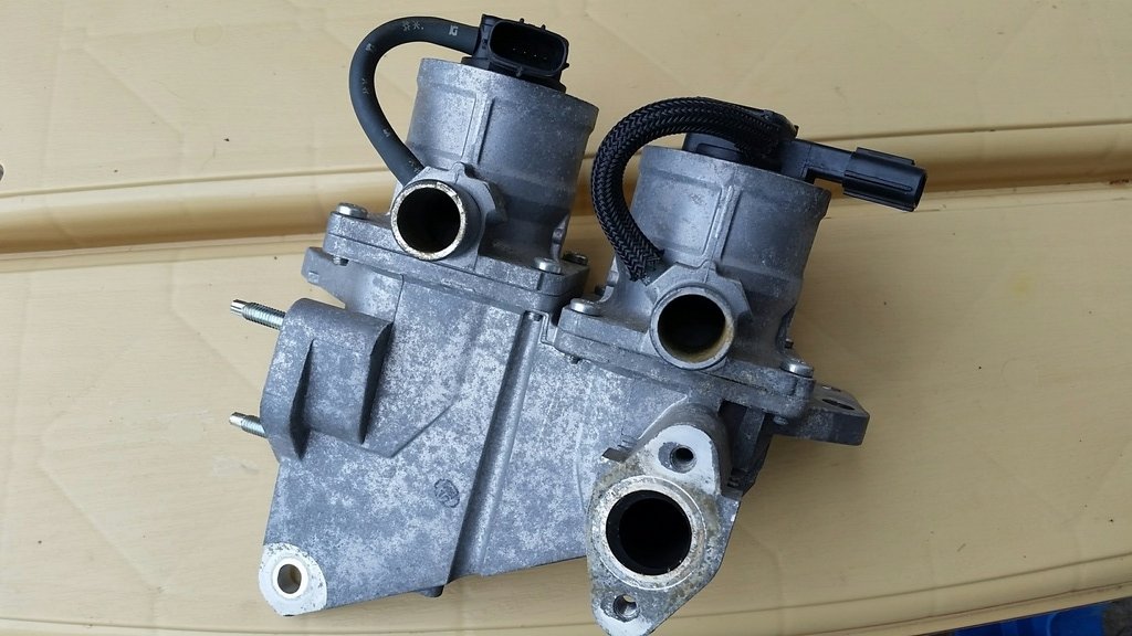

    Was searching the forum because the same thing happened to me this morning.
    Started truck, check engine light came on and trac off light came on. Cruise control will not come on. Truck will not go over 40. And even slower going up a hill. (I'm in 2WD)
    Truck sitting at the mechanics waiting for diagnosis.

    Well, got the diagnosos. Air injection switching valve.
    WI'll be a couple of days before the part comes in.
    I will be out $937.

    Thats what I feared, this seems to be a common occurrence in the 2012s right around 70k miles or so.

    It's interesting the 2.7 4-cyl had the air injection system since 2005 and we don't hear many problems with it. Wonder if Toyota switched suppliers when the V6 got it in 2012, or if the fault thresholds in the ECM programming had gotten tighter.

    This is what $937.00 looks like. My mechanic was gracious enough to save the little @#$%.
    I think I will do some shooting therapy this weekend!!!
    He did say that this was the first of it's kind he had seen. He said most Toyota's have 2. One on left bank and one on right bank.
    Lucky for me mine was both sides in one assembly....$630 part and $307 labor.
