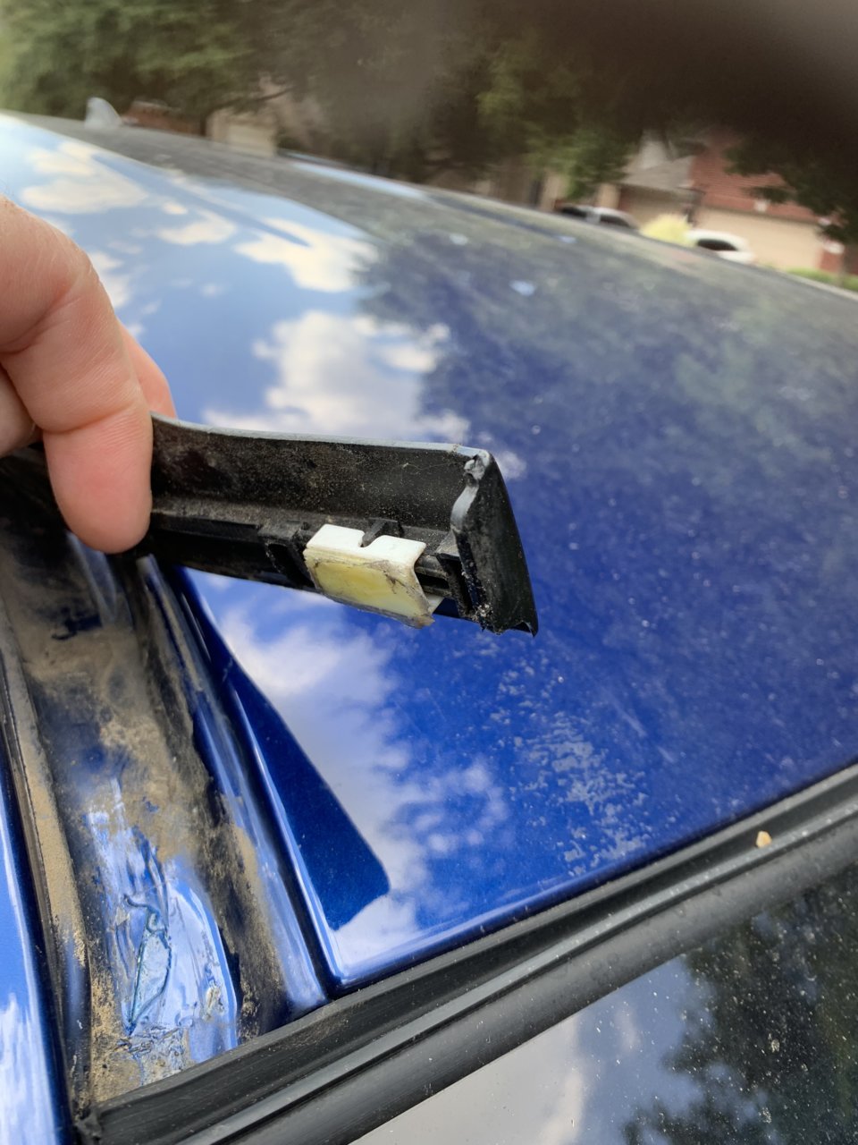

    Anyone know what the rubber strips on the cab roof are held in place with? One of mine let loose yesterday and half of it came off. It appears half way back there is some double sided foam tape but nothing on the front half. The very front does have a small white clip that looks like it may have been bonded down to the cab but if that was all that was holding it down Im surprised more don't fly off.

    That little plastic piece you see up front has a sticky surface that keeps it down up front. It just let go, put some double sided tape on it and press it down. I do have some of those little sticky plastic tabs at I could probably send you.

    oh they do....
    get some new clips and epoxy then on.
    Mark them first before you clean out the channel.
    Install the new ones.
    Then when you put the mounding back on, use a glob of silicon every 6 inches in the bottom of the channel. I do this all the time.
    Stay out of car washes with hi pressure side blowers.
    They come off like butter..
