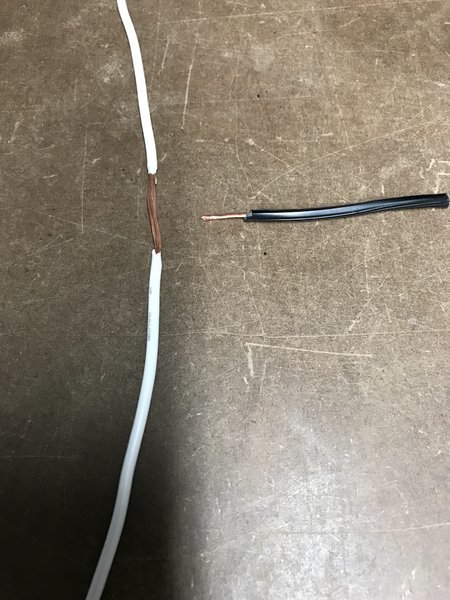

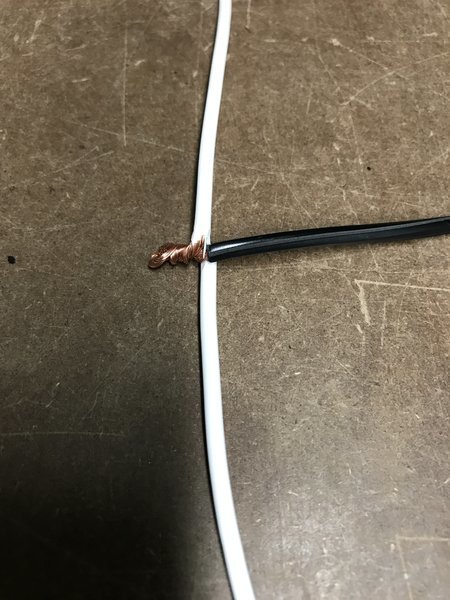

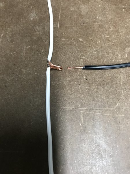

    If you aren't going to solder, this is how we recommend splicing the wires:
    The white wire represents the wire that you are splicng into, the black represents a wire from the harness
    Take a razor blade or sharp pocket knife, and strip a section of the white wire. Then use your wire strippers to strip the end of the black wire.

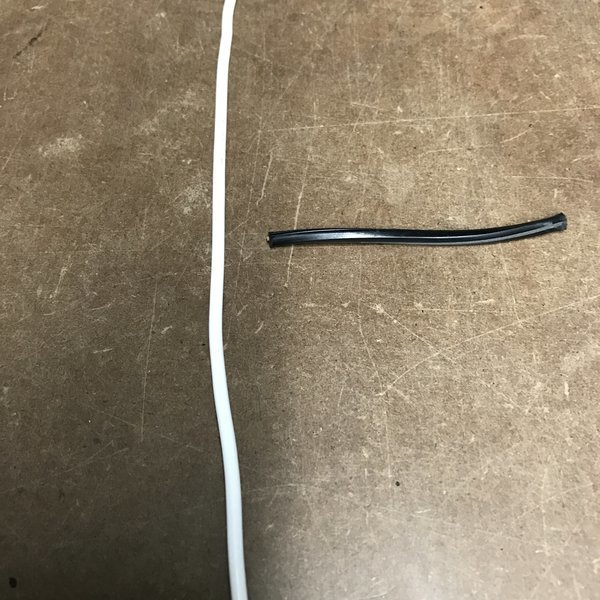

    Fold the stripped section of the white wire as shown

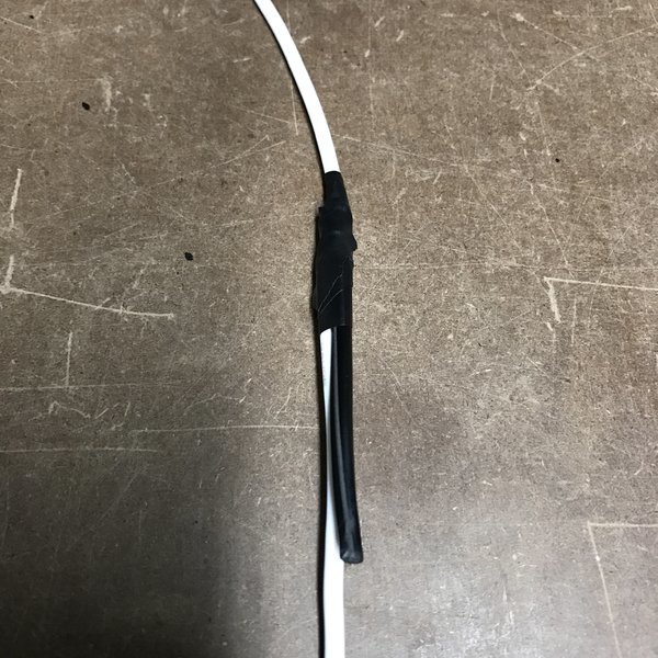

    Now, twist the wires together
    Then, fold the twisted wires against the white wires, and wrap with electrical tape
    I used heavier gauge wire for the pictures, but it will be even easier with the smaller wire in the truck.
    Make sure to twist the wires tight, and tape tight and generously.

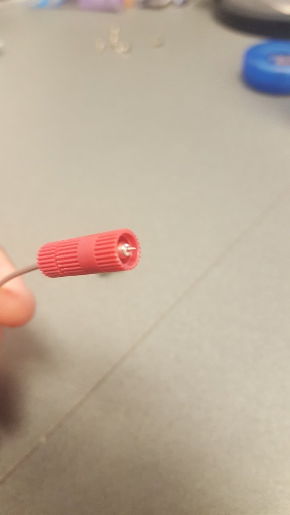

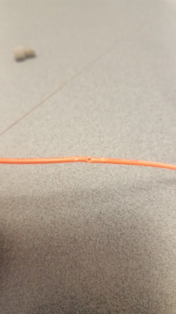

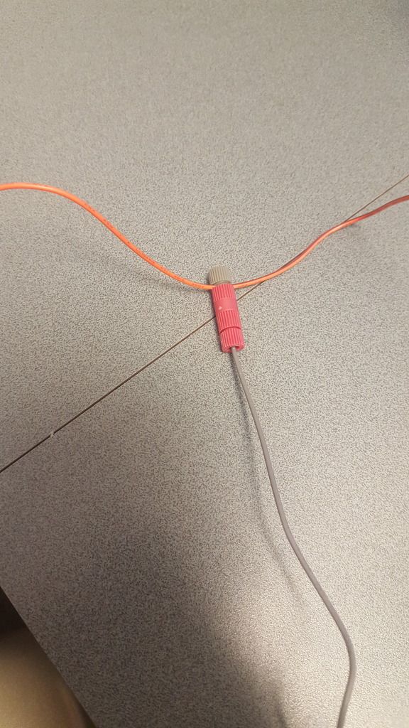

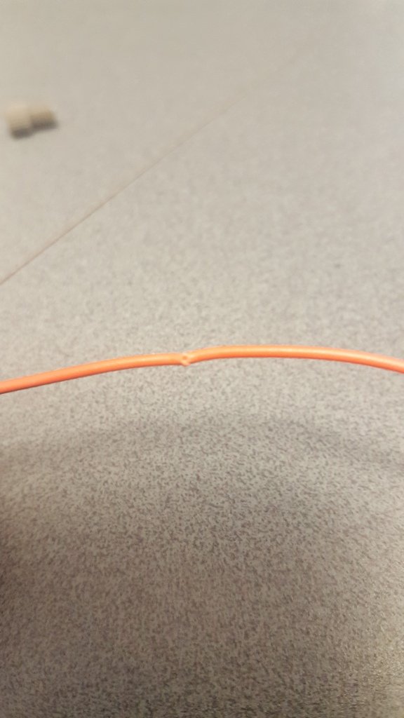

    Those quick splice connectors are crap so you're not missing out on anything. A couple here have used posi-taps. You'd need 7 of them and they're pricey at about $1.30-1.50/each but at least they don't completely mutilate the wire either. They also make a posi-lock to connect two wire ends together similar to how the auto-headlight wires are done but probably just as easy to twist, solder and heat-shrink those. Will still need a different method to connect to the 12V wire but you can use the method below.
    Below is a 20-22 from an assortment pack that I ordered just to check out. They also make a 24-26 which is more in line with the wire sizes but another member in the pre-order thread used the 20-22's and said they seemed to work fine.
