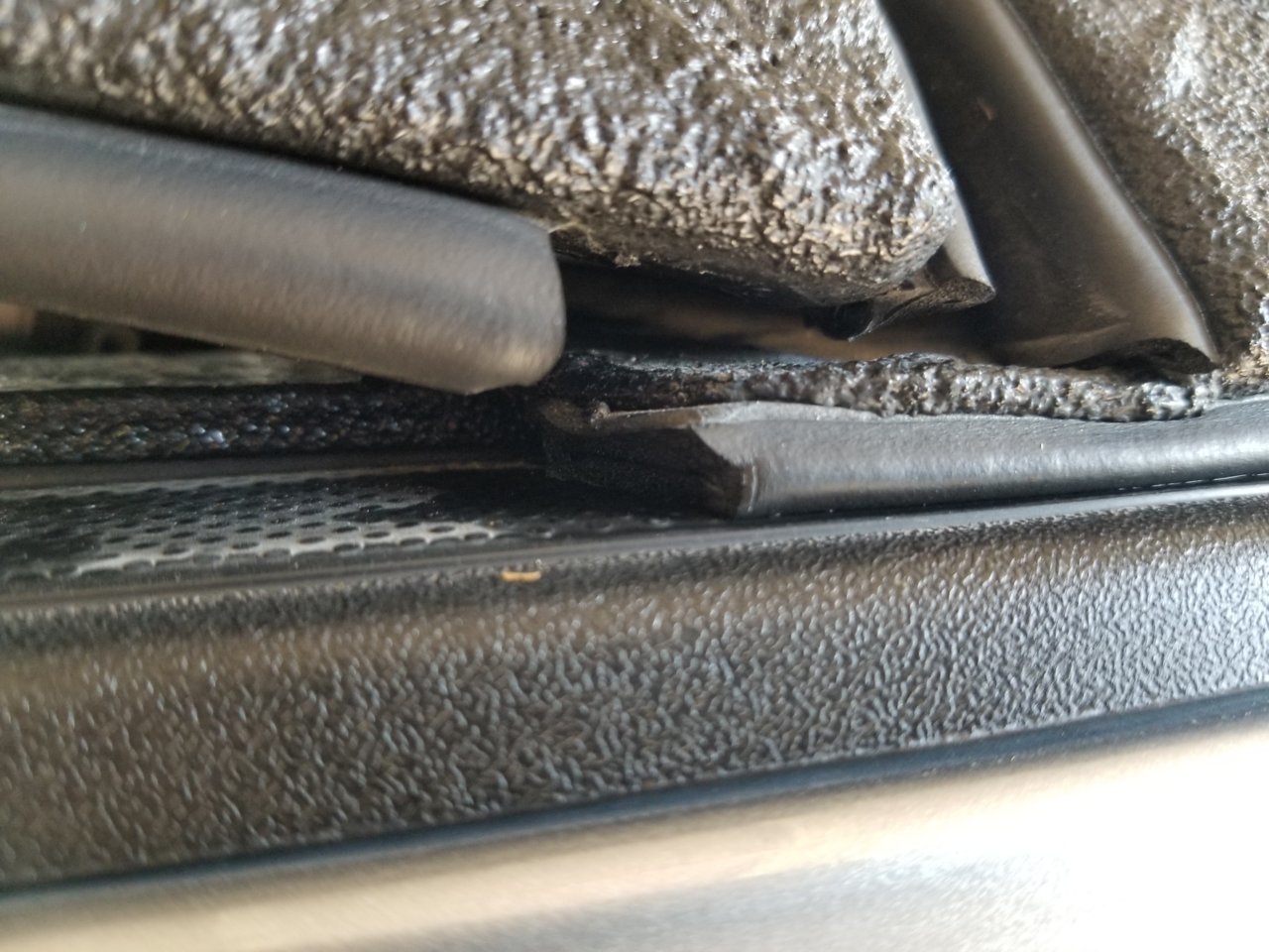

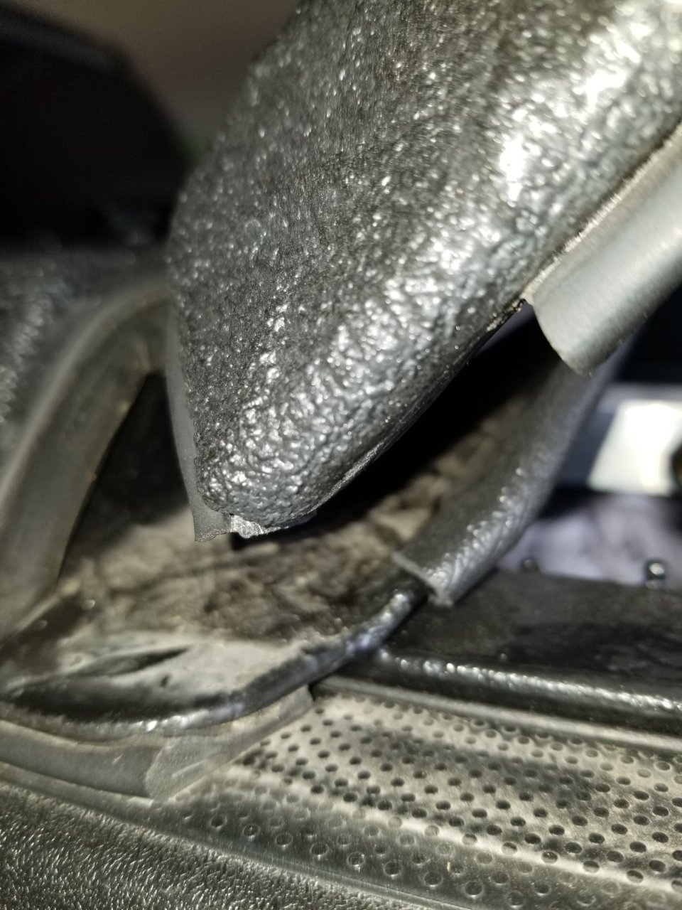

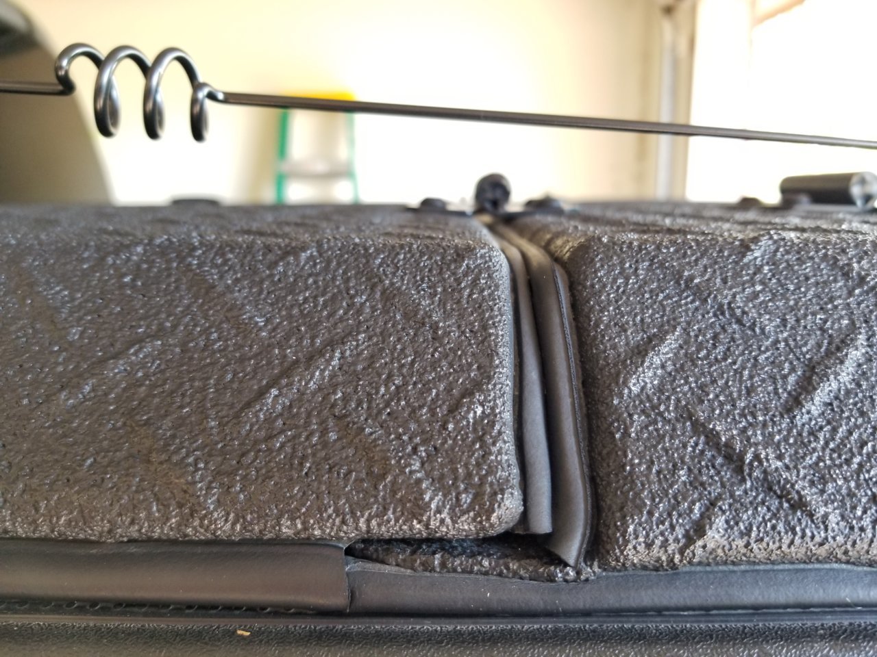

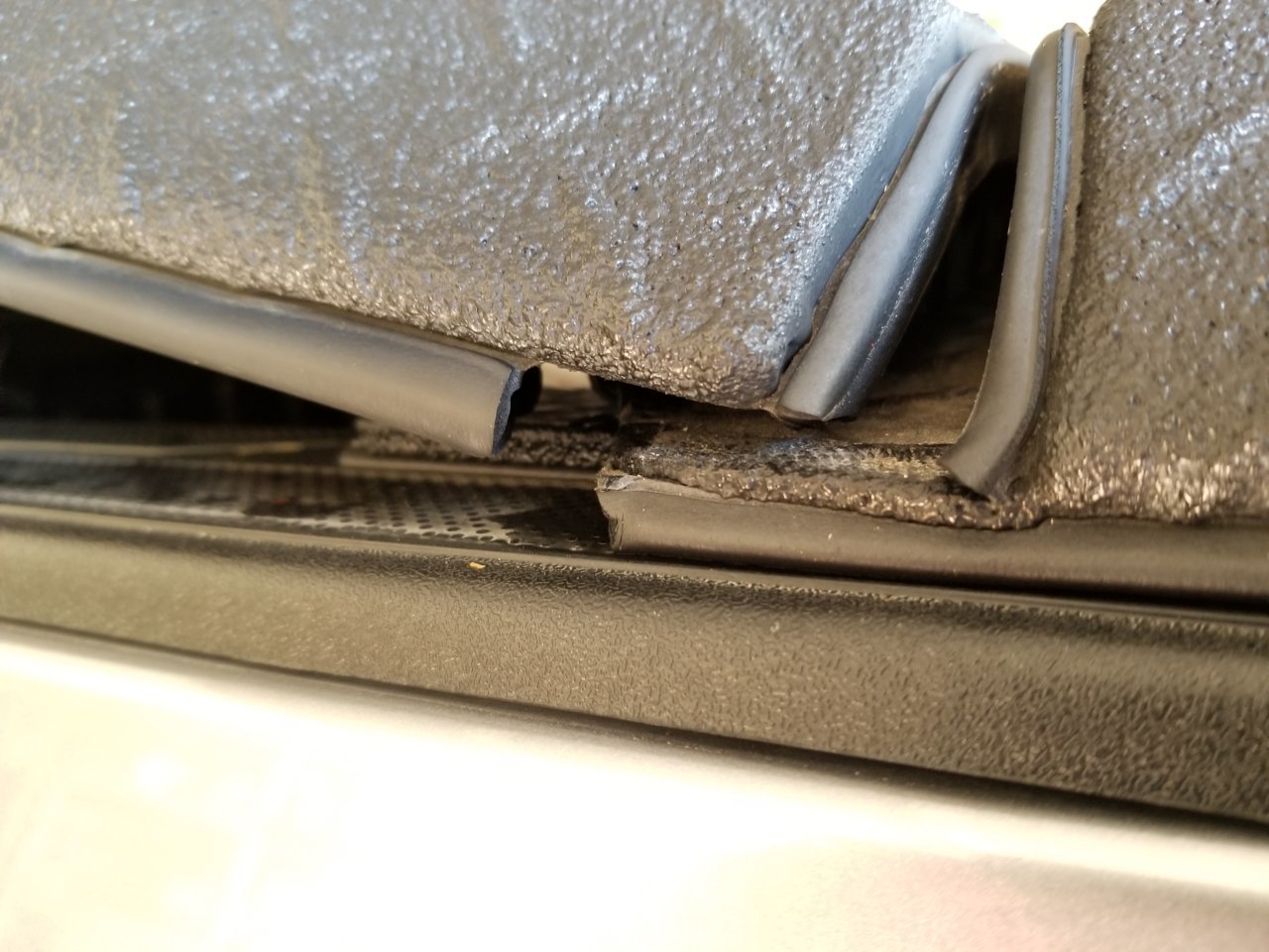

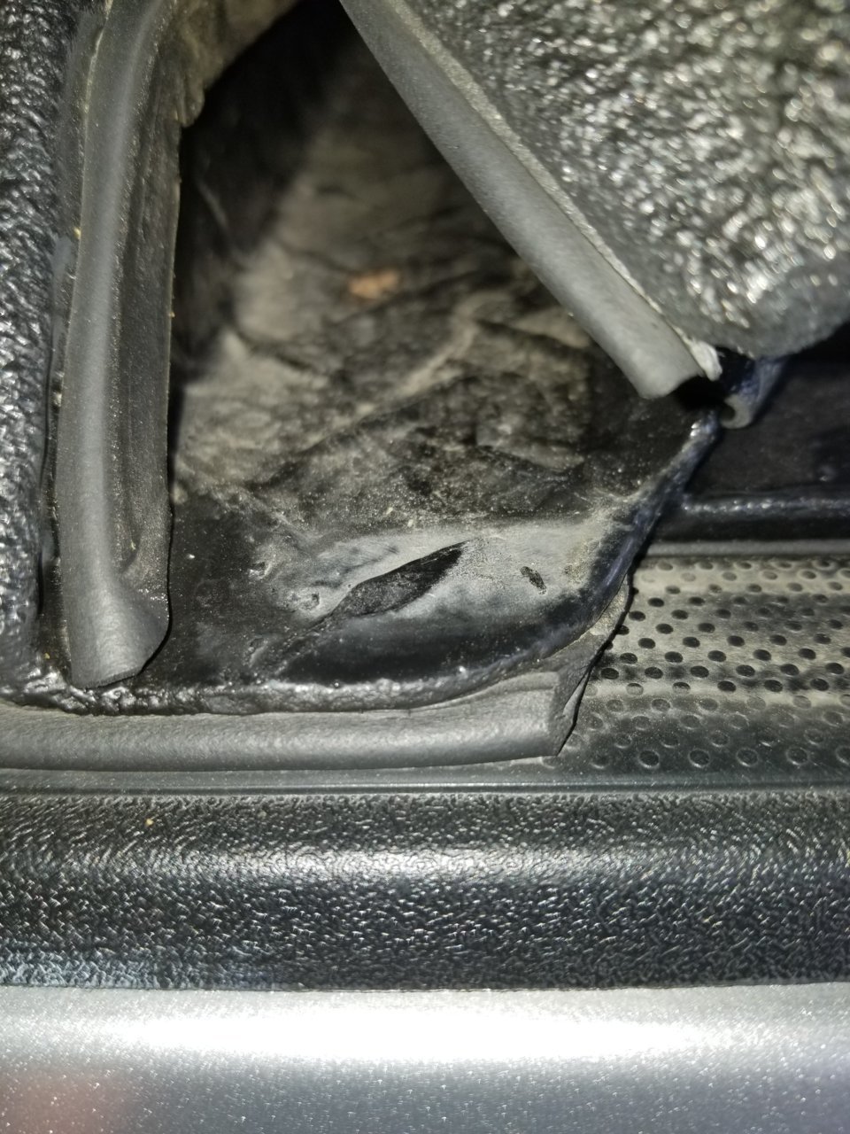

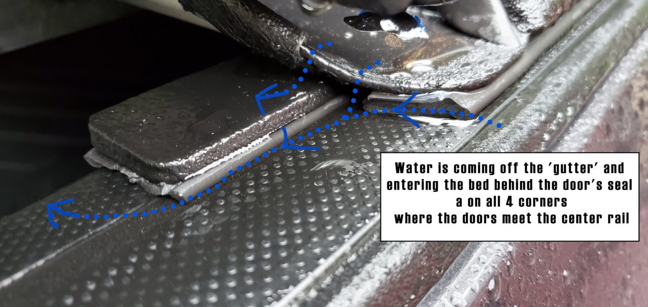

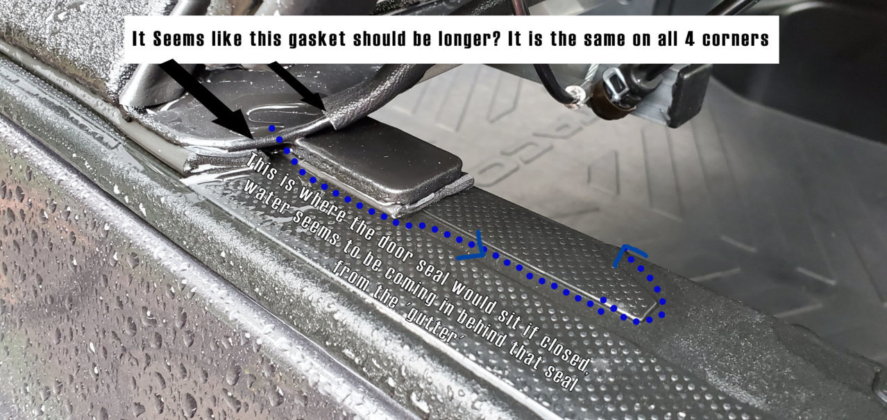

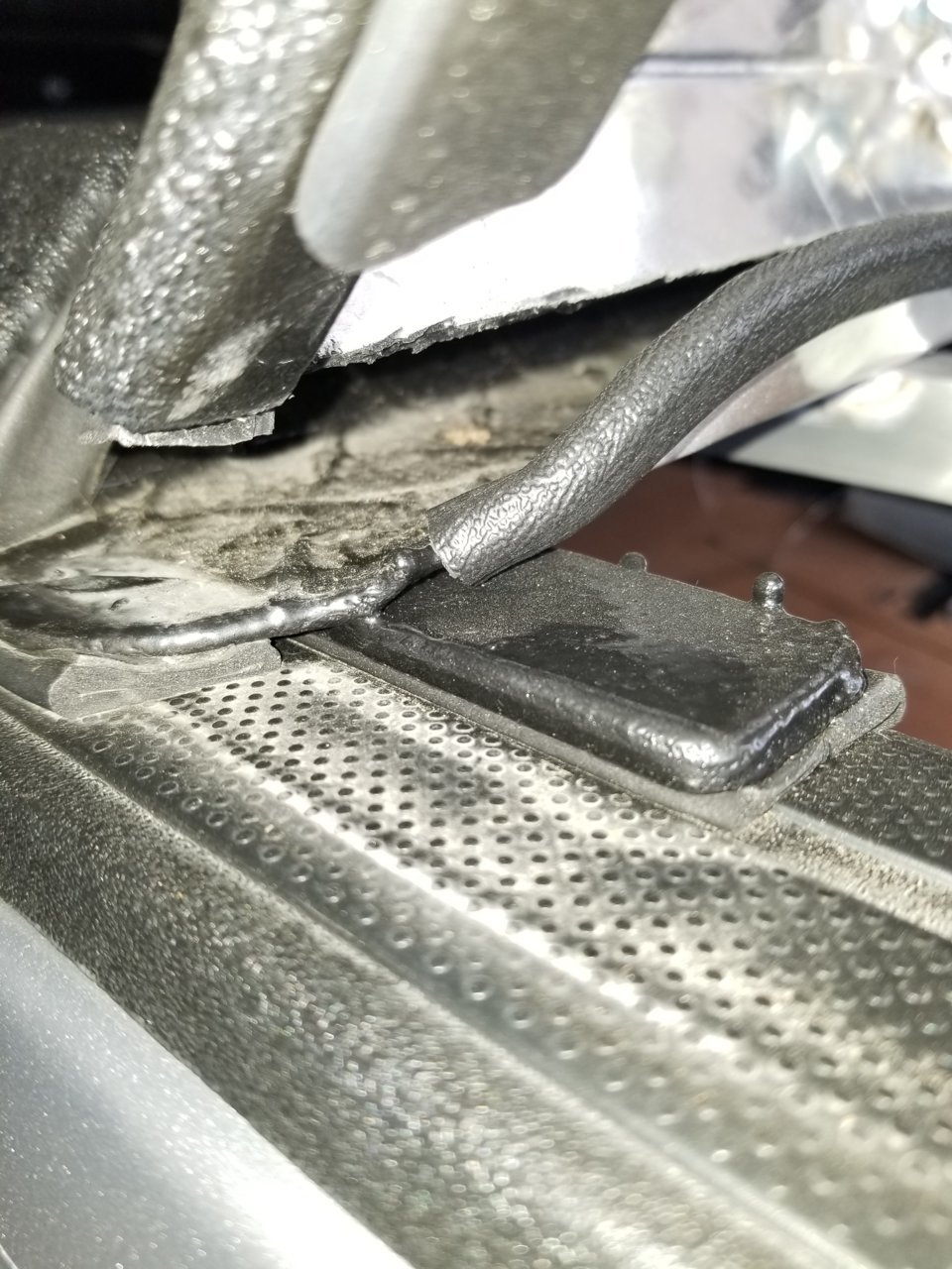

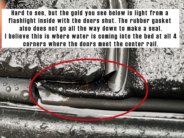

    Hi all,
    New Taco owner and even newer Diamondback cover owner.
    I was wondering if anyone out there with a Db cover could post pics of the gasket towards the end of your center rail gutter. I think mine was cut short or something. First rain after putting it on and I'm getting a lot of water in all 4 of the corners where the doors meet the center rail. Had a buddy crawl inside with a flash light, and you can see the light thru all 4 of these corners. Definitely not watertight. Seems like either a design flaw or manufacturing mistake. More info on what I think is happening in the pics....

    GOTSAND?18

    Is there a rubber gasket that goes between the cover and the bed rail ?? Or is it attached to the cover itself ?from the pics it looks like maybe the gasket is worn out or it shrank from heat ...

    The gasket between the cover and bed rail is attached to the cover. The cover is brand new, just got it and installed it last week.

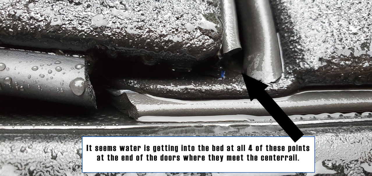

    I get water in the same spots on mine.

    Just seemed like a LOT of water. The truck hadn't moved and the rain was never heavy. The rain just seems to drain right down into that gap, and then along the rail on the inside of door seal, then into the bed. Definitely not going to be "keeping your cargo dry." as they say on the website. Once it dries up, i guess I'll try to extend the gasket on the gutter edge about another inch to force the water out and away towards the side, like it seems it should be, or try to fill in and seal that gap with weather stripping or gasket. When I saw the light thru the gap, I knew things weren't going to be waterproof. Real bummer.

    Ive never had an issue with mine other than the fwd bulkhead mismatch with the bed side rails. I just washed the truck you can see traces of water but nothing ever gets in.

    Thanks for the pics @texbaz! Any chance you can get a pic like my first one? I'd like to see that angle to see how far the edge wrap on your center panel gutter goes, and compare that area to mine. That's definitely the weak/unsealed spot where the water is coming in for me. Either the seal on the door isn't going flush with the seal on the center panel when it shuts, or there should maybe be more of a lip on that gutter edge or that edge wrap should be about an inch longer to guide the water out towards the side more and not send the water down behind the door's seal when its closed. Thank again!

    Quick update - I sent the pics to DB, and they are sending new panel gaskets, the big ones that attach to the swing up doors. They said they looked a little short, but the gutter lip seal (where I think/thought the water is coming in) looked to be correctly sized. I think I'm going to add some weather strip bits to extend that gutter lip to the outside edge. While I'm still not excited my brand new cover leaks as bad as it does, I can say their customer service has been pretty great, so far. Hopefully the new panel gaskets fix my issue. I'll keep ya'll updated...

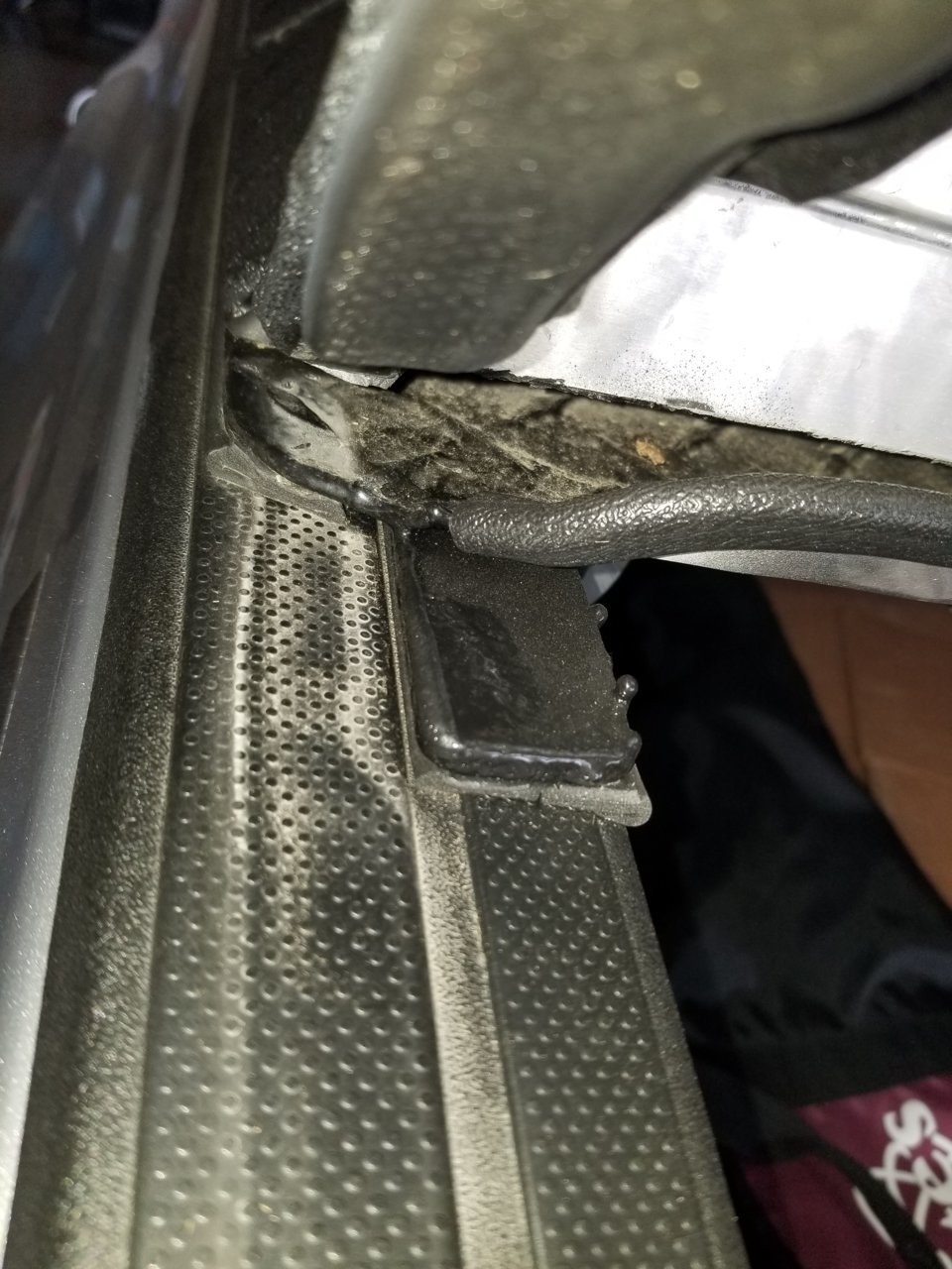

    Also, an update to my leak issue at all 4 corners where the center panel meets the door panels. Spoke to DB and they said it looked like the panel gaskets were cut too short when manufactured. They sent me new gaskets and refunded me $100. They said 'just follow the instructions in the user manual' to replace the gaskets. Well, I tackled the job this past weekend. It was no easy task, 20 minutes (per the user manual) my a$$! lol When peeling the old gasket off, the rubber breaks away from the sticky adhesive strip and so there is hot mess of uneven goo and rubber left on the panel, which has to be completely removed to ensure the new gasket sticks. Mind you, I've never done anything like this before. It took 4-5 hours of scraping and a ton of Goo Gone to get it all cleaned off....sticking the new gasket on was fairly easy, maybe that's the 20 minute job lol.....cutting the ends so they seal, but don't buckle has been a nerve racking experience. Of course i didn't want to risk cutting them too short again, and getting the angle correct so it seals but doesn't buckle and create gaps between the gasket and bed rail was tough. I'm still not 100% confident in what i did, as i still can see light through all 4 corners....and I really hope i just didn't make it worse by attempting this. I'll know more in a few days once the Zeta storm comes thru here....but my guess, since i can still see light through the corners is that all that work was for naught....i really hope I'm wrong...for what this thing cost and what I have had to do right out of the gate, I am still not very happy with my rather expensive non-water tight cover. YMMV.

    @texbaz - honestly, i really didn't want to know how it was gonna go and just needed to step away from the project for a day or 2. Looks like I'll be using a hose this weekend, because it still leaks....in thew same places....even with the new gasket.
    @Scarab - yeah, several others have said the same, so I'm kinda stumped as to why mine leaks. From what i can tell, it is definitely coming from the corners where the center panel meets the side panels. I can see that the water is coming in on top of the bed rail on the inside of the cover at those 4 corners (no water on either end, just in the middle), so I really don't think it's coming in under the bed rail.
    So, like i said above, new gasket installed, and still the same problem. I'm going to borrow a snake cam from work this weekend, do a hose test, and see if i can pinpoint where the water is coming from. With the panels closed, I can 100% still see clear thru down the gutter to the other side with my flash light test. I'll post pics of that too.
