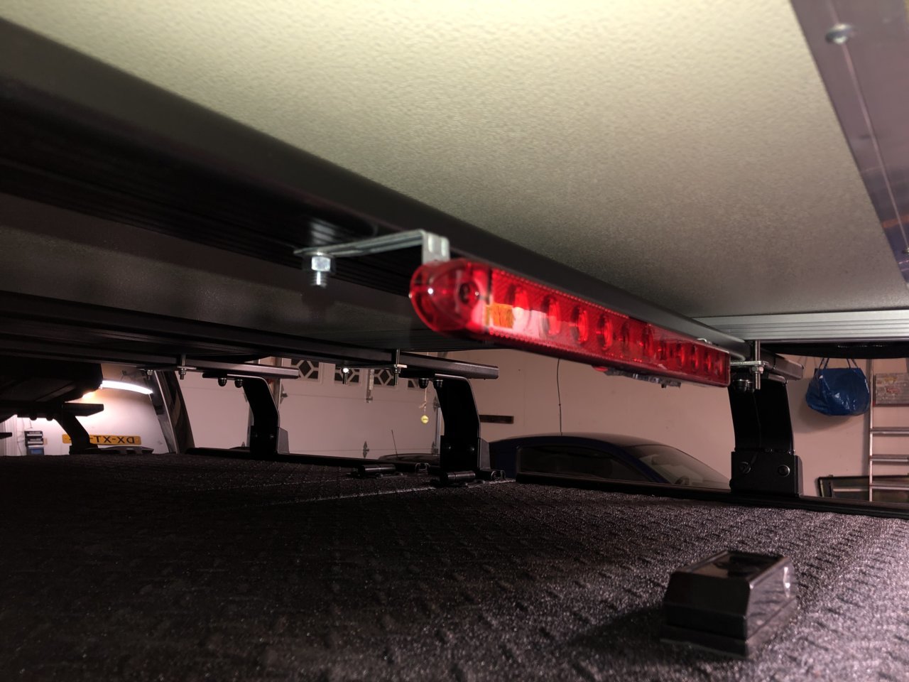

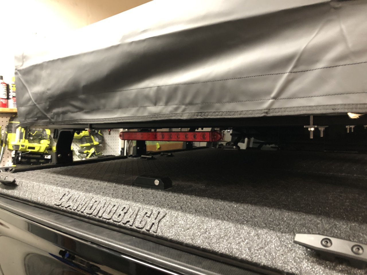

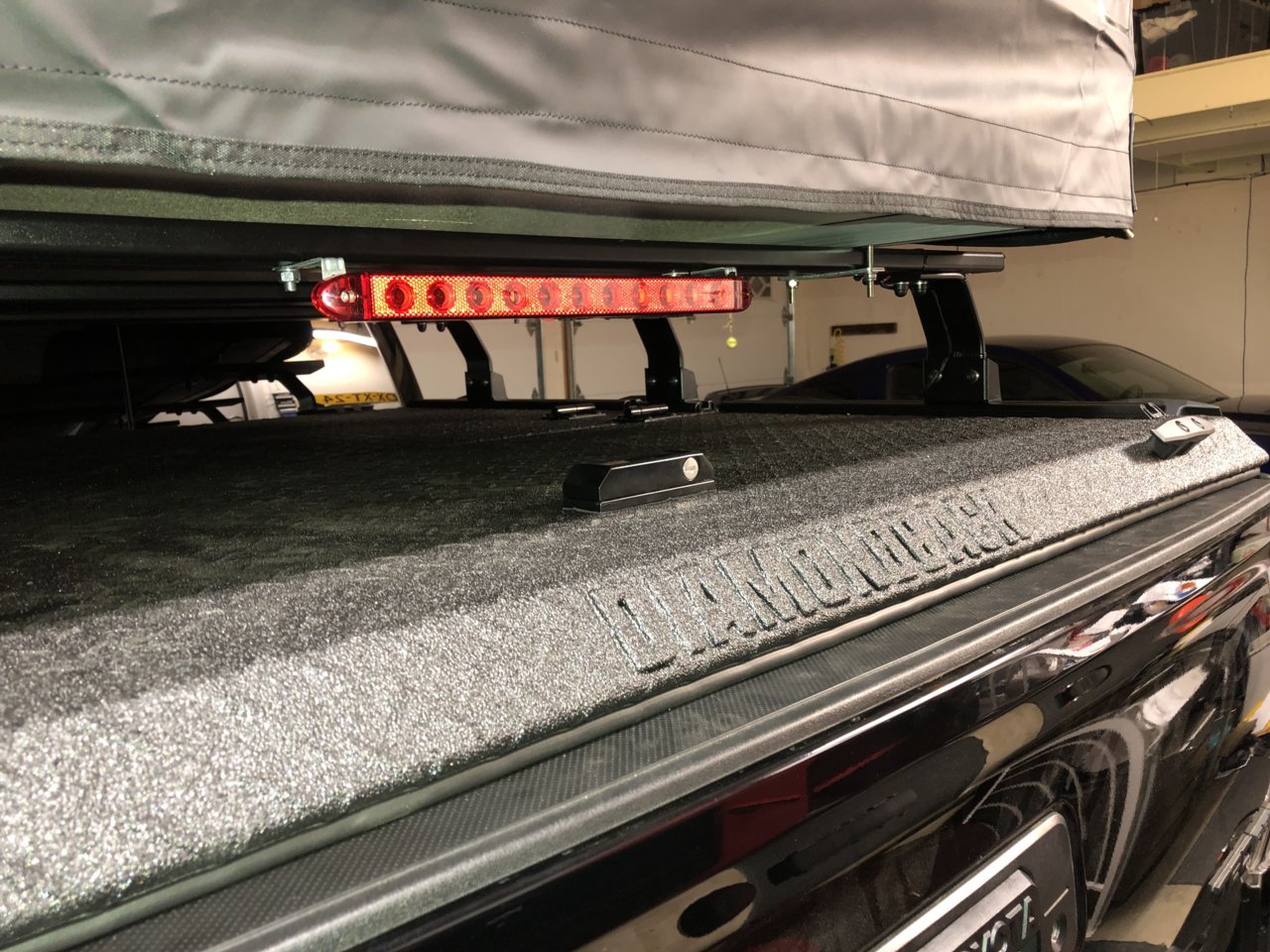

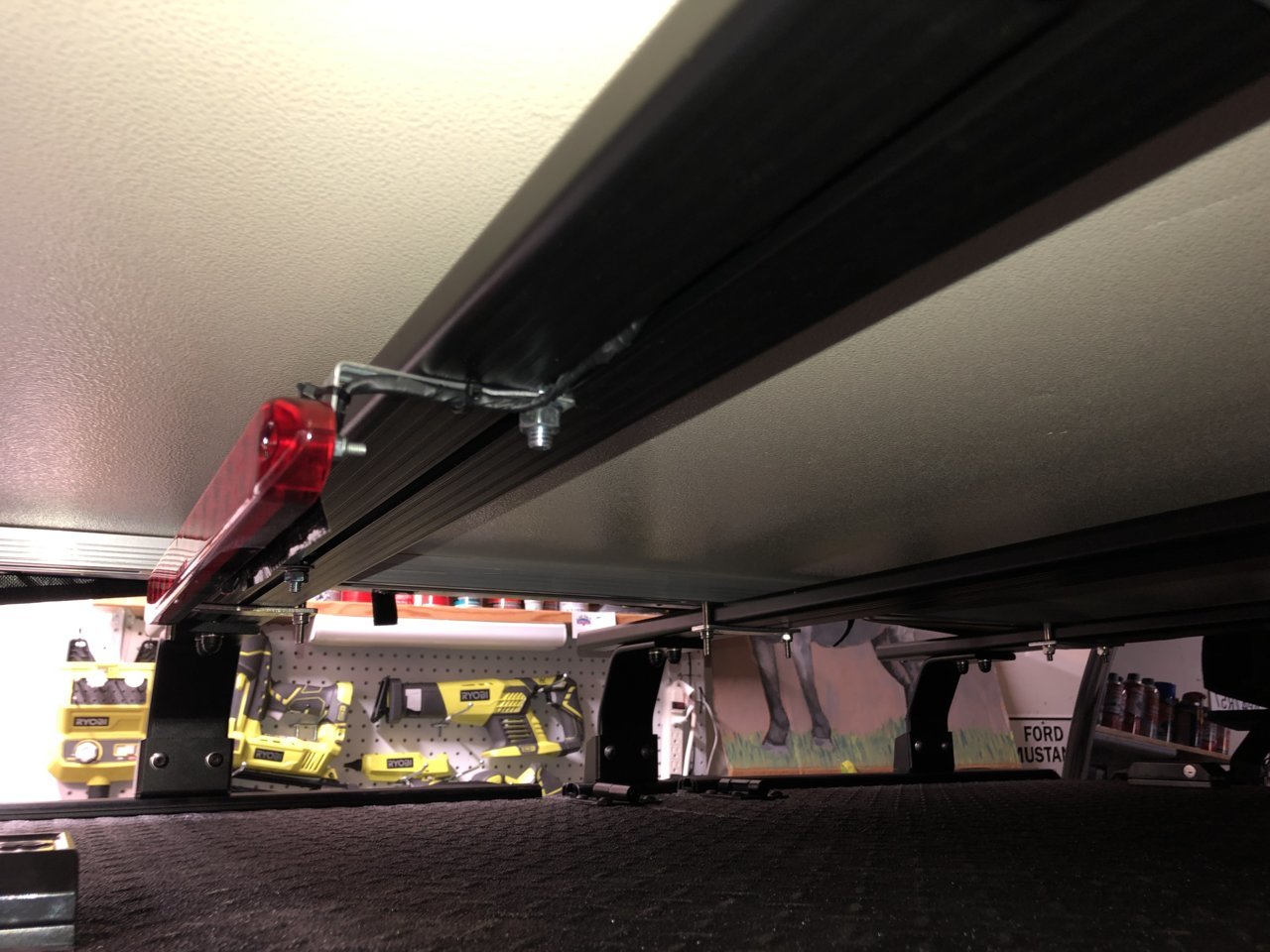

    Thanks for all the suggestions and links for an additional brake light
    for use with the RTT. They were inspiring enough to get me going. It was also very helpful to know how the wiring works. Just in case anyone else wants to know: “Run 2 wires across and down to either rear tail light assembly. Tap the ground (black) wire from the new light into the white/black wire on your truck. Tap the red (stop/full brightness) wire from the new light into the LT BLUE (driver side) or BLUE (passenger side) wire behind your tail light.”
    As I have been spending a lot of money on this truck in a short time, I needed to do the additional brake light on a budget. I think it worked out ok. It is this one on Amazon: https://www.amazon.com/dp/B07646BHVC/ref=cm_sw_r_oth_tai_BMBEDbCEG4YRW
    I used some brackets that I already had (I think some left over from an Ikea closet or something), and some M8 bolts, which slide into the FrontRunner load bar.
    I ran the wiring to the passenger side brake light and tapped into those wires. Ran the wire into the box in the bed (next to the 110V outlet). No drilling required, there are plenty of holes to run the wires through. In the box, I cut the wire and have a connector in between, so I can detach it when needed. A small hole through the rail of the front runner rail and the bed, and that was it.
