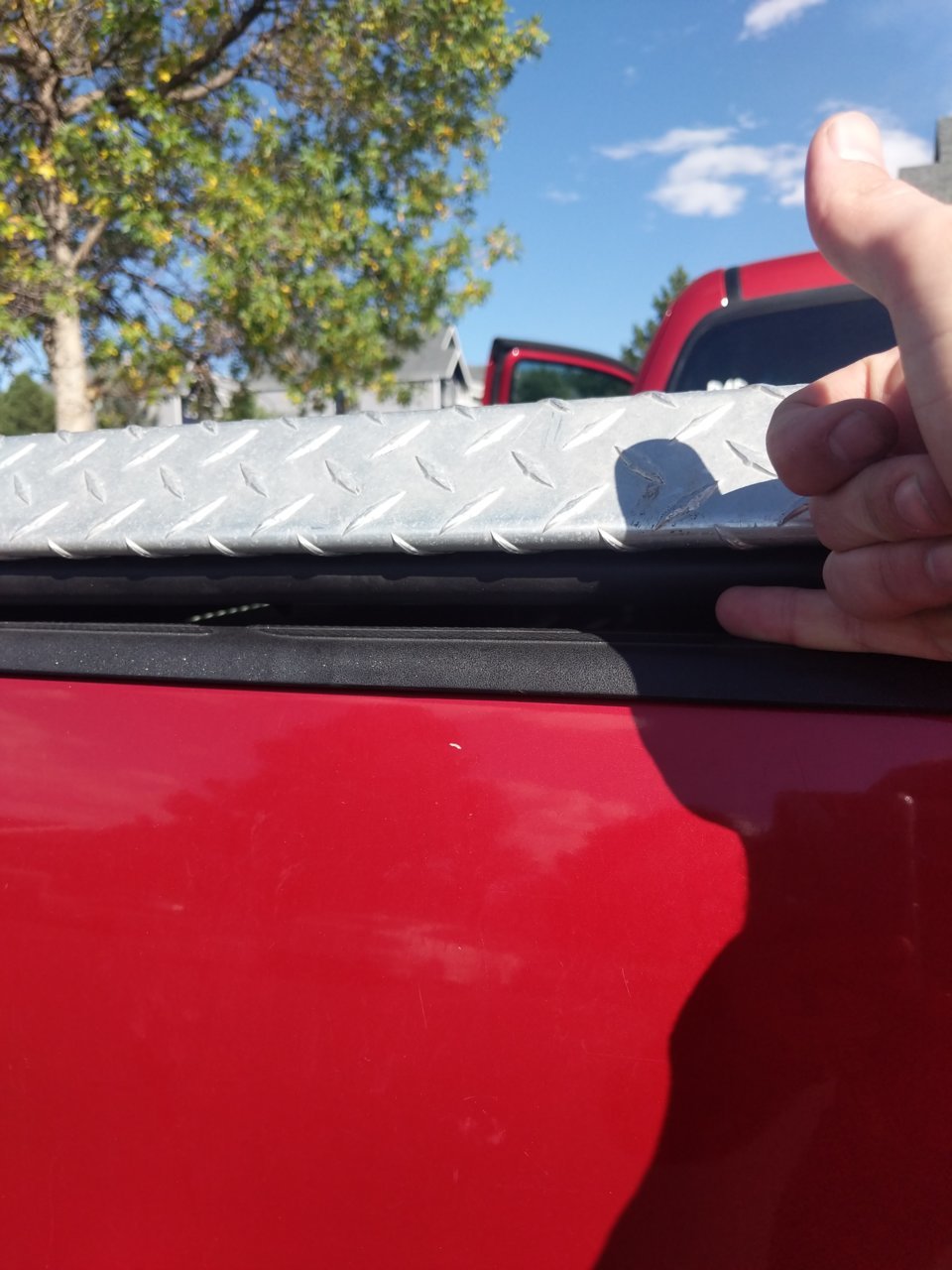

    What is the special engineering on the 05-15 Tacoma models? Is that just for newer Diamondbacks or has it been that way from the beginning?
    I have an older model that I bought secondhand and there is a gap between the top of the tailgate and the seal of the Diamondback.

    On mine, there should be a small strip of diamond plate metal running the length of the diamondback cover on the back. It is tacked on. when closed the cover rests on the tailgate.

    Ah, mine doesn't have that...

    On 3rd gen Tacomas, the bedrails, bulkhead and tailgate are in the same plane. On 2nd gen Tacomas, the bulkhead and tailgate leave significant gaps. We make up for these gaps by welding additional material onto covers built for 2nd gen Tacomas. If these parts aren't present on your cover, it's likely that your cover was originally purchased for a different vehicle, or the parts were stripped off for installation on another vehicle.

    I figured. I bought it secondhand being led to believe it was for a 2nd gen Tacoma. I had a couple different interactions with customer support where I think one guy confirmed it was for 2nd gen and another said otherwise based on the serial #. Google has since gotten rid of the emails so I can't confirm or point fingers. It's been working fine for me though, I don't think I need a super tight seal. I just keep a toolbox in there so I'm not super worried about it being water tight.

    Are these gaps too big for a simple adhesive weatherstrip to close up?

    I used the weather stripping I purchased from Diamondback. It more than filled up the gap. I have never had rain or hose water penetrate the area.
