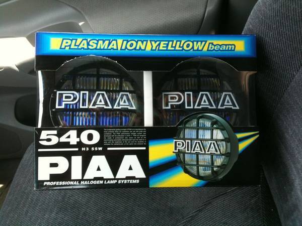

    Got these today
    Also got my Leer RCC Commercial canopy installed , new pics in the OP

    When I got my aluminum bumper from Eric @ Relentless Fabrications , he needed to substitute a 5" ID tube for the foglights for the standard 4" tube used on the steel bumpers .
    This gave me the option of using the 5" PIAA 540 series Plasma Ion foglights rather than the 4" PIAA 510's .
    My lights finally arrived , and when they did , I found that they were slightly too big to fit in the tube , so I decided to use a router to make a bit of clearance room so that the lights wouldn't be in contact with the bumper . I managed to get some time to do this today .
    Covers removed
    They just don't quite fit
    Scalpel
    The full tube posed some problems for the router base to ride on because the light mounting tab
    was a bit higher than the edge of the tube
    I rigged up a temporary base that was notched over the tab to give a flat surface for the router
    I changed the top bearing to get the bit to remove 1/16" of material
    I sanded the rough edges with some 120 and then 240 grit
    It now fits down to the lens side screws and has almost a 1/16" of clearance all the way around
    Test fit
    Test fit , pat myself on the back , ready for paint and install
