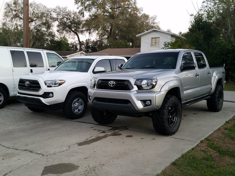

    Just to add pictures to the thread. 305/65/17 on 2.5 inches of lift20170226_183244.jpg

    Wow mean! How's the rubbing? Body mount chop yet?

    Did the cab mount yes. Trimmed the flaps into little half pointless things but they don't throw a lot of rocks anyway. I guess the flaps I have left do a little bit of keeping stuff off the paint . And I had to trim and pull back some of the plastics in the front wheel well. The back at hard, hard full flex it was rubbing the flares so I had to trim the inside of the wheel well as well. I am not easy on my truck when I'm in the dirt whatsoever so if your daily driving it you probably would have to do as much

    I knew I should have gone with that size tire. I played it safe and went with the 285/70/17's any regrets? any major rubbing? shit looks sweet though nice work my friend.

    Thanks. All my rubbing got cut away after my last wheeling trip on my rear fender flares, see a couple posts back, trimmed and moved a bunch of plastics . Gas mileage was the only real regret. I now have a set of falcon wildpeaks for my non offroad- road trips just to save on gas. And in high speed sand it floats a bit to easy with this wide of a tire. Haven't come close to getting stuck yet though
