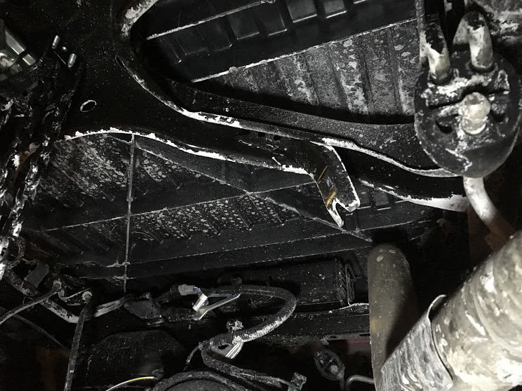

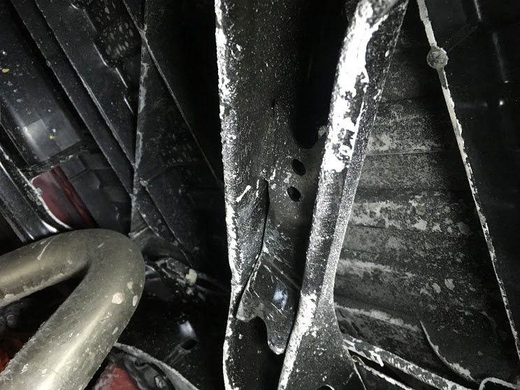

    There have been multiple people asking about largest tires to fit whichever model, etc, etc, etc. Here is a new one, which I have not seen anywhere.

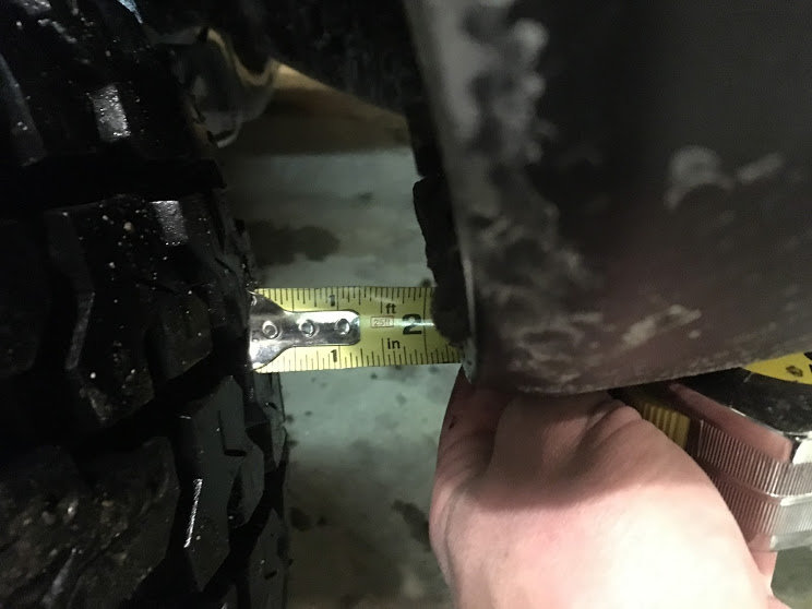

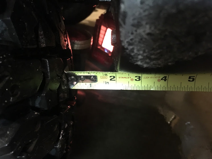

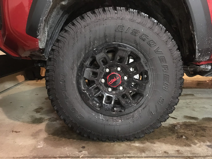

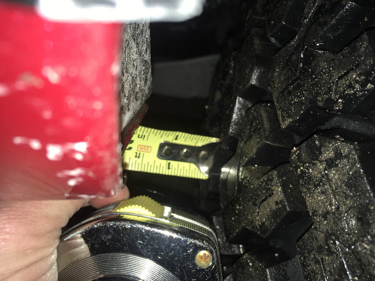

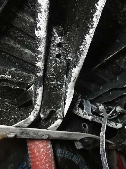

    I have a straight stock 2017 TRD Pro. On Monday I got a set of five Cooper Discoverer ST 255/85r16. Based on calculations, it is 33.1" tall. Actual measurement mounted, but not weight bearing, it was 33". Bearing the vehicle weight it's about 32.5". I don't know the tire pressure right now.

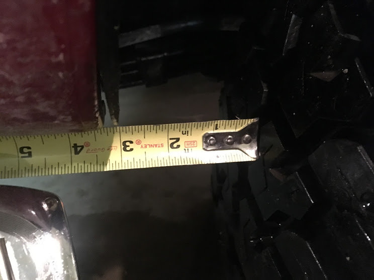

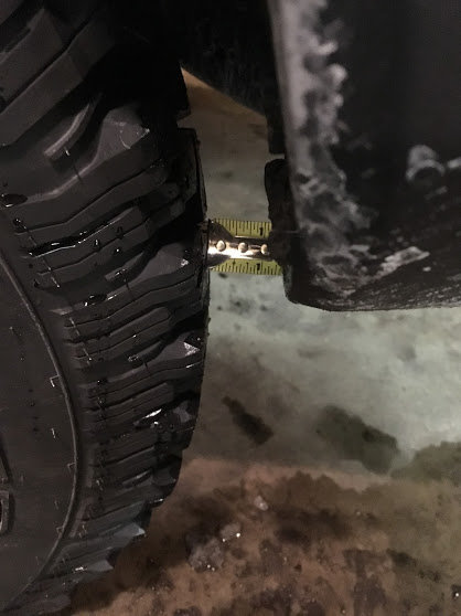

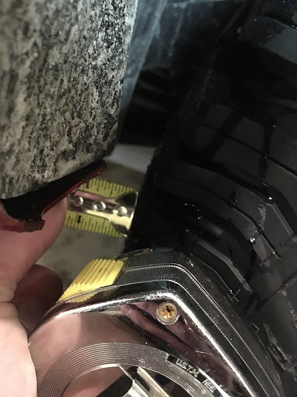

    There has been no interference with the UCA, I will attach some rough photos. Also, the straight ahead clearances of the front leading is 1.75" and trailing front a hair over 2"". The closest the leading edge of the front tire comes on a flat turn is a little under 1". The closest the trailing edge of the front tire comes on a flat turn is a hair over 1". The rear tire has a leading 3" and trailing 2" clearance. These could all be increased by remolding the liners or trimming.
    After a week, I have had no rub. I have not been offroad, but I live in a unique location and my driveway and access roads require some fairly extreme off camber turns that lead into steep ascents. This means that I do flex quite a bit, but I do not max it out. Still, with these turns and angles, no rubbing so far.

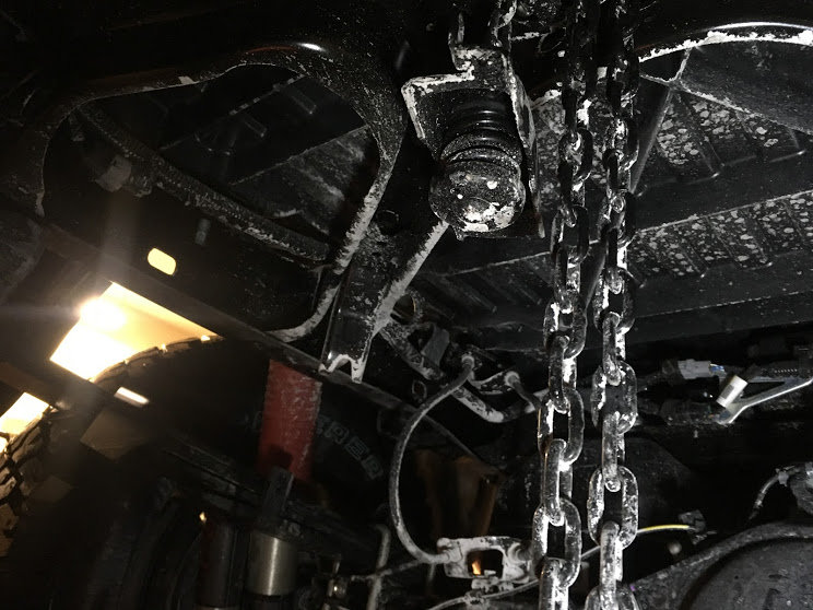

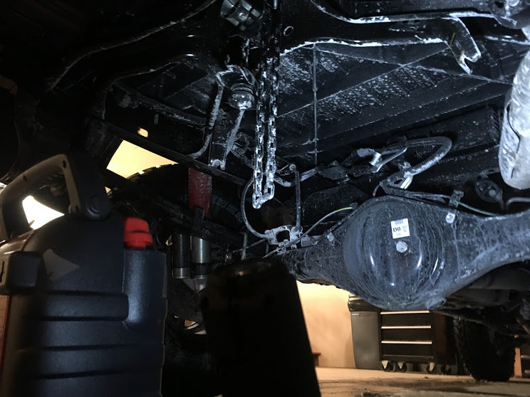

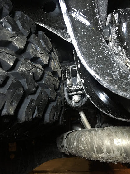

    A common problem with 255/85 and 285/75 on 16" wheels, is mounting the spare. I took a lesson from the second generation guys. The spare 255/85r16 will hit the exhaust pipe, which is not good.
    I took some measurements and felt that if I could get the standoffs flat, I could get the stock spare carrier to work without relocation. So, I got a big hammer out and flattened the standoffs. I was actually really surprised and even a bit disappointed at how soft the metal was. If the frame is made of the same materials, there are going to be a lot of bent frames out there.
    Once the standoffs were flat, I greased the hoist chain and installed a small lock (really well greased) on the spare fitting at the end of the chain. As I raised the hoist, I had to pull back and a little to the left to get the tire away from the exhaust as possible. I'll drive around next week and recheck to see if it shifts. If it gets closer to the exhaust, I'll tether it to the left.
    All in all, I love the combination of 255s with the Pro. I love the look, I love the traction in snow, and I love the way that this all came together without any significant modifications.
    Any questions, just ask. Here come the pictures.

    Very nice. I wonder if a stock Off Road will be able to fit the tire size as well as the TRD Pro. Isn't the TRD Pro slightly lifted as compared to an Off Road or Sport model? Anyone try this tire size on a stock non-Pro 3rd gen?

    The pro is supposed to be one inch higher up front than the non-pros, but the back is the same. Also the pro wheels are supposed to be set out a half inch on each side, for a one inch wider track. Will this be enough to make a difference? I think so. However, could you mitigate those differences with some trimming or liner remolding? I think you could. It just depends on how much you are willing to do to it.
    When I made the decision on these tires, I had already decided to trim plastic, heat mold the liners, and comic if necessary. However, I haven't needed to do any of that at this point.
