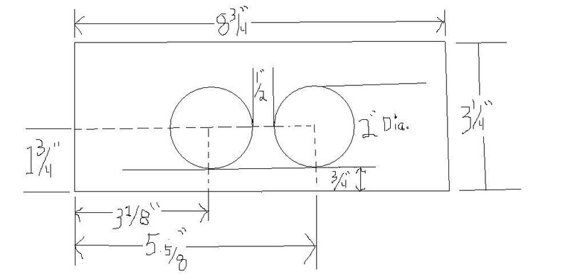

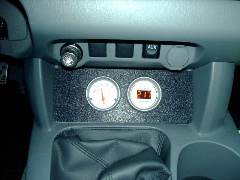

    I was thinking of using a pillar gauge pod for my 2 gauges but decided I'm cheap and did something else. I have a pillar pod in my Z but the lights are a bit overpowering at night (kinda in your face too much), so decided to do something different with the truck.
    Went to Tap Plastics with my sketch and had them make this for 11 bucks. I could have done it myself if I had a table saw and big enough drill but way easier to just have them make it up. There is a gap at the top, so that if I need to I can use an allen wrench to pop it off if I need to get to the gauges. It's just held in place with red 3M tape on the bottom and the 2 edges. I will probably get some kind of finishing rubber trim stuff so it looks cleaner around all the edges and hides the gap at the top. I had the length made a little longer, so I could finish sand it to the correct length and round the corners, plus there is a slight taper top to bottom.
    I used a standard mini "add a circuit" fuse so it's all hard wired. Yes the standard mini add a circuit works perfectlly fine with our mini 'short' fuse blocks, with zero issues. I used a port in the fuse block where the coin holder is. Ran the sending wires through the firewall on the drivers side.
    If you redo the sketch, you can fit three 2-1/16" gauges in the panel. originally I had them make up one with 1 hole in the center but then decided to add a digital temp gauge along with the volt meter. Kinda wish I had gotten both digital but I'm ok with it. besides they ain't cheap but the volt gauge was only $45. The dig gauge was like $90, plus 5/8" hose adapter $35 or so, the sheet adds up fast. I used the Autometer 5/8" hose adapter and tapped into the upper hose that goes to the heater core next to the firewall, since it is noticably hotter than the bottom hose, I could only asume it was the ingoing line (hotter from engine block) and the bottom cooler hose was the return line.
    They are both wired as of now to be in night mod, so the dig gauge is dimmer and the light to the volt gauge is always on. When I get my hard wire cord for my radar detector, I'm going to wire the gauges to come on with the headlights.
    Maybe later, I will order the angled Autometer trim rings to finsih the whole look and get the gauges angled more towards me.

    Looks really nice, maybe since you have figured it out, you should get a piece of aluminum and do it nicely by paint matching the color of your truck, or CF. But still nice to have the extra gauges. Nice though.

    That's pretty good thinking- I know those gauge pods are no cheap part.
