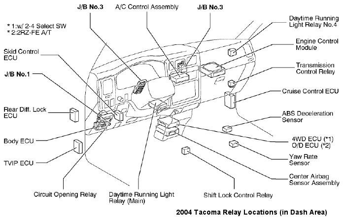

    Have you yet determined if there is a "DRL Relay (main)" installed under the dash below the ignition switch, as shown here? If it's there, it should be possible to get it functioning. That's where the infamous white/green wire is. I just disconnected mine a couple days ago (didn't cut it though, so it can be reconnected easily - if you are lucky perhaps this was done with yours).
