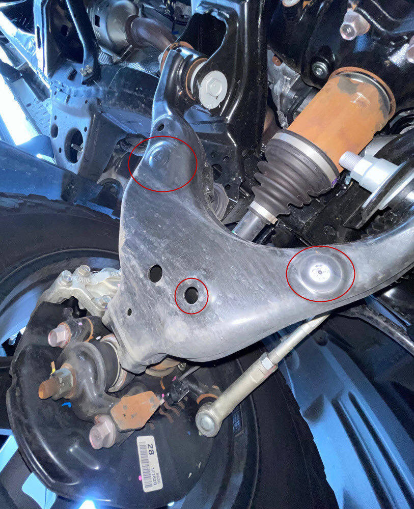

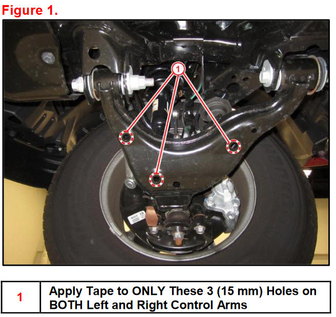

    Just checked, looks like 2 of the 3 areas on the TSB are plugged from the factory. TSB: https://static.nhtsa.gov/odi/tsbs/2016/MC-10134062-9999.pdf
    TSB Image:
    2021 Sport:
    Sparky777 likes this.

    I do have a 2020 but mine are wide open and I hear the noise everyday. I do a lot of driving between 30-45 mph. I have never been concerned about it because I know what it is. I did have a 2016 before with the same noise and had the TSB performed back than to get rid of noise. I guess back than I just did not believe the dealer (and TSB) was correct about the problem so I had them do it and the whistle/howl went away.
