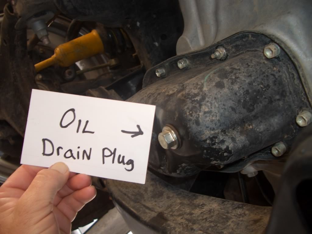

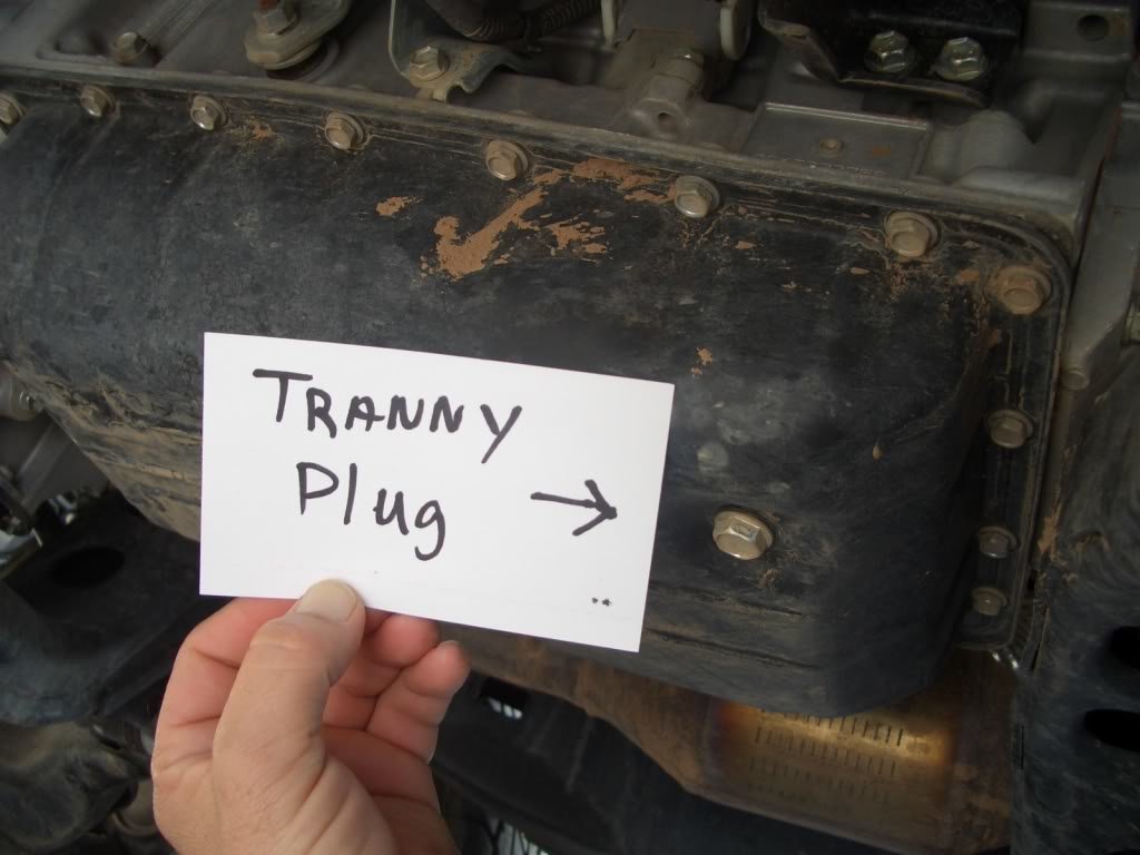

    Here's a pic from a thread : The trans is long and retangular . The oil pain is smaller and oval and sits to the front of the trans and crossmember with a small hump and one bolt.

    Son of a bitch. I just looked again. One small pan but 2 plugs. One tucked away on the passenger side. FML. Didn't say any thing about this in the manual.

    Yep, 2 plugs is the transmission..Drain the oil to the right level and tow it to a shop or dealer. Just make sure if local shop that they have worked on Tacomas before with the sealed transmission. Hopefully no damage was done.
