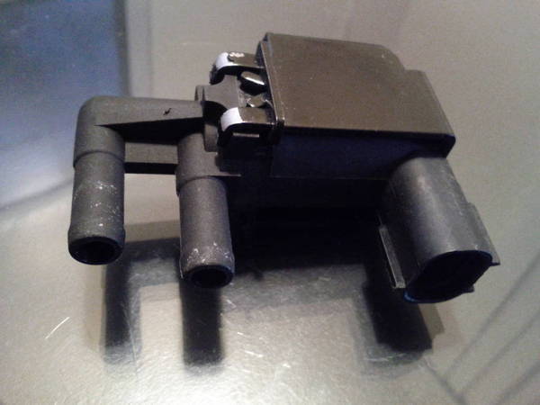

    So in order to pinpoint my Emissions CEL's I checked the VSV's behind the battery a few days ago w/ a 9v battery and some leads, one clicked, the other didn't. So it seemed simple enough to me that all i needed to do was replace it and I'd be on my way. Well, after much searching I couldn't find anything by either of the numbers on the part
    25860-75230
    101362-2200
    So after much more searching I finally settled on the Dorman 911-603 because from what I could see on the web pics it looked closest.
    Today I finally get it in the mail from RockAuto... After opening it seems to have a slightly different mounting piece, but seems that I should still be able to make it work. So I decided to test it with my 9v battery and see what a working one of these should do... hooked it up and nothing! So...did I get a faulty part or is this part not even supposed to click open and allow airflow? Now I'm puzzled and about ready to go straight to Toyota and see what they sell me...(for probably 3x the price)

    That is a vacuum valve of some sort probably for emissions equipment. The 25860-75230 i can get you one through toyota for about $65 but you may wanna test it with a toyota factory repair manuel, not all vacumm valves are tested exactly the same. Also the other # you posted doesn't even come up so it probably is of no concern i would give toyota the #25860-75230. Good Luck

    Try using 12V form the battery. 9v is below the 10% threshold and may not cycle that particular VSV.

    Thanks for the inspection docs HilingDoner... I've been looking through the downloadable FSM but was a little confused about navigating through it all. This is exactly what I needed. AS for the battery, I was using the 9v because I was afraid the car battery would fry it... but if you guys think it will work i'll power it straight off of that for the test.
