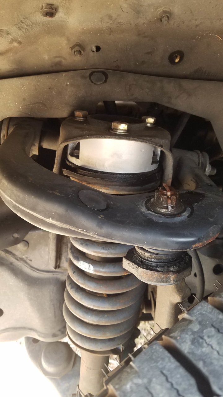

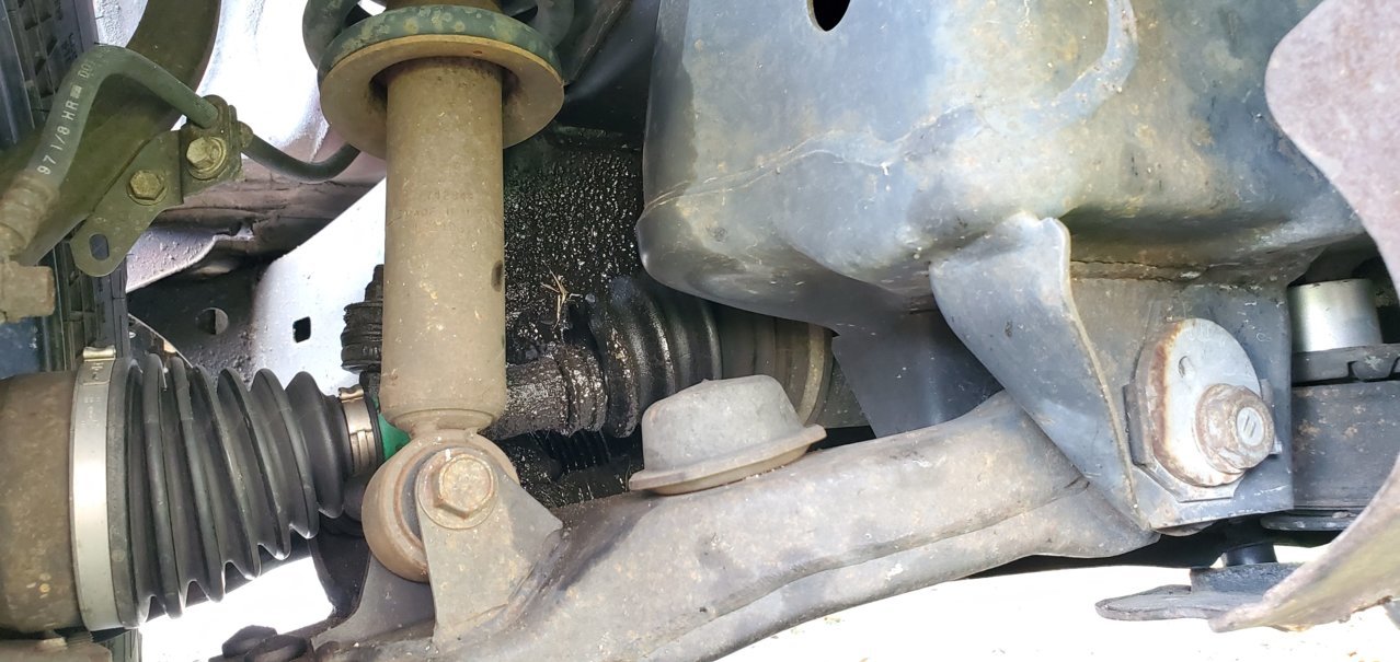

    So I went with a 3" spacer lift before I joined TW. Now I'm thinking that lift was a bad idea. Both of the inner rubber CV axle boots recently ripped and are leaking. Should I stop driving until i get them fixed? Also, I've been reading that some 881 or 882's OME springs paired with 5100 shocks would get me the 3" lift I want to "clear" my 33's. Truck body has a V6 with 216k miles and suspension might be stock. Any advice?

    At that angle, I doubt it. Looks like they were on their way out anyway and the increased angle just finished them off. If your truck front diff is ADD, I would replace the boots ASAP. If not, I would just replace them when you desire as long as you dont lock the front hubs. If you have an ADD diff the cv axles always spin while if they are manual hubs then they do not spin at all unless you lock them for 4x4.
    You can do it yourself and it is quite simple. Just need boot kits, 1 special tool, cleaner, rags, grease, and some side cutters.

    That doesn't appear to be too bad of an angle. Typically they rip because the boot ribs touch and wear through each other. How old is your boot? Could just be from old age. Or - when your suspension flexes they ribs rub on each other. If they do - it's obvious as you will see wear marks on them. Spacer lifts are never a "good" idea per say. You do hear of quite the issues on 1st and 2nd gen Tacomas. You'd be on the right path with a proper suspension lift.
    Can you put a diff drop on your Tacoma? That will bring that down a little bit.

    I don't think that a body lift affects the CV's at all, so it's just a coincidence that your boots ripped after the lift. It is a common occurrence when people do a suspension lift though!

    I'll echo what everyone else says - angles don't look too bad. Probably just old boots. I will say - a 3" lift is a lot. If you can run it at 2" or so, your boots will be a lot happier in the long run.
    :thumbsup:
    Happy to answer questions as you go through this OP. It's a reasonably easy (though dirty) process to get everything rebooted. And the OEM kits I link there are great (and reasonably cheap).

    @Xbeaus I did have the Diff drop installed when i got the spacers installed. The picture shows it to the right. I got the truck 1 year ago, about 8k miles ago and from what I think, all the parts are factory. The previous and only owner had a new engine installed 35k miles before I bought it from him.

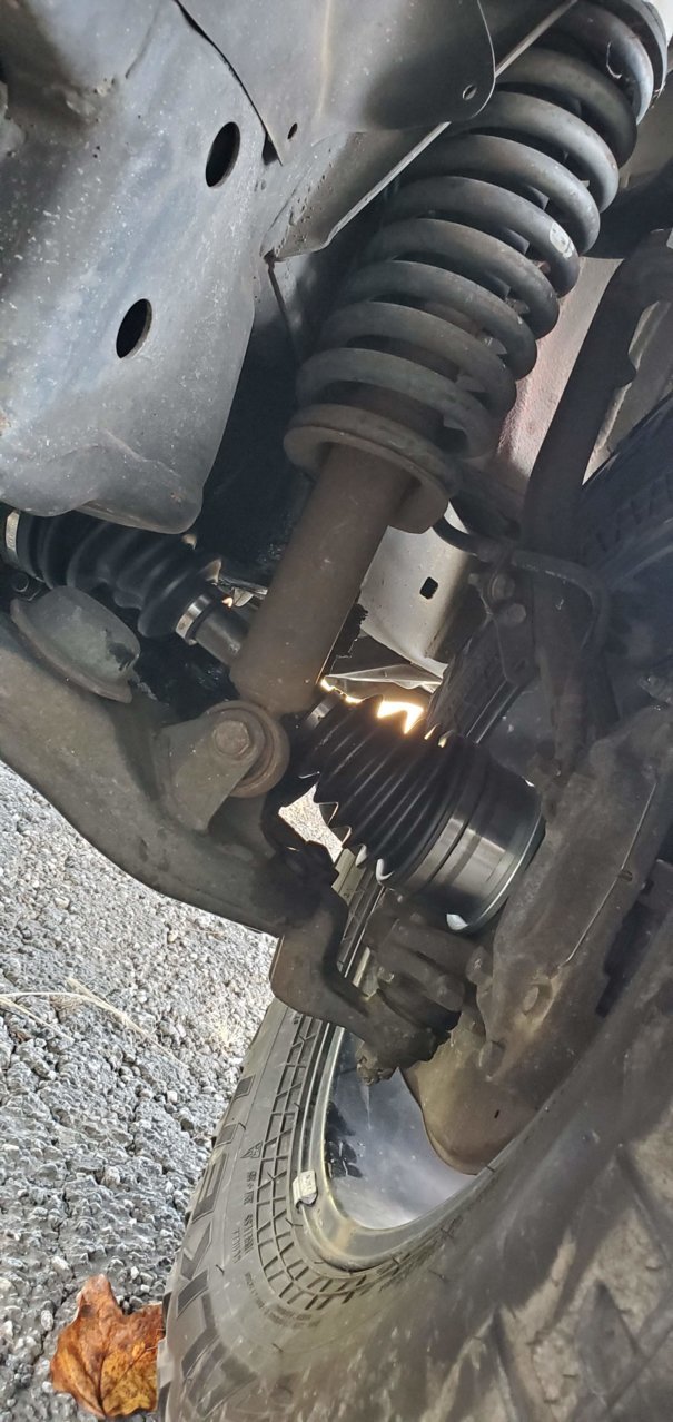

    There seems to be some confusion here, is your "spacer lift" a body lift, or a suspension lift? Your 2nd pic (post #10) doesn't look like a 3" body lift, and your suspension pic doesn't look too out of control on the CV angle.
    As others have said, that doesn't look like a bad angle, though. Here's mine with Kings set around 1.5" with a diff drop.

    Here is it. I think it's because they were just old. Funny thing is that BOTH tore around the same time. It does have the diff drop also.
    My 33's still rub but still need some plastic trimming and to bend the pinch weld a bit more.
