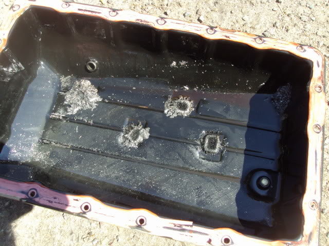

    If you want to do the work yourself, start with draining the fluid and dropping the pan.
    -If the fluid is not a cherry red its probably overdue for a change and can be why something failed (it loses its protection and lubrication properties if its too old or overheats, etc...). If it’s milky, you are a victim of the "strawberry milkshake." Rebuild or get a new trans (and a new radiator).
    -Also check your trans oil strainer (and magnets in the pan for metal shavings). If it’s clogged, it can cause those symptoms but generally its clogged do to catastrophic failure somewhere else. Probably a rebuild or buy a new trans.

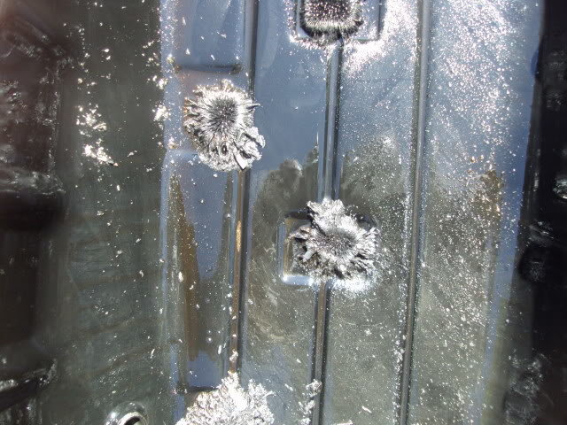

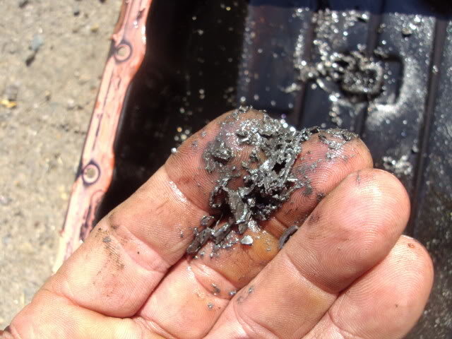

  4. Jun 5, 2014 at 11:29 AM

    Doug that looks like planetary gears crapped out on yours, converter may have sped up sped up the carnage.That is about a $2500 overhaul here in small town Louisiana. r/r included 2year 24000 mile warranty . What's that job cost in California?

    That's exactly the same noise I had with my 03 double cab with 160k miles. I just had my transmission rebuilt for about $2800 in Oakland, CA - including a new torque converter. If you have noise like this, don't wait or it may cost you more as more things will break and will need to be replaced.
