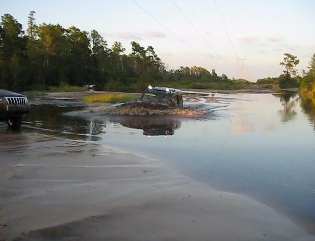

    So, I went to lunch. Truck started fine, 4wd indicator still blinking.
    Leaving lunch, started fine, 4wd indicator out, truck shifted into 4wd without issue.
    I guess I'll take apart the actuator and clean it out, WD-40 the motor, pack any potential leakage point with dielectric grease (Or RTV or something?) and run it. Motor obviously works, i imagine those contacts are dirty now.
    I know water causes issues with any truck, but I would not have expected either of those to happen. I wasn't out in a river up to the door handles or anything. I have direct comparisons in the same place doing the same sh!t. Nissan Frontier, no issues whatsoever. 2001 Land Rover Discovery was lifted and snorkeled and ONLY used to go out and mud in the same place, only I was running that thing up to the windshield in silty water and L1 Floored in mud over and over and over. Same starter after 3 years of that, no CEL, ALWAYS started/ran/shifted ect.
