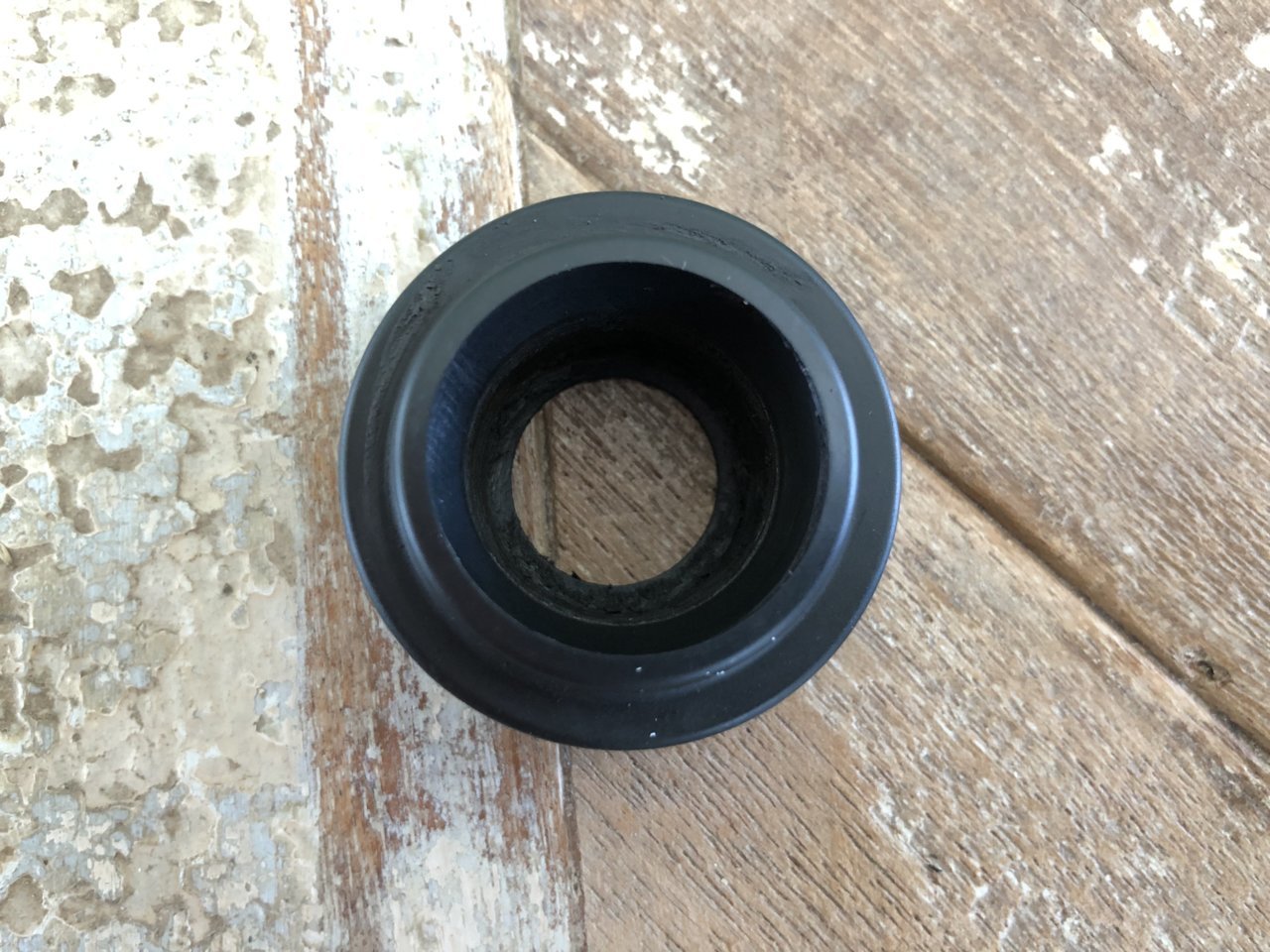

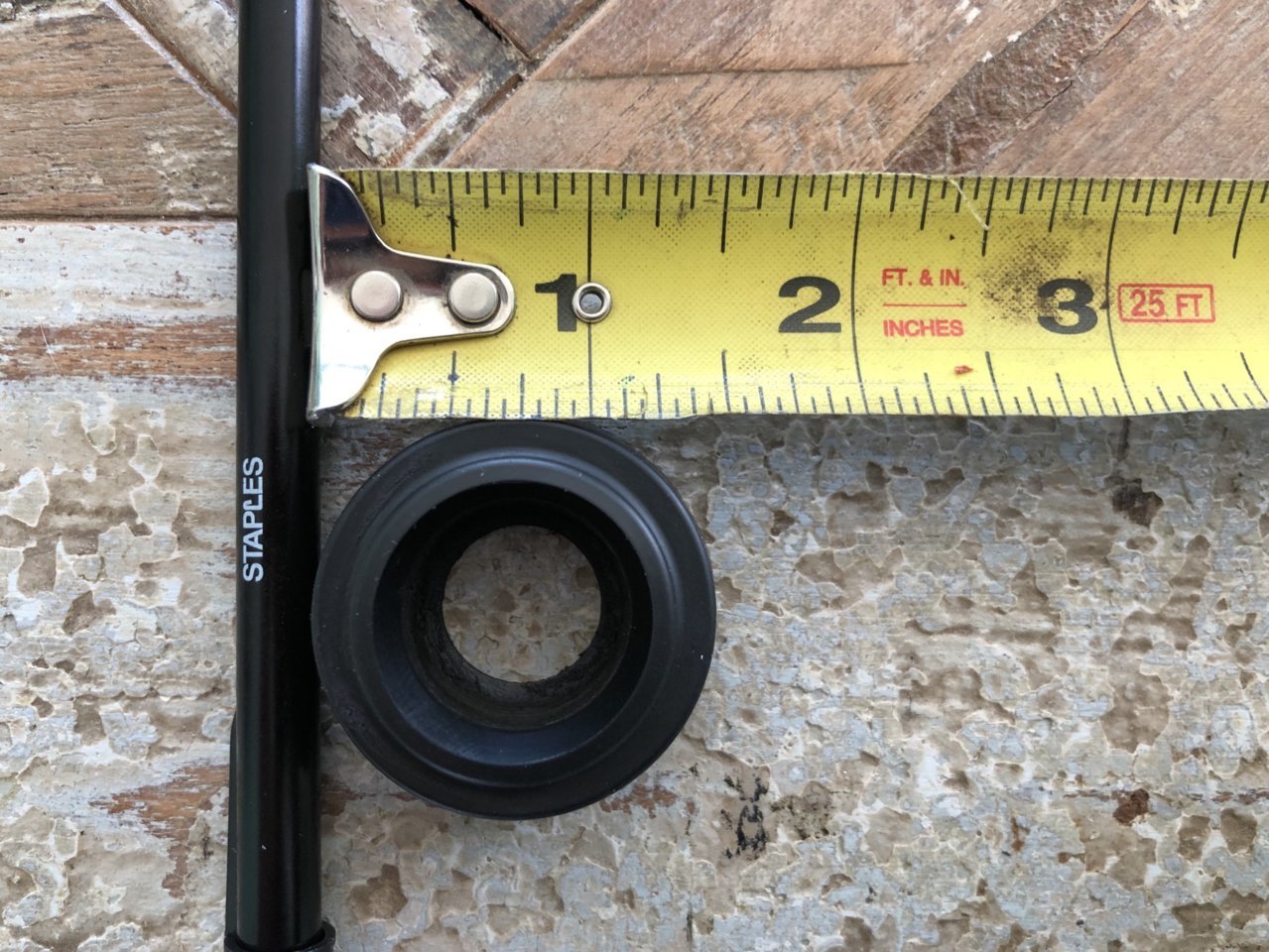

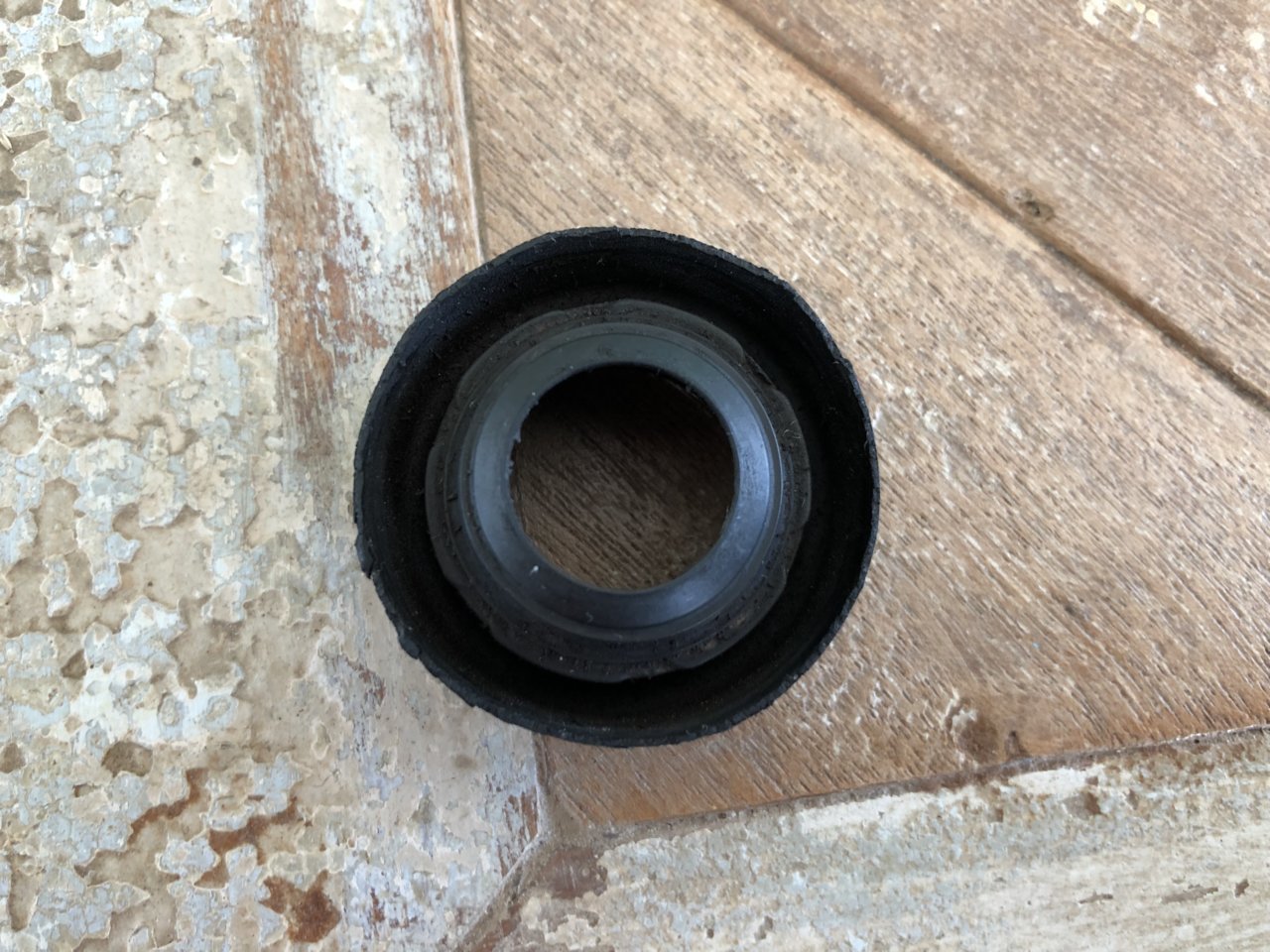

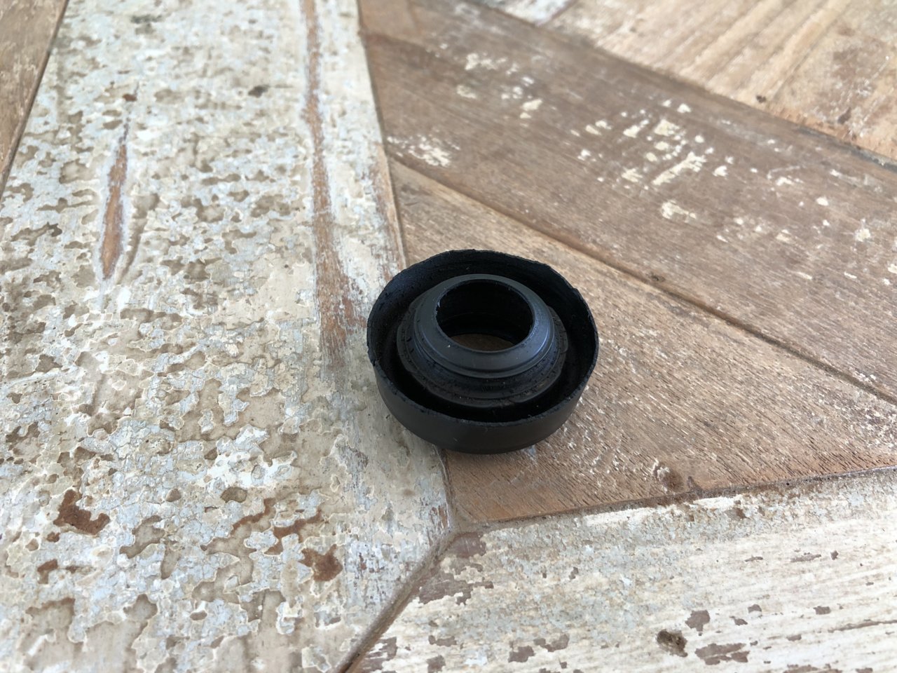

    We got a dusting of snow (1.5”) the other day. Not enough for me to drag the tractor out and plow. Frequently with storms like this, I’ll use my beater Subaru to just pack the snow down to try to keep a good base on the gravel driveway.
    Well, I was driving the truck today so I figured I’d use that before parking it. As I backed up, I saw this in my tire track on top of the snow. It was greasy, I cleaned it for better pics. I briefly looked under there, and am about to change and really crawl around under it, but maybe one of you guys or gals will be able to narrow my search.
    B263EB38-5C47-484B-B193-F9838A0B1B6B.jpg 0A845684-24D2-40CC-89D6-00B045B10D0F.jpg 56008598-604C-40F1-AC2C-838E3A0981A4.jpg 10D5C78D-6C1A-419E-9483-BD4F9DA3C2F5.jpg
  2. Feb 19, 2019 at 10:29 AM
    Unchained 5150
    Unchained 5150 Rick
    Sep 25, 2014
    #139054
    62,161
    Rick
    Auburn Ma
    Almost looks like the rubber boot that goes over the plug part of the headlight
  3. Feb 19, 2019 at 10:34 AM
    shaeff
    shaeff [OP] Well-Known Member
    May 22, 2016
    #187639
    295
    Hudson Valley, NY
    '07 DCSB SR5 6MT 4x4
    It’s pretty small, and no recent headlight work.
    There is also the potential that it came off one of the two Subarus we own, but I find that to be less likely given that it was on top of the snow, in my wheel track. I’ll check my wife’s car when she gets home. Thanks for the reply.A6DF59FF-8E48-4061-A5CD-8D4B58CDCAEE.jpg
  4. Feb 19, 2019 at 10:34 AM
    User Name01
    User Name01 Little boy from FairyTale Land
    Jul 15, 2013
    #108296
    6,358
    Bolbi Stroganovsky
    Port Arthur/Lubbock, Tx
    TRD Sport Barcelona Red Metallic Dbl Cab 4x4
    Thought the same thing.....I rememver it being a bit more brown though...might be wrong

  5. Feb 19, 2019 at 10:54 AM
    74cam
    74cam Automotive Engineer
    May 15, 2017
    #219075
    351
    Michigan
    2010 Tacoma TRD Sport 6spd
    TRD Supercharged, 3 inch lift, TRD beadlock wheels
    It looks like the base of a tie rod or ball joint boot? But I'm not sure how it would fall off like that without it being torn...
  6. Feb 19, 2019 at 10:57 AM
    iwashmycar
    iwashmycar a lot
    May 16, 2014
    #129960
    1,767
    Adam
    Lewis Center, Ohio
    07 FJ 4x4 AT
    33's | 3" | skids | rails | dent | CB | lights | dingus
    Does look like a ball joint boot

  7. Feb 19, 2019 at 11:01 AM
    shaeff
    May 22, 2016
    #187639
    295
    Hudson Valley, NY
    Wow, it sure does. I recently replaced the steering rack, not sure how I’d have put the ballpoint(s) back on with no boot. Definitely would have noticed. Maybe the alignment shop? I’ll go back out and have a look.

  9. Feb 19, 2019 at 11:07 AM
    iwashmycar
    iwashmycar a lot
    May 16, 2014
    #129960
    1,767
    Adam
    Lewis Center, Ohio
    07 FJ 4x4 AT
    Hmm, looking again, that area of the ball joint looks to be metal? Maybe just coincidence

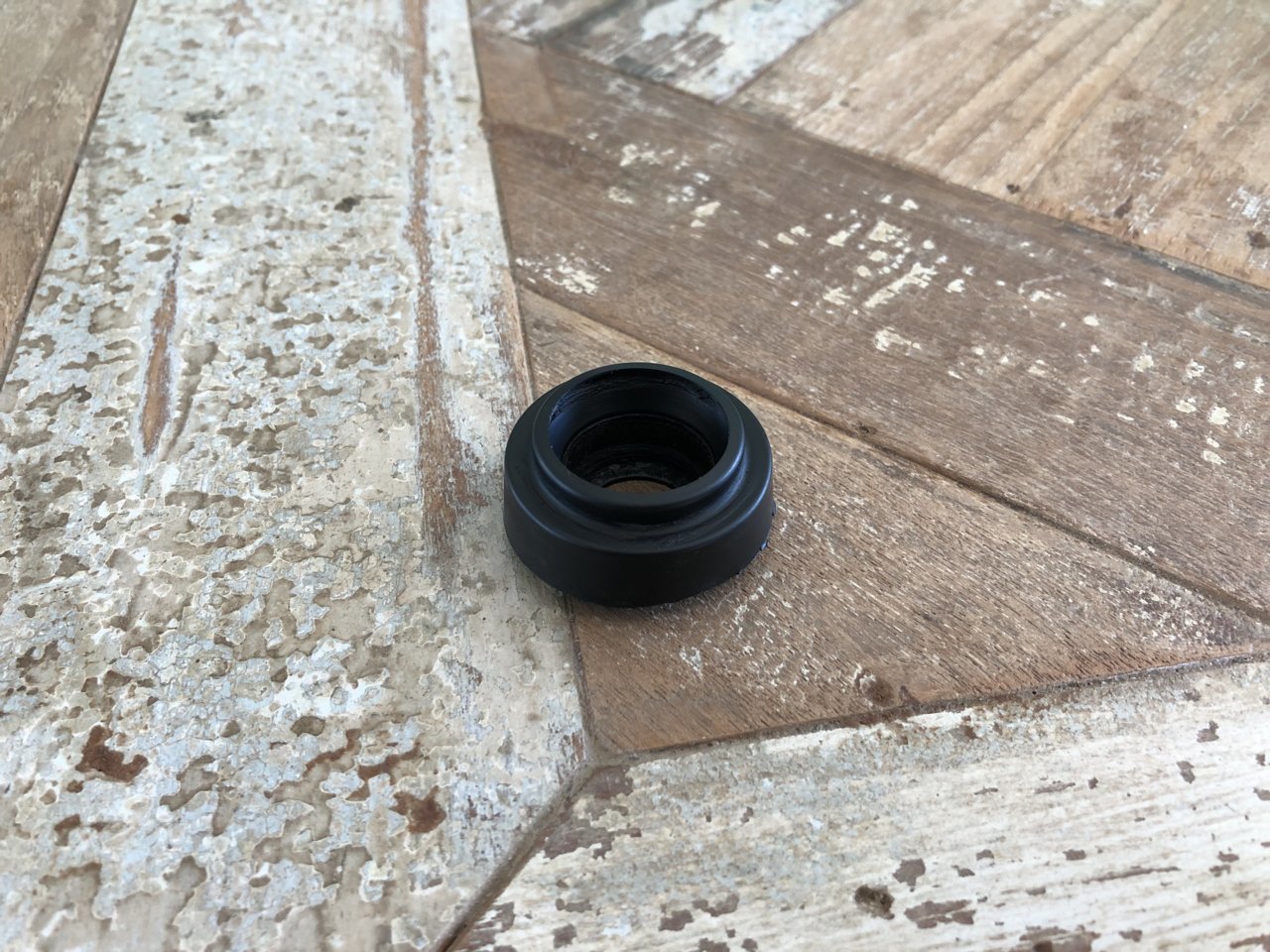

  10. Feb 19, 2019 at 11:12 AM
    shaeff
    May 22, 2016
    #187639
    295
    Hudson Valley, NY
    Well, although it looks like it, it’s not from the ball joints or tie rods on the truck. Not from headlights either. Still a mystery.

  11. Feb 19, 2019 at 12:01 PM
    iwashmycar
    iwashmycar a lot
    May 16, 2014
    #129960
    1,767
    Adam
    Lewis Center, Ohio
    07 FJ 4x4 AT
    Seal to a cap of some sort...brake fluid, power steering, clutch, ect?
    Seems just like the one in a brake fluid res cap.
  12. Feb 19, 2019 at 12:15 PM
    shaeff
    May 22, 2016
    #187639
    295
    Hudson Valley, NY
    Checked, all are in place. I’m starting to think it may be from my wife’s car. She won’t be home until late, so I’ll check within the next few days. I appreciate the suggestions!

  13. Feb 19, 2019 at 8:34 PM
    Jason J
    Jason J Well-Known Member
    Nov 14, 2014
    #142356
    181
    Jason
    oregon
    08 tacoma 4x4
    Did the new steering rack come with the rubber boots on each end of the rack? Is it possible that this is the torn end off of one of the old boots?
  14. Feb 20, 2019 at 8:24 AM
    lynlan1819
    lynlan1819 Well-Known Member
    Mar 14, 2016
    #181268
    5,288
    Troy
    Las Vegas
    2017 Pro/2015 Tacoma
    Lifted
    Didnt come off your truck.whatever it is for,it looks new.
  15. Feb 20, 2019 at 8:00 PM
    shaeff
    May 22, 2016
    #187639
    295
    Hudson Valley, NY
    New rack came with new boots, just had to put my TREs on, old boots were still in perfect shape so I don’t think so.
    Definitely not new, was covered in dirty grease. I cleaned it up, looks new but definitely isn’t.
    Our newest vehicle is my ‘07 Tacoma. I gotta look over my wife’s car. Possibly from that.
    Anyway, I really appreciate all the suggestions!
