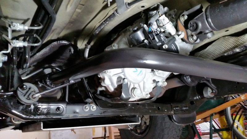

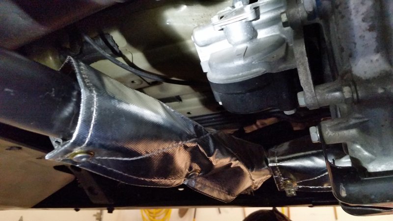

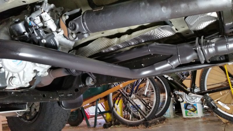

    I had the exhaust reroute done this Friday, and it turned out great. The crossover is now just under the trailing edge of my transfer case skid plate. I need to get under there tomorrow and removed the BS skid plate spacer that was needed for the factory crossover, and I'll try to grab some pictures then. Looks nearly identical to the OP's set-up. I have the heat shields coming from Amazon, and some POR-15 High Temp Coating on the way from Summit. I live in salt land, so I'm going to paint the old and new pipes from cats to muffler before putting on the heat shields. I think I'll chop the tailpipe and paint it too.
    One added benefit is that the interior drone associated with the TRD exhaust on my Baja has been dramatically reduced, I read another post somewhere that claimed this benefit, and now I can testify in the affirmative. It really did quiet the the system's lower frequencies down inside the cab. No idea how or why, but I'll take it. Sounds the same outside.

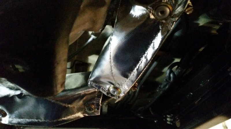

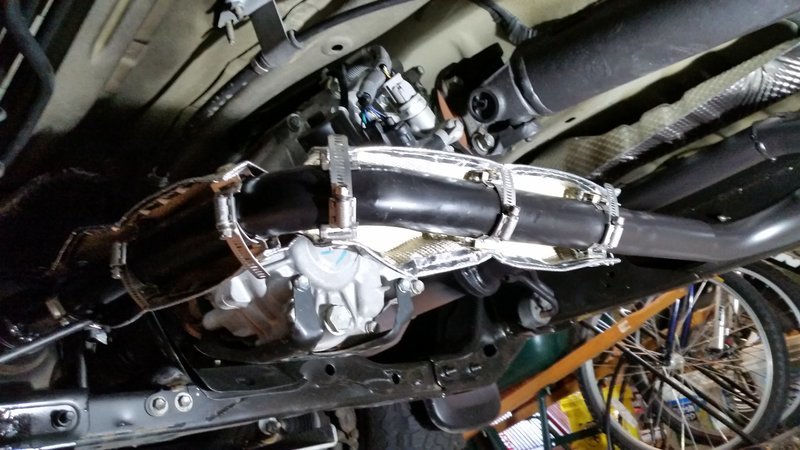

    Well, after almost 4 weeks of carrying around an extra 400 pounds, the springs have not settled at all. The only noticeable result was a loss of fuel economy. Without any ballast the truck still sits 2.5" higher than stock, and I get a driveshaft vibration that wasn't there before when starting from a stop. I tried an OME carrier bearing shim kit and considered keeping the extra height, but the vibes only go away when I load the truck and it goes down an inch. So I am removing the Wheeler's springs when I get a change. They offered to refund the purchase price, but i have to cover the shipping. Nice.
    Against the Diet Taco way of thinking, and in conflict with my desire to keep complexity low, I am now thinking of adding some Firestone Ride Rite air helper springs, Daystar cradles to preserve flex, and an on-board compressor so I can increase and decrease the cargo capacity of the truck as needed. My truck is my daily driver, so I need it to work under lots of different conditions loaded and unloaded. Anyone have any experience with these? There is a good thread about them here: https://www.tacomaworld.com/threads/official-firestone-riderite-lift-thread.279865/ What isn't discussed much is the compressors.
    Anyway, I finished my exhaust crossover relocation with some POR15 hi-temp coating and the OP recomended heat shields. Came together well, and i just need to get the transfer skid bolted back on. You win some and you lose some I guess...
