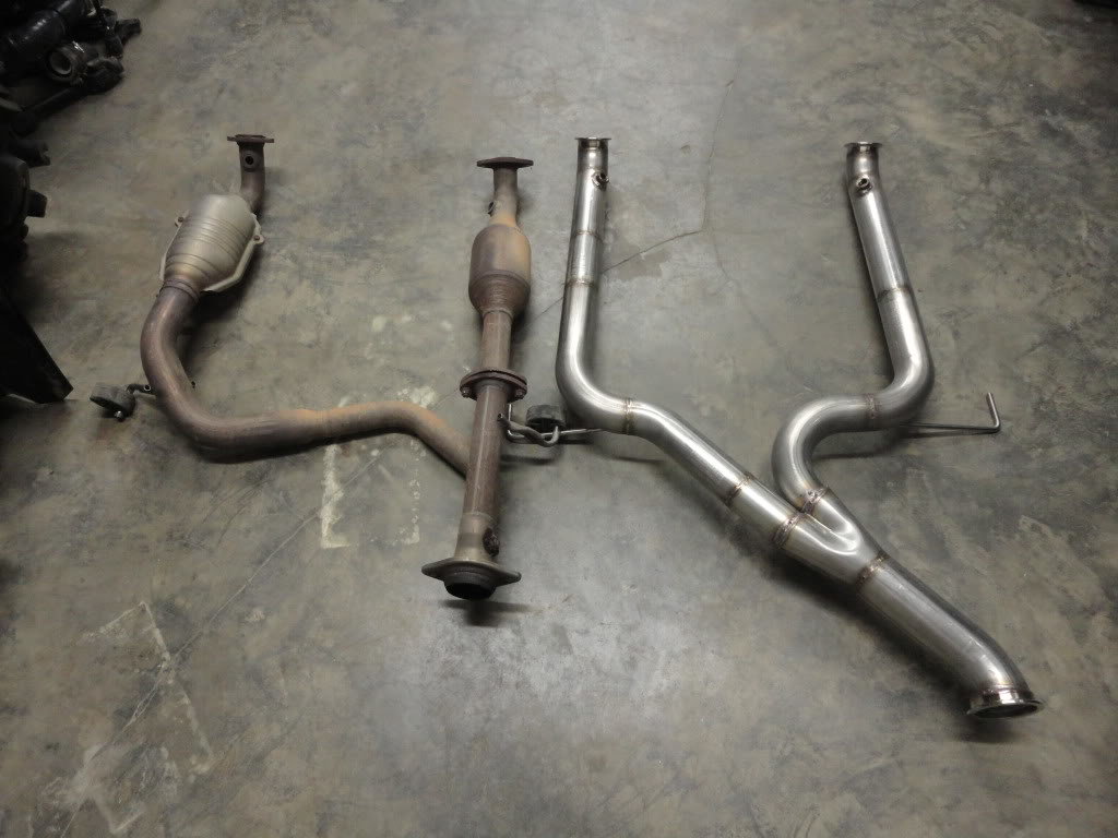

    Well, three of the welds on my exhaust relocation started leaking. That's what you get for going to a chain muffler shop. I took it back and they welded up the leaks, but I'm not happy with something so poorly done - fixed or otherwise. It was not well engineered, and I always assumed I would have to do it again in a few years. I originally tried to find a bolt on solution because a hate to have other people work on my truck - and now I remember why - but couldn't find anything that was emissions legal. All of the aftermarket y-pipes remove the rear cats. I currently live in Ohio, so that's not really an issue now, but I plan to have the truck much longer than this address. So, I just went to a hot rod shop in town to talk about having the relocation done correctly, and with stainless pipe. For the same money I can buy an aftermarket y-pipe and cat-back system, bolt them on, and then keep the old stuff for a temporary swap if I ever end up in a state that has inspections. I'm originally from Pittsburgh (Go Pens!) and it was normal for me and my friends to remove aftermarket exhaust annually for inspections, and then bolt it back on after getting the sticker. Not the easy solution that I was after, but I'm going back to bolt-on parts.
    So I have decided to go with a Doug Thorely Pipe Bomb y-pipe. It removes the rear cats and adds resonators, but because the O2 sensors are upstream of these, the computer won't care. From an environmental perspective I will still have the front cats in place, so I don't feel that guilty. The Pipe Bomb looks a little weird because it goes way back and around the transfer case, but it's the only one I could find that maintains my ground clearance, will work with my skid plates, and is an exact fit for the factory parts allowing the use of any cat-back system without fabrication or a loss of true bolt-on flexibility.

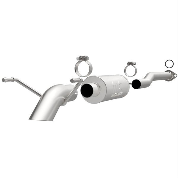

    To this I plan to add a MagnaFlow Off-Road Pro Series Turndown System. It's among the cheapest of the stainless cat-backs that I could find, and I was going to cut whatever I had off at the rear axle anyway to avoid getting the exhaust tip smashed up into the bed by a rock. Because the muffler shop shortened my factory TRD cat-back, I can't reuse it with the Pipe Bomb. It's now my spare for future inspection use.
    I don't know what this will end up sounding like, but I really don't care. I already have the TRD 2.5" cat-back system, so it can't get much worse. In addition to cost, the MagnaFlow system is preferable to me because it's also 2.5". Lots of other cat-backs are 3" (URD, FlowMaster, etc.), and seem to add more noise without any power gains on a naturally aspirated engine. Any hey...it's lighter, right?

    Update: The Pipe Bomb is not going to fit with the transfer case skid plate installed. In fact, there doesn't seem to be any aftermarket options that will work with skids, so I'm taking to a local racing fabrication shop about a custom stainless Y-pipe and simple turn-down exhaust system. I haven't had a detailed conversation with them yet, but I envision an equal-length y-pipe similar to the APR (see pic), but with a 2.5" collector instead of 3". It's a bit more involved than a simple crossover style y-pipe - and that's certainly still on the table - but if I have to go through trouble of getting something custom fabricated, I might a well get something cool and that might help performance a bit.
    I think that if the primary tubes were extended by a foot or so, the bends before the collector would be able to live just behind and above the rear edge of the skid - below the front half of the drive shaft. I would go with factory style flanges to connect to the manifolds, and utilize the factory hanger locations so that factory parts could be swapped back on in case I ever need to have an emissions inspection. Of course if they can weld in the rear cats, this shouldn't be an issue. As for the rest of the system, I'm thinking a v-band connection, a Magnaflow stainless muffler, and then a simple turn down in front of the axle.

    @PaulK - Good info! Keep us up to date as you build the ultimate skid plate exhaust!
