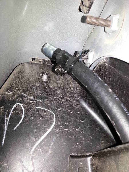

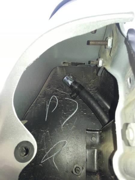

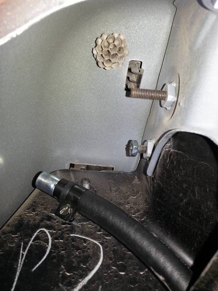

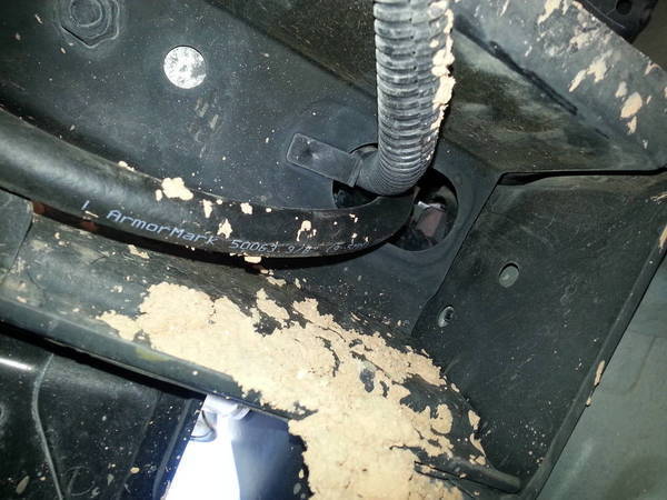

    I did it this weekend as well, but placed the breather inside the left tail light cavity...no drilling required. I ran the breather hose from the differential over the top of the spare tire mount then up into the tail light housing by following the wire harness. Be sure to leave some slack for movement. Then zip tied the hose to one of the bolts. Secured the hose at various point along the way.
    The hose going up into the tail light housing through the hole for the wiring harness

    The new breather location

    Wasp nest...I should have left it

    My only concern would be, that if you didn't need to drill any holes, it means the area is open and if you splash through puddles, if you splash when it's open, that you'll suck water in :notsure: Looks to me like water spots in that area :notsure:

    I'm not sure if they are water spots or not, but seems to be more secure than the engine bay for the front and overflowing gasoline could contaminate the gas cap position. I don't know of any absolutely secure place except for inside the cab.

    I also placed mine inside the space behind the tail light and up underneath the top rail of the bed. I'm fairly certain no water can get in that location. I moved it from the gas cap compartment because water was getting in there.
